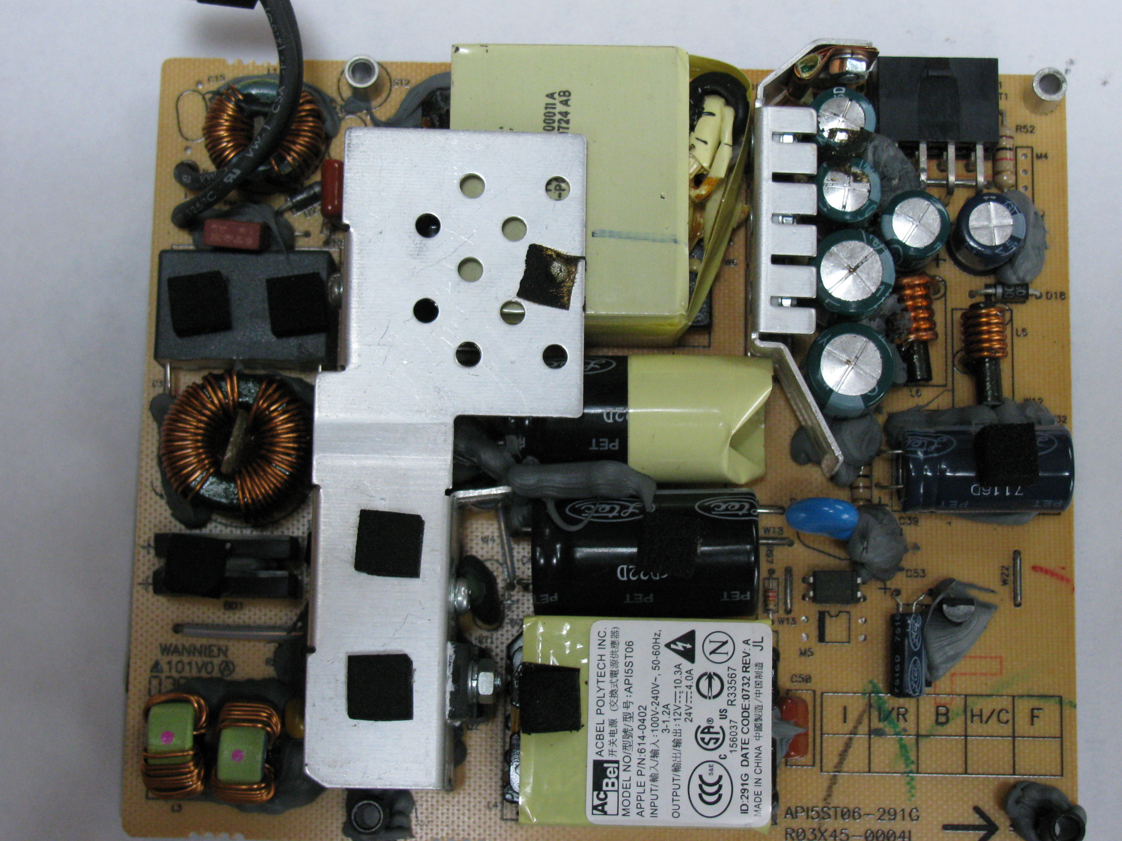

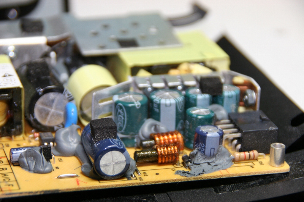

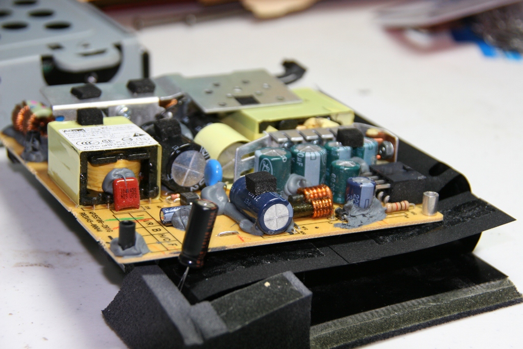

              pics of the PSU caps, sorry for the focus.
              • Toasty
                • Jul 2007
                • 4171
                Re: IMAC 24 PSU Bad Caps replacement
                KZJ doesn't surprise me. They were still being produced then. They're not a "plague" capacitor, just one that doesn't hold up well under heat. That observation was made by PCBONEZ several years ago, along with series KZG. The reason given was that they both use(d) the same electrolyte formula. Both series are deprecated now, so anything seen today would be older than 3 years, I would guess.
                An Acbel PSU, I see. Looks less complicated than the old iMac G5 ones.
                If you don't mind, would you please relate the AcBel API number (from the board) and the Apple part number (label)? I'm sure to start seeing these in the near future...
                BTW: The 1500/16 HZ cap is a bit of overkill...
                I LIKE IT!!!
                Toast
                veritas odium parit

                        Found this pic that looks just like mine.

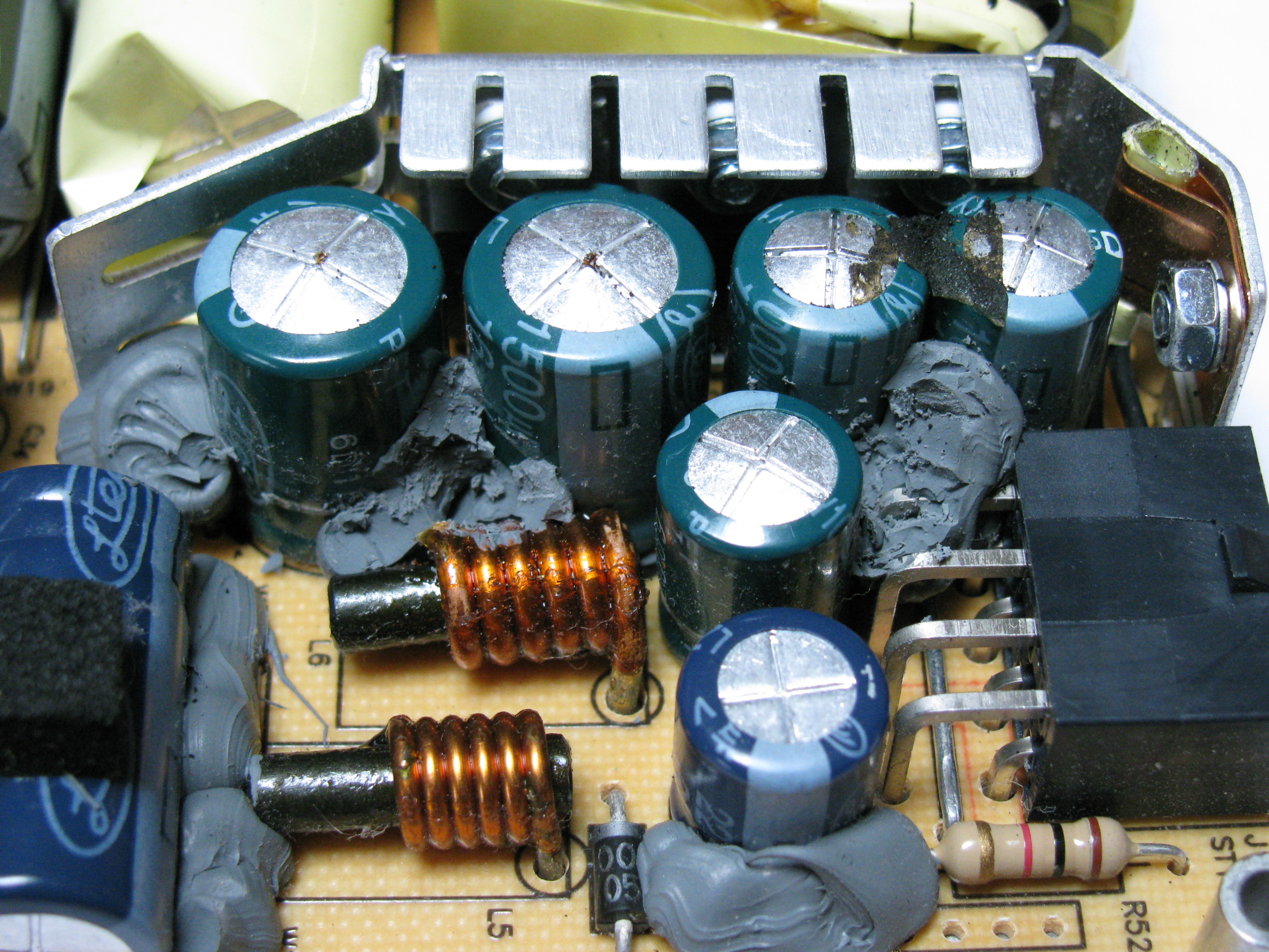

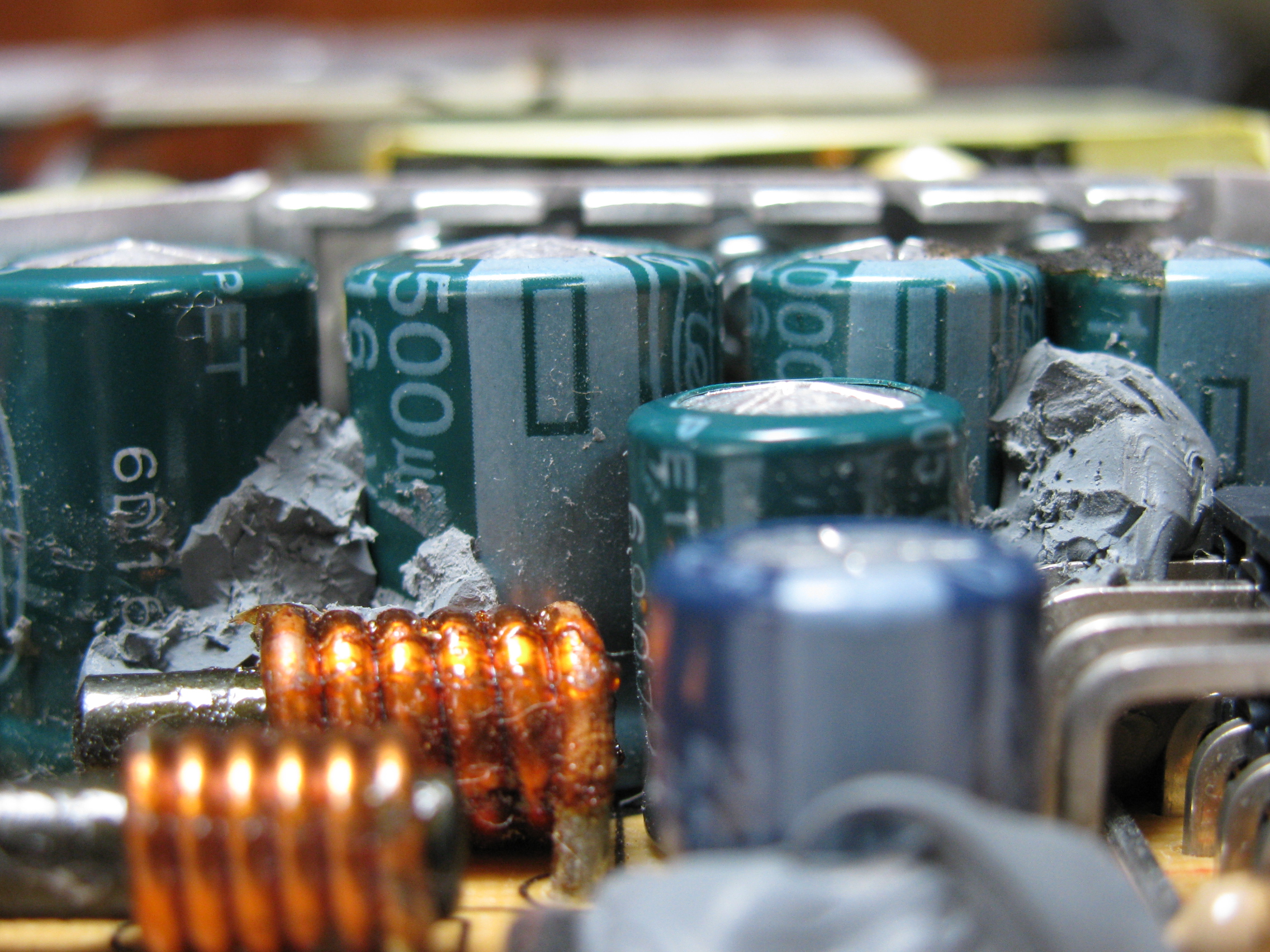

                                      I too am experiencing the same issue with my imac. When i plug in the power cord i hear a high pitch squeal coming from the power supply. The diagnose led lights only light on led #1. When i press the power button led #2 and #3 flash then everything shuts down, then no lights are present. I suspect that the power supply is the culprit. I have included pictures of the power supply. You can see the previously mentioned caps have bulges on top. You can also see on a couple of them some liquid type release on top (left 1500's) . The others have what remains of the foam pad that was present (right 1000's) i would like to know which ones i can order here, to replace them. I have done some soldering before and work on computers for a living however i have never replaced any capacitors before.
                                      I was hoping for some help with this in hopes to get it working again. Any instruction, advice would be appreciated.
                                      Thank you!
                                        • Jul 2011
                                        • 6058
                                        One
                                        uf on the cap..> 1500 uf
                                        Two
                                        voltage of the cap I can not see the voltage that marked on the cap from the photo
                                        Three
                                        size of the cap they look like they maybe...> 10 to 12 mm D X 20 to 25 mm H caps <... from the photo
                                        Four
                                        the series of the cap that you are going to use I would use one of the following...> FR, FC, FM, KY, KME
                                        You can get these cap at Mouser or Digi Key
                                        I hope this helps
