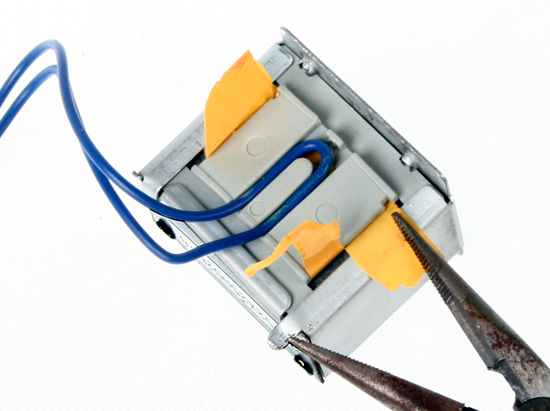

    Passive PFC - The HongKongFlyApart way
    IMO, this is just as bad (but funny) as kc8's echo star with dummy weights. It's from an "AOBAMA" branded unit, the OEM of which has to be HongKongFlyApart Company (R) LLC. Enjoy .

      epic fail... only other 2 dummy weight psu's mentioed on BCN:
      1. KC's echo star
      2. fake dell PA-10 (referenced from another forum)
      but at least those 2 did something, even though not performing up to spec. this, well, is 100% useless.

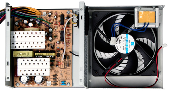

          I've never owned a PSU with an external choke like that. I've only seen them in PSUs designed for the European market.
          Some stricter regulations for suppressing line noise maybe?
          I knew that transformer was fake before you even opened it the external tape on the transformer was too far forward.
          Check this out for more details on this deceiving practice:

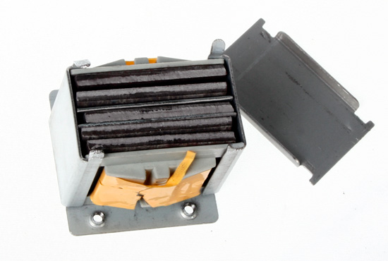

          The insides of an external choke on a cheap supply. Guess copper wasn't in the budget !
          http://*************/photo/my-images/160/img2319.jpg/
          Check these PSUs they're even worse:

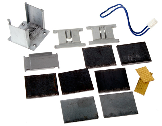

          They just jammed a few pieces of iron together into the bobbin to make it feel heavy enough to be real. Another manufacturer filled the bobbin with ground up iron filings and taped it up. Great way to get rid of manufacturing waste don't you think ? Another just glued the plastic bobbin to the underside of the PSU case without an E core and you guessed it more iron plates for weight. Some manufacturers have gone high tech and molded a solid piece of iron that fits into the bobbin instead of individual iron plates!
          All of course have a continuous loop of insulated dummy wire to make it look legit from the outside.
          http://www.cloudfrom.com:8080/showIt.../10680033.html
          Bad caps are bad enough but as consumers from other countries keep buying this disposable Chinese crap they get more and more ballsy like this. It pisses me off to no end!
          At least you can tell when you'll find these fake coils because they are usually accompanied by Hong Kong Flyapart (gutless wonder) built quality an undersized discrete line rectifier, undersized paper thin heatsinks, undersized switching and secondary rectification components, etc.

            The external coil is supposed to be for passive PFC which uses a large transformer like that.
            Since many markets require at least passive PFC now and all these people can seem to put together are the same 2 decade old designs; it seems they have started to fake PFC.

              I have plenty of passive PFC supplies here and all have onboard chokes not a single external one to be found.
              Still don't get why they're commonplace in Europe and not in the US.

                      Try every PSU I have here is a link to my Antec Smartpower:
                      Check out the third pic that's the input. A pretty common sight on a PSU that isn't a gutless wonder. An onboard choke and inductors only no external e coil choke.
                      https://www.badcaps.net/forum/showthread.php?t=4956
                      Check post 8 for another pic.
                      I've never seen one in any passive PFC supply I've opened.
                      I have seen them constantly in pics on supplies marketed for 220 volts though.
                      I'm thinking stricter regulations for line noise in the EU requires a bigger choke.

                        That choke you have there in your Antec isn't a passive PFC choke, it's just a component of the EMI filter.

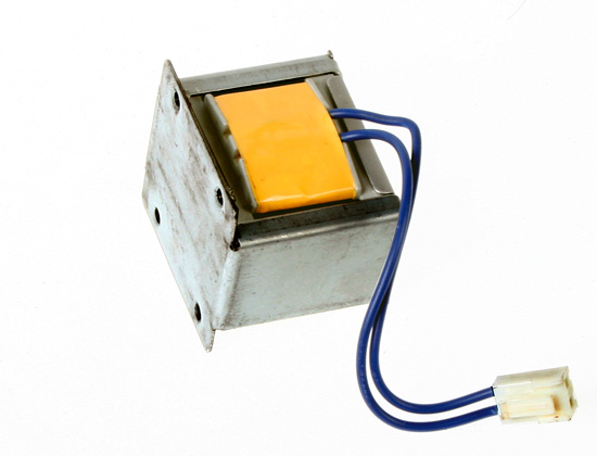

                            There's a header on the board for that blue wire, but is that header connected to anything?

                              I stand corrected that PSU doesn't have Passive PFC. That is the EMI filter .
                              I figured a mid range PSU that wasn't cheap mind you bought in 2006 would have it.
                                I don't see why the traces for the PFC choke wouldn't be there they have to sell the scam after all.
                                That blue wire enters the dummy PFC bobbin loops around and comes back out .
                                Just to trick the casual observer so it appears to meet the EU requirement and has some form of PFC.
                                One plug into a Kill A Watt set to the PFC function would expose it though.

                                  Re: Passive PFC - The HongKongFlyApart way
                                  No, I mean the header on the PC board. Is there any circuitry actually connected to that? Is it just not connected, or both pins tied to ground, or what?
