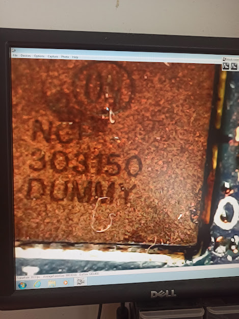

    Hello.
    I ordered two NCP303150 for Lenovo 15 for GPU power phases. When i installed it it not work and i see that they have markings DUMMY on it. it is really dummy/fake/ ? ordered from SUHMS

    Re: NCP power stage for Lenovo 15 - is it really dummy chip?
    i doubt it, has anything changed after replacing? i would contact the buyer and ask for this...

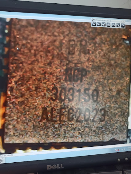

      I replaced chips from another board just for test and now everything works. so SUHMS selling fakes. and i was thinking it is best seller for chips
          this is awful. that was my one and only trustworthy chip seller...
            Just pinged the vendor. Waiting for his comments. Could be an honest mistake. Have not had any issues in the past with this vendor.
              SUHMS wrote me that marking is ok. 0 of 5 chips worked. NO refund
                Hmm. Are each of the ICs with 'DUMMY' marking? If yes, then I would have to conclude that they are blanks. Sometimes sold by SMT supply houses for training of the SMT equipment.
                  did you pay via paypal? if so: try to use the advantage of the buyer protection option.
                    Contact AliExpress and open a dispute.
