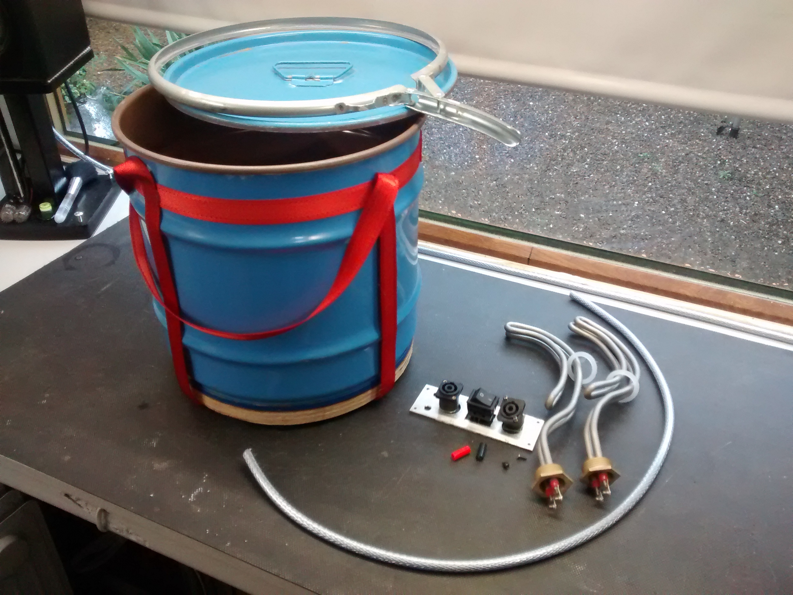

                                      • check12
                                        • Nov 2012
                                        • 103
                                        Re: Dummy loads for amplifier fault finding
                                        Here's a little something I put together for about £50 ... 2x 6kW 220v elements.
                                        https://www.aliexpress.com/item/3284...21ef1802cXZQmO
                                        A metal bin that I bought from local adverts and some suitable connectors and wire. Had to bend the elements a bit to fit in (pretty tough but they can be bent). I fitted them through opposing holes just below the bottom ridge on the metal bin (for the max amount of oil above them).
                                        Elements are almost exactly 8ohms, very little inductance.
                                        My son works parts time in a restaurant so we got 20L of used vegetable oil, filtered it and that is what cools the elements.
                                        Switchable 2x 8ohms, 1x 4ohms ... Been using it for ages now and had no problems. I can now properly stress test BIG amps without worrying about how hot the load was getting after a few seconds ....
