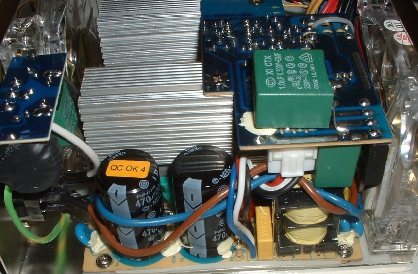

                        #191
                        Re: Power supply build quality pictorial DISCUSSION
                        I myself would never place a QC OK sticker on a Fuhjyyu cap...
                        Maybe if recapped it would be a nice PSU!
                        You know there's something wrong when you open your PC and it has vented Rubycons...
