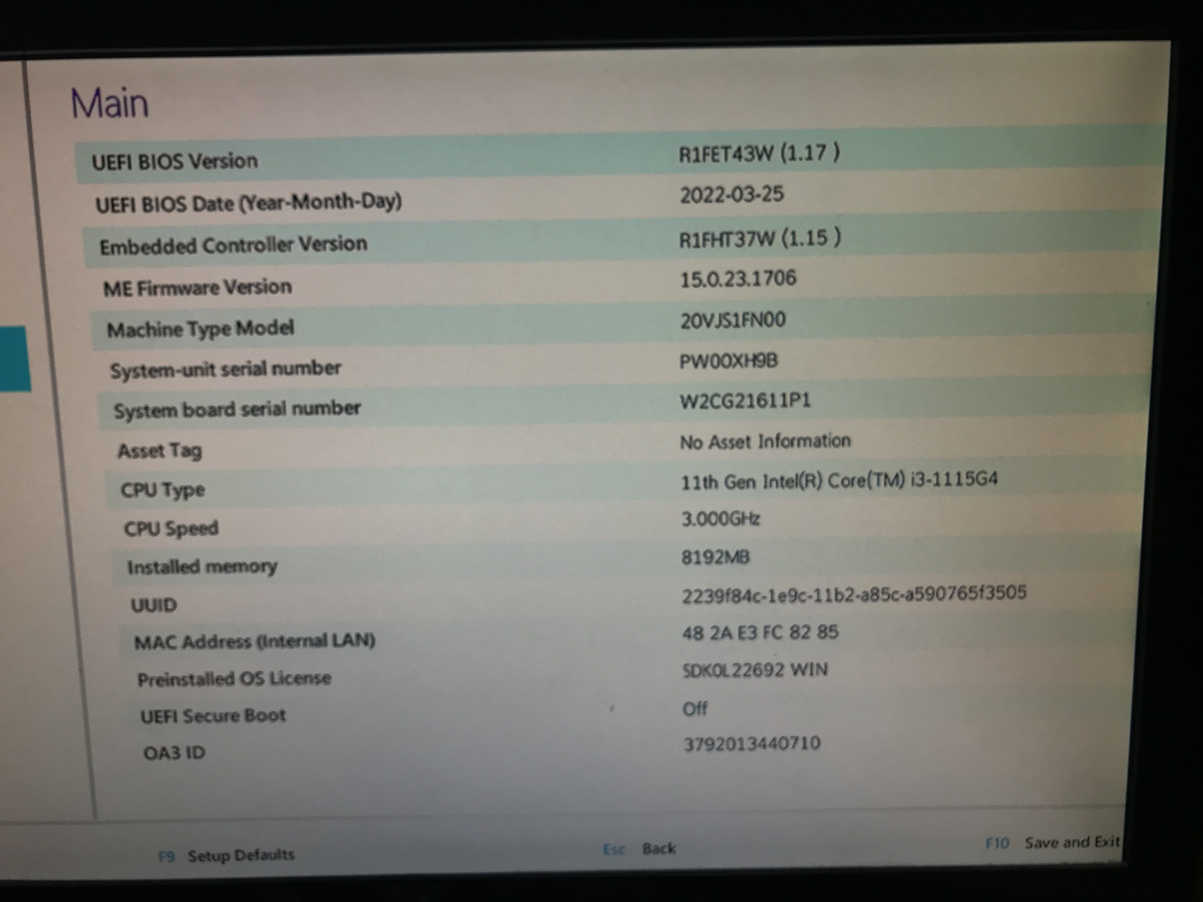

                  Lenovo Thinkpad L13 Yoga Gen2
                  I downloaded EC (npce68apa0dx) firmware from LAR-2 motherboard
                  but can't find an area to clear the supervisor's password.
                  Could you help me, please?
                  SN: PW-019C2H

                    try test
                    • vikrep
                      • Sep 2011
                      • 34
                      #30
                      Re: Lenovo Thinkpad L13 Yoga Gen2
                      try test
                      Thank you! It works.
                      The first time was an alarming sound and message Security CRC Bad but after BIOS defaulted became good.
                      The supervisor's password is gone.

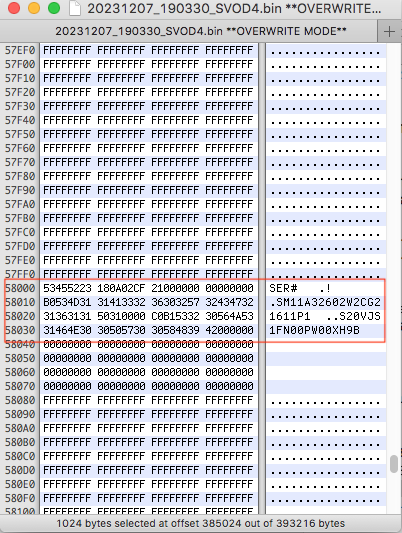

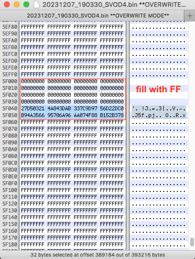

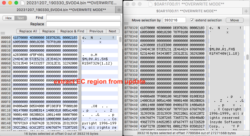

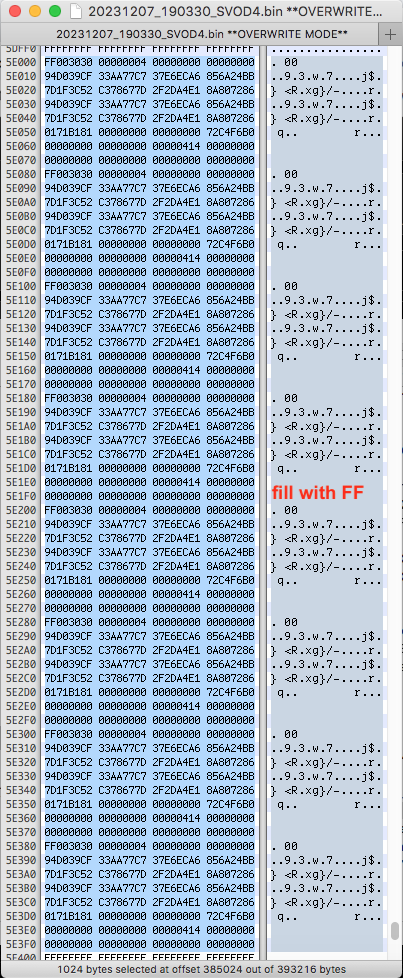

                      Unlock Lenovo L13 Gen 2 20VJ, LAR-2 MB, EC NPCE68BPA1DX with SVOD 4:
                      1. set programmer as in photo. Power up motherboard and hit "Read ID" . I got Device ID: 1F20E20F. After that hit " config NOVUTON" and chose 384K and check NPCE68xxx
                      2. Hit "Read" and save the result. you should get a 393.216 bytes file.
                      3. fill with FF sections 5E000-5E3FF and 5F000-5F05F. Save new file, open into programmer software and write it back into EC.
                      4. you can also extract EC region from update searching in .fl1 file for header of EC region ( in my case 61870000 4E000000 DE070201 00002103) and selecting from there 393.216 bytes but you'll have warnings about serial, machine, name, etc and you have to write them with LMU. Attention, 8S label from motherboard has nothing to do with data you have to write in B0, you can take 1S (C0) and 8S (B0) from EC dump at 58000 or search for text SER#

                                        Today I have to work with an Thinkpad L13 password remove situation.
                                        I followed exactly this volinakis guide and it's 90% accurate.
                                        I must write 00s on position 3. not FF because with FFs I got Error 2204 :System configuration data is invaid.
                                        Just an observation...
                                        Big thanks, volinakis!
