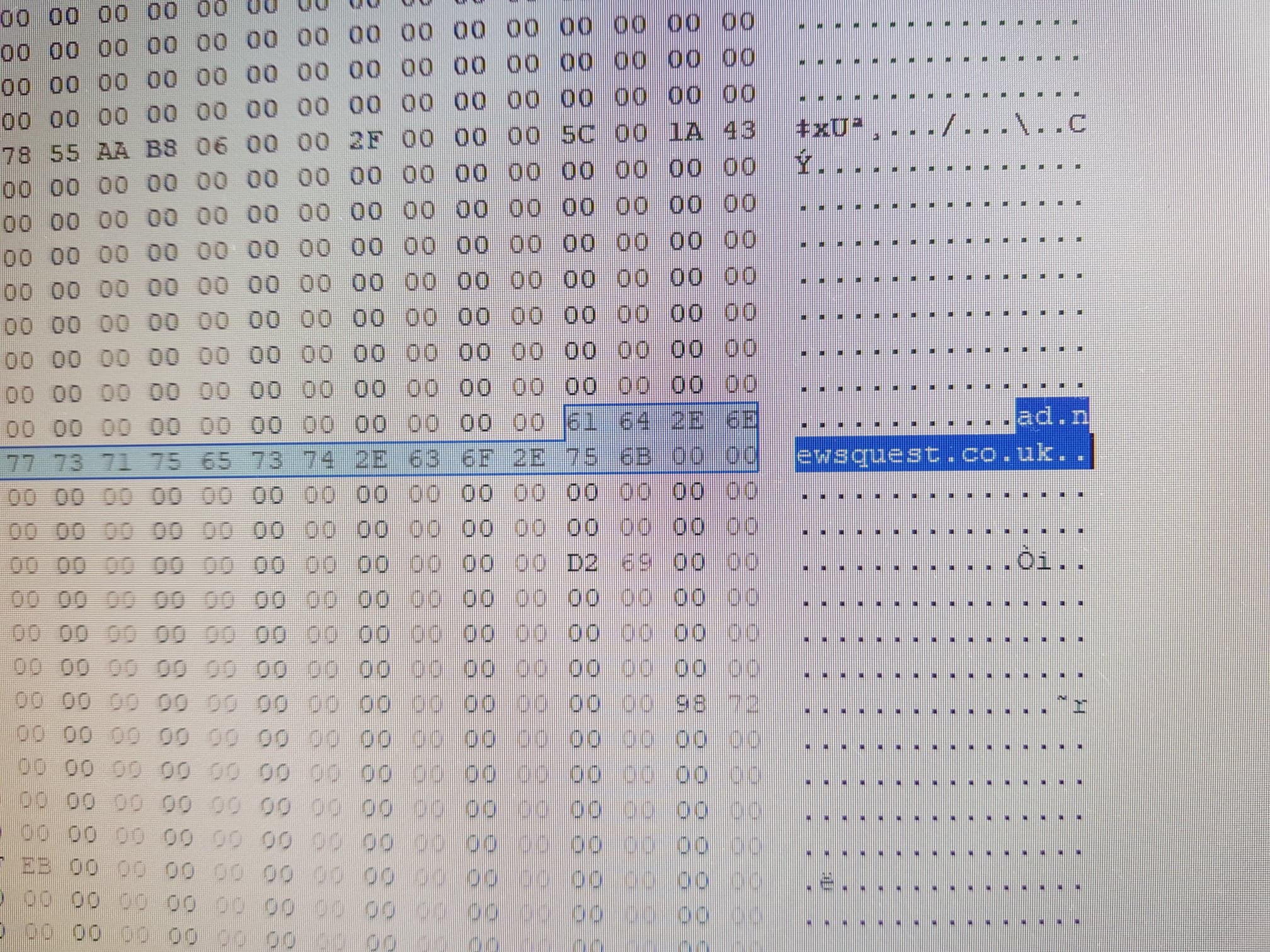

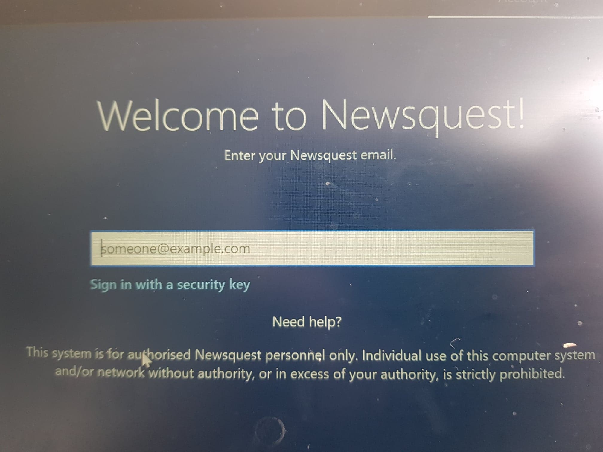

    I have a Dell E5470. I am trying to re install windows 10. I have wiped the partitions on hard drive and ran the setup. When i get to the network selection screen there is no option bypass where you normally see it down in bottom left of screen.
    When you connect to wifi it goes to a custom screen that requests logging into a specific user account on a server.
    It's not getting this info from the hard drive as it's wiped. I have read the bios file and attached.
    Searching the bios file in hex editor results in showing a reference to the company website in the bios bin file.
    I was hoping someone with the correct knowledge can remoce what ever it is thats causing it to force windows install down this path instead of a normal install.

                • RethoricalCheese
                  • Mar 2013
                  • 1517
                  • Estonia
                  Re: Dell E5470 custom bios issue
                  Read about Windows autopilot.
                  And then install either Windows home or Linux
                  Your bios is not custom, don't waste time on that
                    Hi Rethorical
                    Never used Autopilot, but have installed windows on lots of systems and never seen this issue before. So it's stumped me. See attached screen shots showing the windows installer screen that it lands on during install after i select keyboard layout etc...
                    There is no option to create a local account and the "I dont have internet" option is also missing from the account screen.
                    It cant be getting the company name from the hard drive because it's been cleaned with diskpart prior to install.
                    That led me to suspect the bios. So i dumped the bios file and searched for the same company name inside the bin file and found the company name located in the bin file.
                    I can't find anything online about this so was hoping it could simply be cleaned from the bios file to allow me to do a standard windows install
                    Thanks again for your reply, and further advice welcome

                        Any thoughts on the bios containing this company name which is the same name as th login its trying to use at first log in on clean install ?
                          • 20666
                          Originally posted by Calgacus
                          Hi M8
                          yes, i have been using the clip. not had any issues with it before, but obviously its not working if even the latest read is corrupt. It verified 3 times though.
                          I will now de solder the chip and read it that way
                          Thanks for your input
                          appreciated.
                          As far as i can tell its just part of a domain ,AMT settings are where its stored. I asked you for your service tag, with that we can look at your laptop configuration. Depending on the configuration you can use another dump with clean ME firmware
                                  I would erase the code from the bios dump and see what happens, just out of curiosity

                                  • RethoricalCheese
                                    • Mar 2013
                                    • 1517
                                    • Estonia
                                    Things I have done to try to remove autopilot, the exact same thing you have right now (on lenovo).
                                    New me + main bios, new SN and motherboard SN, new network mac, new windows installer and maybe something else. Nothing helped. Only thing I did not do, which might help, was to replace TPM chip.
                                    As I said, install windows HOME not PRO. In that case, windows will not check if autopilot is installed because autopilot is not a part of windows home.
                                    But if you do find a solution for this, I am all ears. Keeping clear from PRO is just a workaround sadly.
                                    Autopilot is quite a recent thing. It was first implemented last year I think. And first autopilot laptops ended up in my hand at the end of last year I think. And some companies do unenroll from autopilot but others either forget or are too lazy to do it. Sadly microsoft has not implemented any way to unenroll for 3rd party users.
