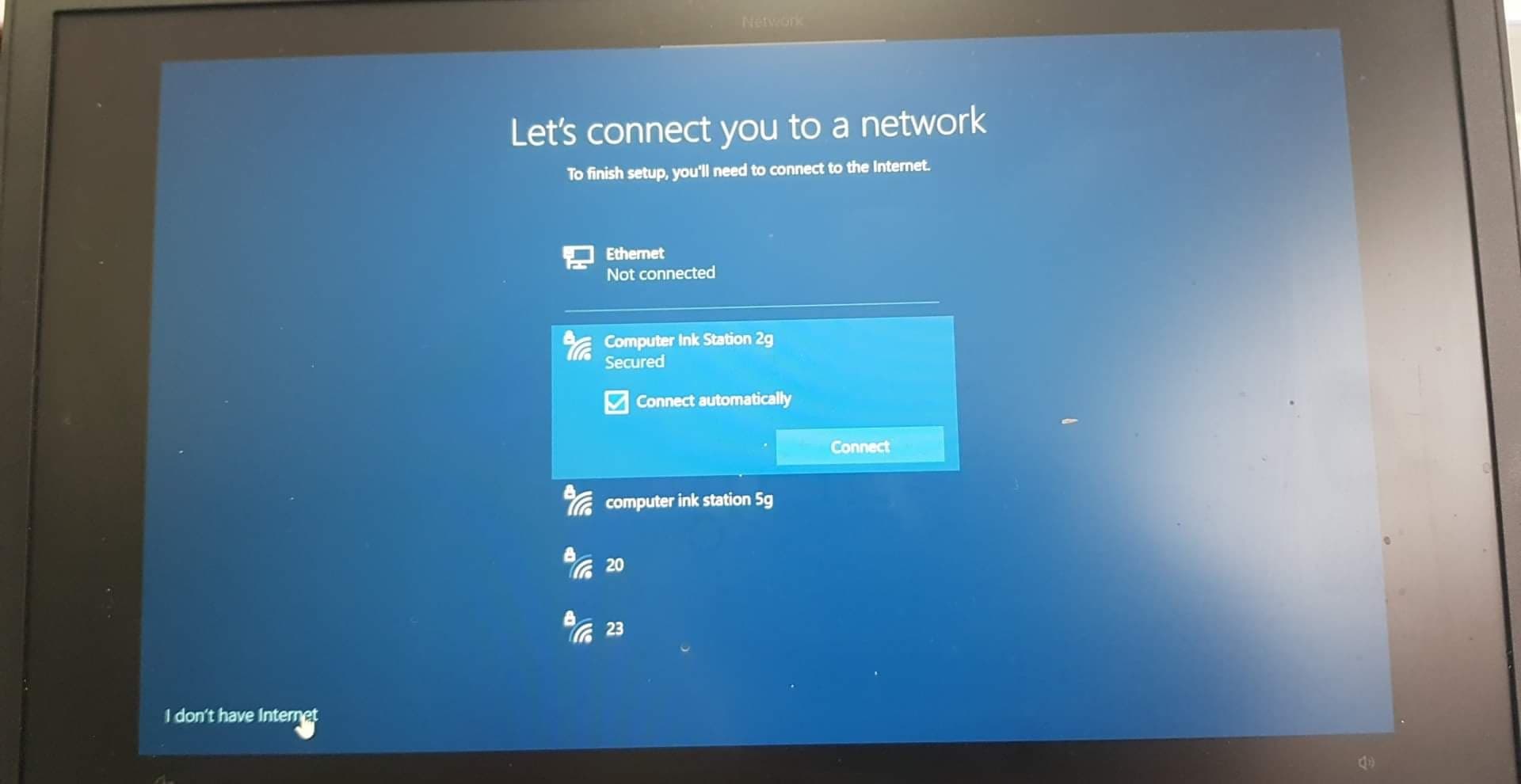

        Update: Installing windows 10 home did not make any difference, still forcing connection to the server.

          new bios.
          If it doesn`t work you can force the PCH to accept the new ME firmware settings by running flash programming tool from the command line
          FPTW64.exe -greset

            I had just finished flashing the first bios file you uploaded SMDFlea, and it worked fine
            IT now allows me to select "I dont have Internet", and setup with a normal local account
            I can also access the bios without issue
            Is there any need to reflash with todays updated bios file
            or am i good to leave as is ?

              Leave it as-is now its AOK .I thought you had tried the bios i previously posted and it wasn`t working.
                Re: Dell E5470 custom bios issue
                Hi m8, no i wanted to confirm if installing windows 10 home would bypass the server issue first, just for future reference and knowledge. But tha gave same result
                I then flashed the bios and it worked first time
                Thanks so much for your input guys..very much appreciated, hoping to learn a bit more about the subject so i can possibly contribute. Any guidance welcome
