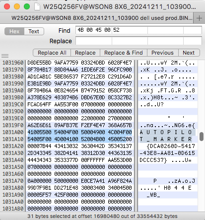

                          Hello Badcaps friends,
                          I have an Dell Latitude 3340 2-in-1 here with Windows autopilot. Is there yet a way to get rid of this? It's quite a recent model and I can't find any dump.
                          s/n: 3FMNN54
                          • volinakis
                            • Jan 2021
                            • 2874
                            • N/A
                            #33
                            s/n: 3FMNN54
                            try
Name:	Screen Shot 2024-12-11 at 12.25.53.png

                              #34
                              Awesome! Will get back to you with the results.
                              • volinakis
                                • Jan 2021
                                • 2874
                                • N/A
                                #35
                                you have to reinstall windows

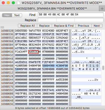

                                • dutchgaucho
                                  • Jan 2013
                                  • 65
                                  • The Netherlands
                                  #36
                                  It's clear to me why you are a Badcaps Legend!! It works man! Many thanks! You basically just have to remove the key string below the autopilot marker right?
                                  • volinakis
                                    • Jan 2021
                                    • 2874
                                    • N/A
                                    #37
                                    and invalidate it, see photo. You are welcome.
Name:	Screen Shot 2024-12-12 at 14.47.31.png

                                        This removed the autopilot from my Surface 3, which has given me trouble all week. I thought I needed the EC cleaned.
                                        This solved the issue.
                                        The touchscreen still works, same serial number. Windows activates, everything works as it should!
                                        I can't tell you how relieved I am. I had 3 of these to deal with.
                                        Many Thanks!

                                          #40
                                          Hello, pls what do you mean by invalidate it?
