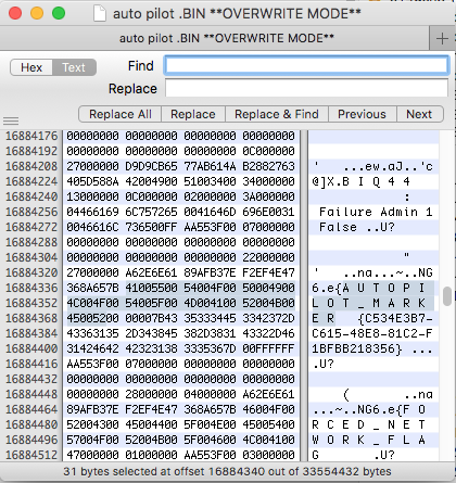

    Originally posted by Udemzy
    Hello, pls what do you mean by invalidate it?
    change AA553F to AA553C above Autopilot, see post 33
    • Udemzy
      • May 2017
      • 164
      • Guatemala
      #42
      I did exactly that and laptop refuse to power on after returning back the file, I had return back the back up file.
      I select the windows key and auto fill with 00 via hex editor and change the (?) to (<)
      Save and reprogram, laptop did not turn on.
      Change only the AA553F to AA553C alone, without touching the windows key.
      Same thing, I'll post the backup file, maybe you can help me with it.
        from where did you understand that you have to change "windows key"? Read again posts, maybe you'll realise what you are doing wrong.

            #45
            Please which app do you in opening the file?
            I'm using hex editor but I can't see the auto pilot.
              Hello, pls can you help me remove the auto pilot in this file.
              ​​​​​I tried using the method in post #33 but I didn't get it.
                follow rules of this forum and post laptop model and serial. I am using an hex editor for mac, is similar with HxD, AUTO_PILOT is there in your bios dump ... Click image for larger version
Name:	Screen Shot 2025-01-23 at 05.14.33.png
                  Thank you for your time and patient, I had to change the text string to unicode before I can locate it.
                    and yet you didn't follow the rules of this forum ... next time I won't help you.
                      Sorry about that,I moved the file to my phone and uploaded here when I got home, I wasn't with the laptop when i made the post.
                      When I got to the office the next day I was able to figure it out, that's why I didn't post it again.
