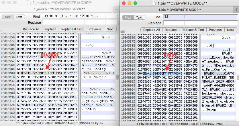

    However you call it, I meant "unlock" because it won't let me go trough win11 setup because of autopilot. Seriously, you didn't understand?
    Anyway, your file didn't work because company logo is still in fresh win 11. Let's finish this useless discussion
    • volinakis
      • Jan 2021
      • 2874
      • N/A
      #62
      Seriously, "unlock" is something else than removing Autopilot, you are welcome! So ... you didn't figure out yet that you have to reinstall win after bios modification, because marker is already in registry keys? And choose "I don't have internet" when you setup account? Seriously?
      • Mekong500
        • Oct 2024
        • 22
        • Poland
        #63
        I've programmed the chip, soldered it back, erased the drive, insalled fresh OS and it's still the same as before, what means autopilot was not removed
        • volinakis
          • Jan 2021
          • 2874
          • N/A
          #64
          sure, your pc is special, one of a kind! It takes the marker from thin air even is deleted in bios ...
          • Mekong500
            • Oct 2024
            • 22
            • Poland
            #65
            Believe me or not, it added third autopilot_marker and now are three, two invalid and one valid. There is no reason to lie.
            I read the chip after trying new BIOS file, reinstalling OS etc, it's ss of the new BIOS bin file in UEFITool
            • volinakis
              • Jan 2021
              • 2874
              • N/A
              #66
              post bios backup.

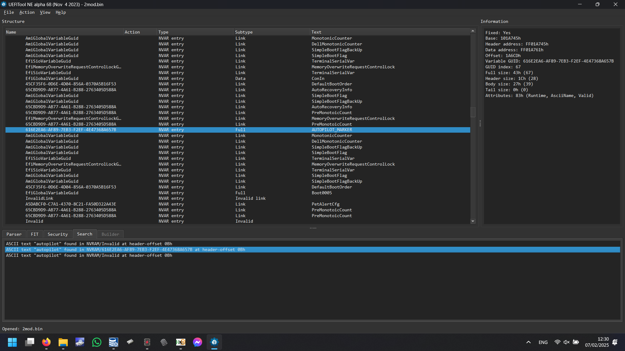

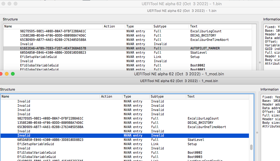

                            I explained how it works in this thread. It's simple to open bios with UEFITool and see how it can be invalidated an entry, depends by bios platform.
                            Click image for larger version Name:	Screen Shot 2025-02-06 at 21.41.40.png Views:	0 Size:	104.9 KB ID:	3565962
                            Click image for larger version Name:	Screen Shot 2025-02-06 at 21.39.11.png Views:	3 Size:	130.8 KB ID:	3565960
                            this change doesn't make any change in Autopilot, in HxD show invalid but after fresh installation autopilot again appear. even when I change those bit to 13 13 also HxD shows is invalid. I am confuse what change should we make to bypass autopilot in this kind of bios bi. I appreciate volinakis guide for different platform of bios that need just change 3f to 3c. that on work for me on several bios bin
