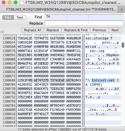

      Originally posted by Lucy Pulla
      Try this and let me know.
      try again... Click image for larger version
Name:	Screen Shot 2025-08-26 at 11.07.11.png

          #104
          Is that mandatory to remove the name?
          not just the name, also the certificate.
          please support this forum

            #105
            Oh ok ok... so is there any keyword or offset for find the certificate in bios?

                #107
                Could you please explain this further?
                replace bios region extracted from update and do a clean ME. Then transfer DMI

                  #108
                  Great.. thank you. One more thing how did you found the certificate?

                                        #119
                                        follow rules of this forum and post laptop model and serial. I am using an hex editor for mac, is similar with HxD, AUTO_PILOT is there in your bios dump ... Click image for larger version  Name:	Screen Shot 2025-01-23 at 05.14.33.png Views:	510 Size:	47.9 KB ID:	3554811
                                        But if you perform a bios update after? wil autopilot still be gone? i did exactly what you said and its gone the autopilot... but in windows it performed now firmware update thats why im asking

                                          #120
                                          as I explained before, extract bios region and ME firmware from update and with Intel FIT create a clean image if you want to get rid of autopilot. Erasing key and invalidating the entry will allow you to create an offline account while installing a fresh copy of windows. ( option "i don't have internet"). You have to reinstall windows again after modifying bios.
