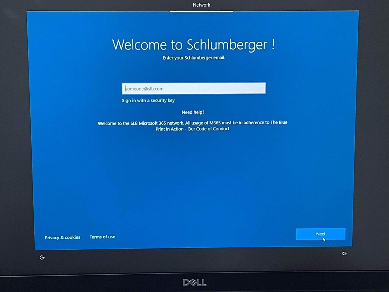

    Hello ,
    Any one come across this logon screen error while installing windows
    Popularly know as “Microsoft autopilot”
    How can this be by passed as this take many information from the laptop
    Like serial , mac , ssd , sku etc ..

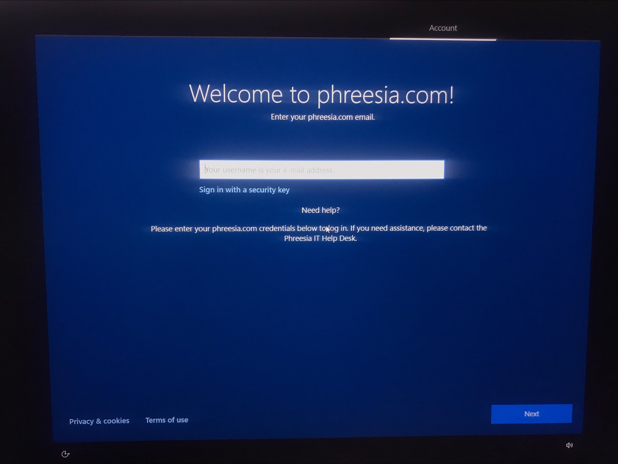

    Same issue. Did you try to change the service tag?

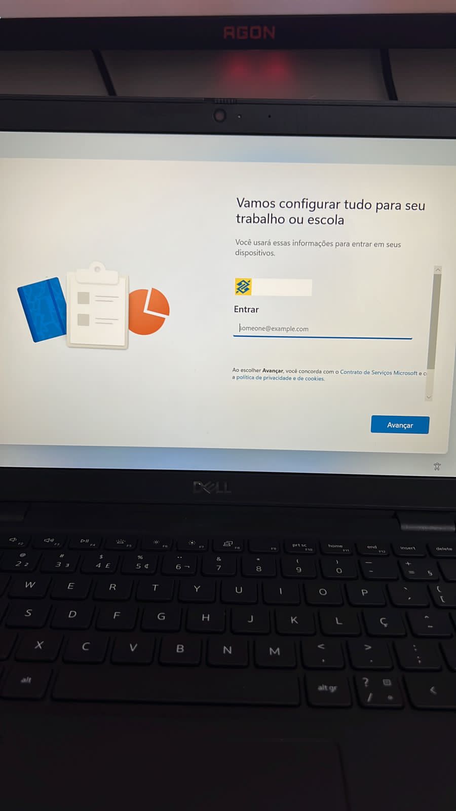

                some one can help me Dell xps 9510 Dell Microsoft autopilot

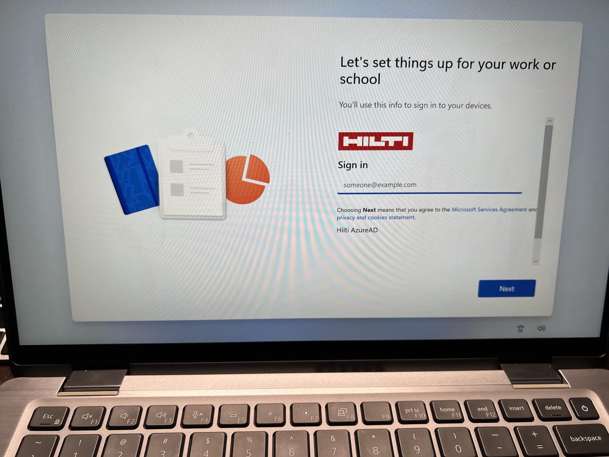

                                      Please help me to get rid of this popup
