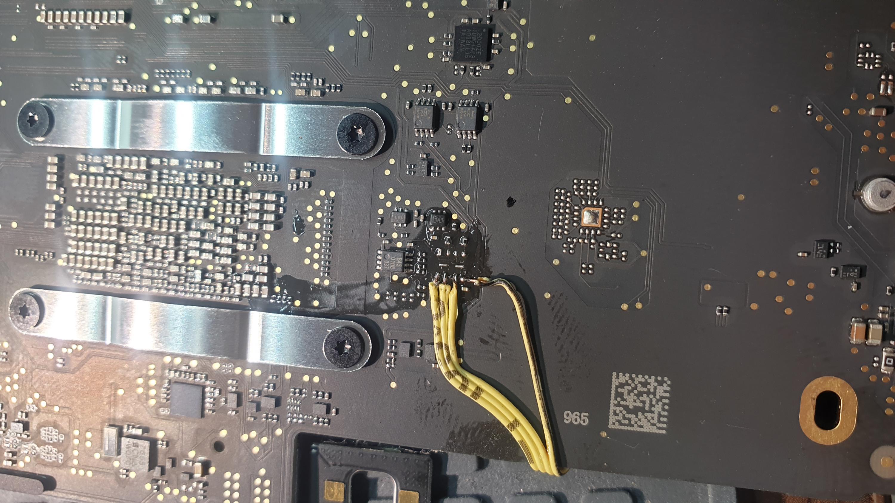

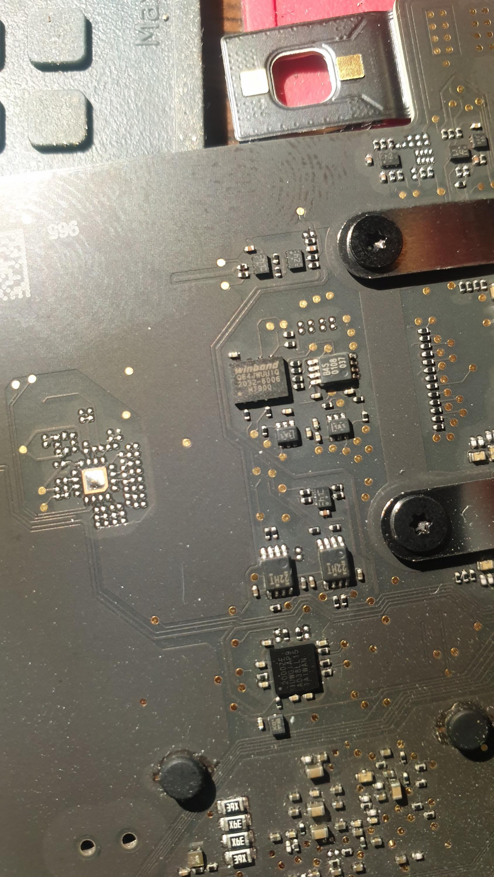

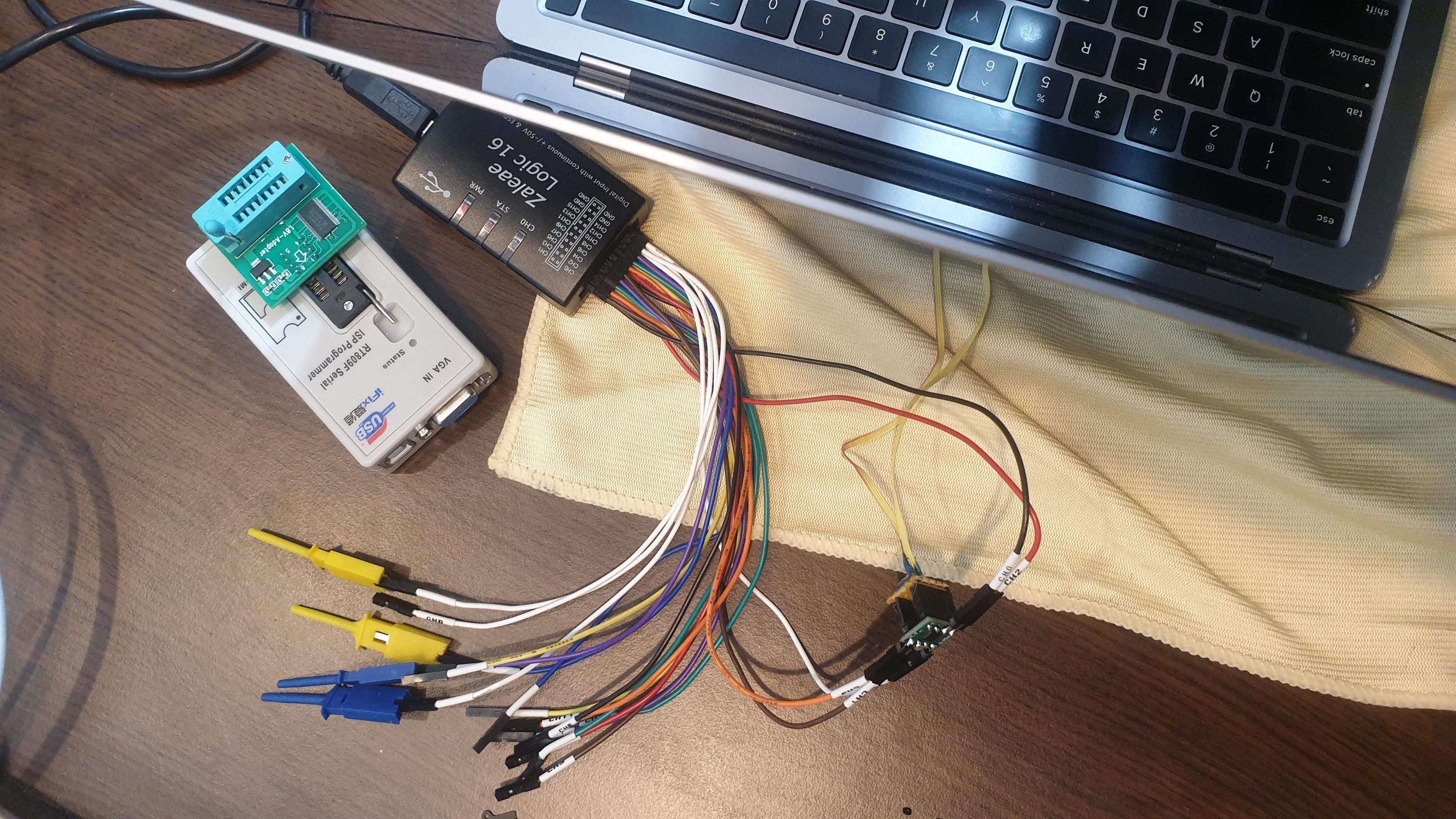

    Here we try to figure out a way to bypass activation lock (FMM) and password lock. Until now there is no method available, but we're working to figure it out.
    What we know so far:
    1. There is a W25Q64 8Mb 3x4mm wson8 chip on the back of the board with part of NVRAM ( some strings can be seen in its dump, eg: iBoot-6723.50.2, boot-args=.nonce-seeds=, luetoothInternalControllerInfo= bt mac, InstallPhase -> Boot 1 ) but no serial number in clear.
    Other strings: Apple Secure Boot Root CA - G21.0, AppleStorageProcessorANS2-1161.40.21~221
    2. Some suggest SN might be stored in ssd first nand, on hidden partition, some say it is tied to M1 processor itself ( which I doubt ).
    3. Checkra1n / MinaTool / CheckM8 solution does not work on these devices, as there is newer iBoot version (T2 bios chip is just 4Mb vs M1 8Mb). An idea would be to downgrade iBoot so can be accessed on ssh. Good dump would be required here, maybe there are older versions we can use.
    4. I have discovered a way to browse with safari if you boot into diagnostics mode ( hold on power until startup option is shown then press and hold Command-D, let it finish checking then click on find out more ), but from here you can't run any app, even if you can see it on usb mass storage attached. You can also download app but couldn't find a way to run it.
    5. Now I have W25Q64 outside of locked macbook, wired to the board with long cable, so tests can be performed easier.
    If you have dumps for 13"/14"/15" ( locked /unlocked ) please share them here for testing and comparation. Dump with secureboot disabled might help.
    6. Other way around can be writing SN from locked M1 into unlocked T2 mac, register it to mdm/icloud then get code. Looking for volunteers.
    Once we find out more interesting things will edit this first post to keep it simple. There is no doubt we'll find solution soon.

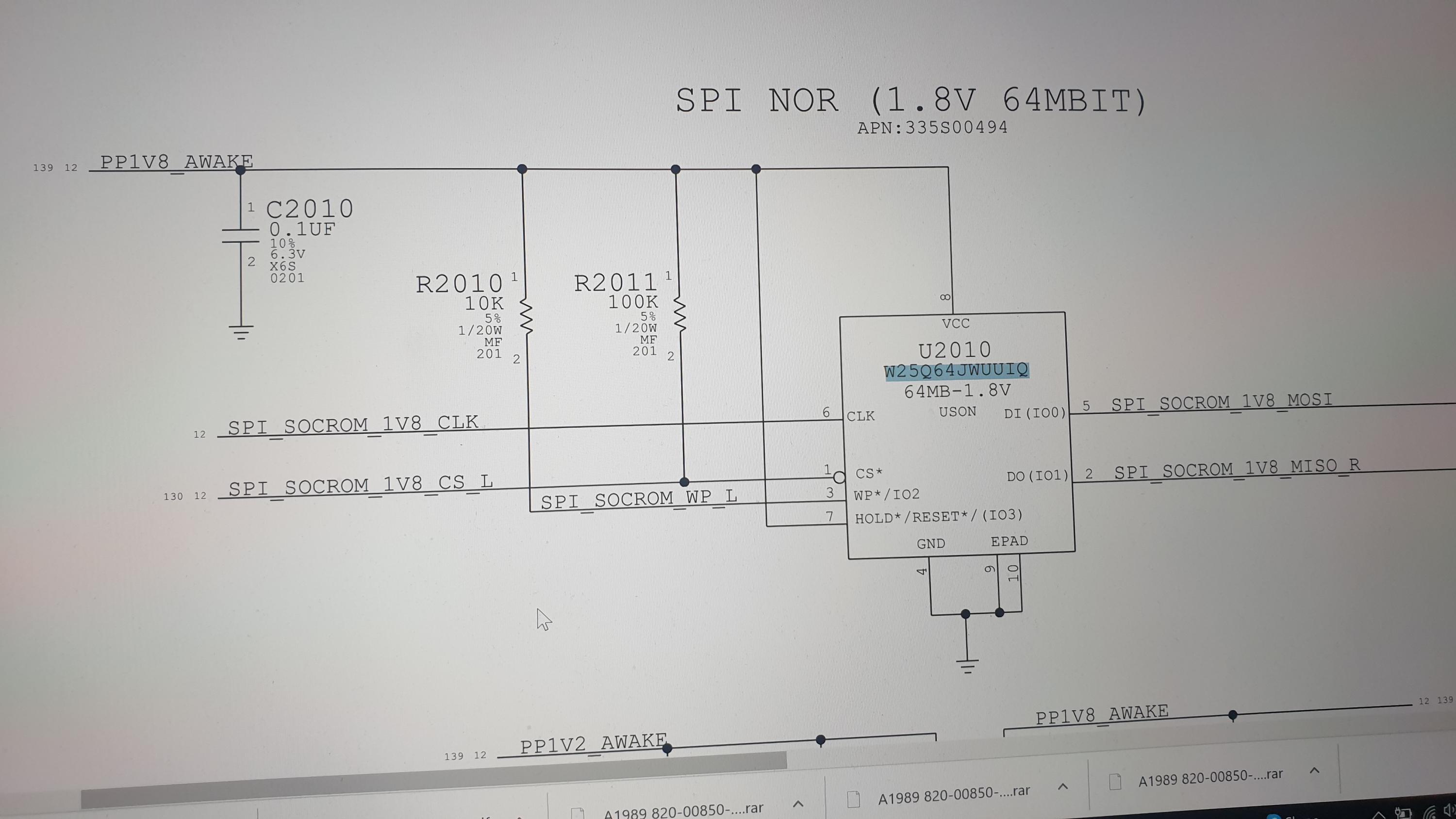

    Re: Macbook M1 bypass FMM / EFI Unlock
    Do you have boardview file/schematics for any 13" M1? I need to know where the w25q64 is located and how did you manage to read it?
      • 22012
      Schematic requests go here: https://www.badcaps.net/forum/forumdisplay.php?f=41 .Use the forum search as well,it might be posted already

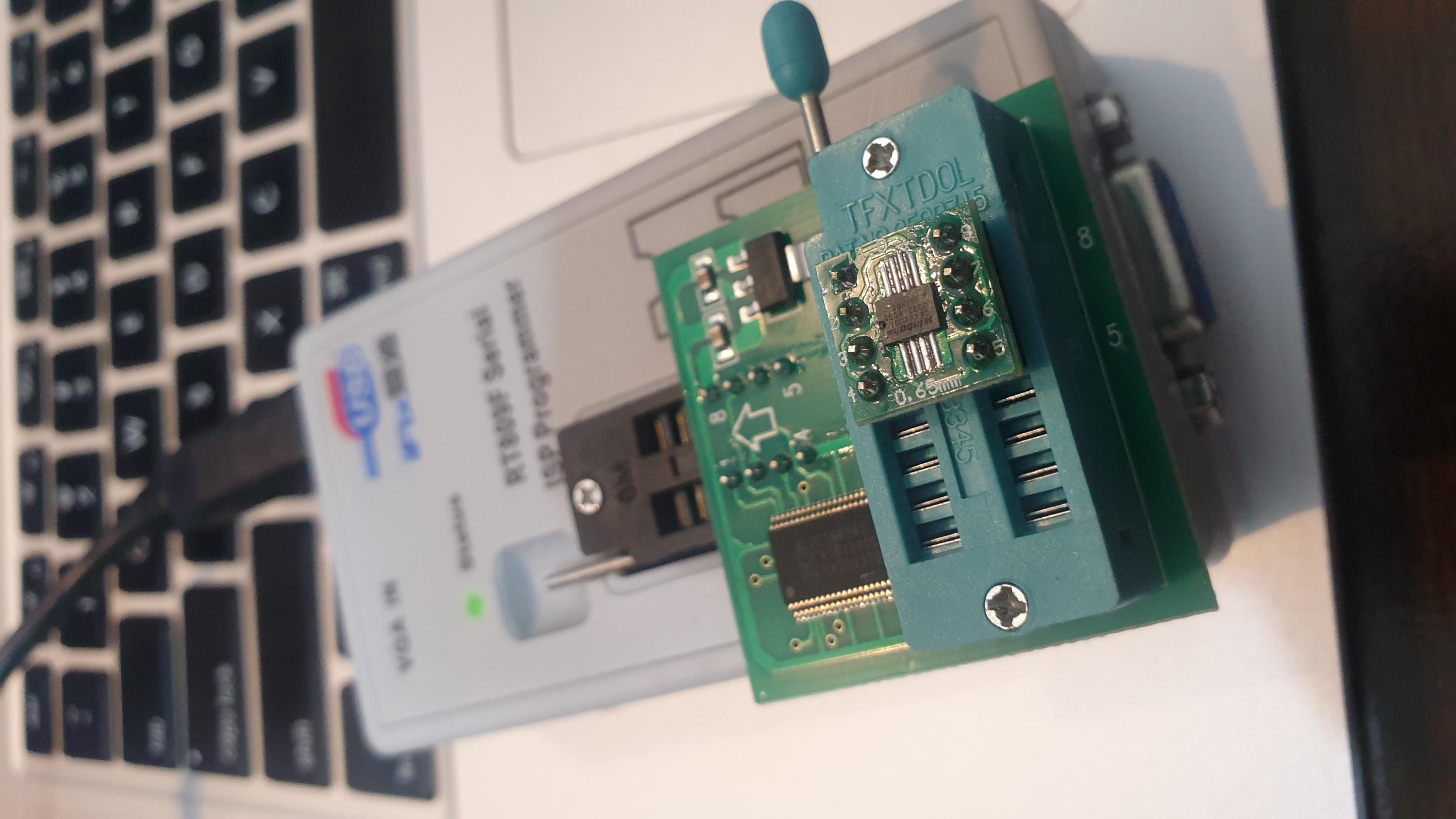

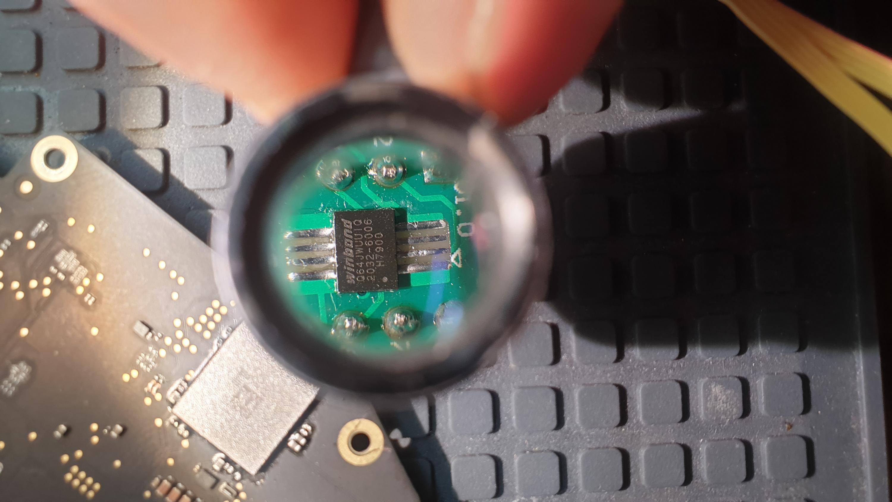

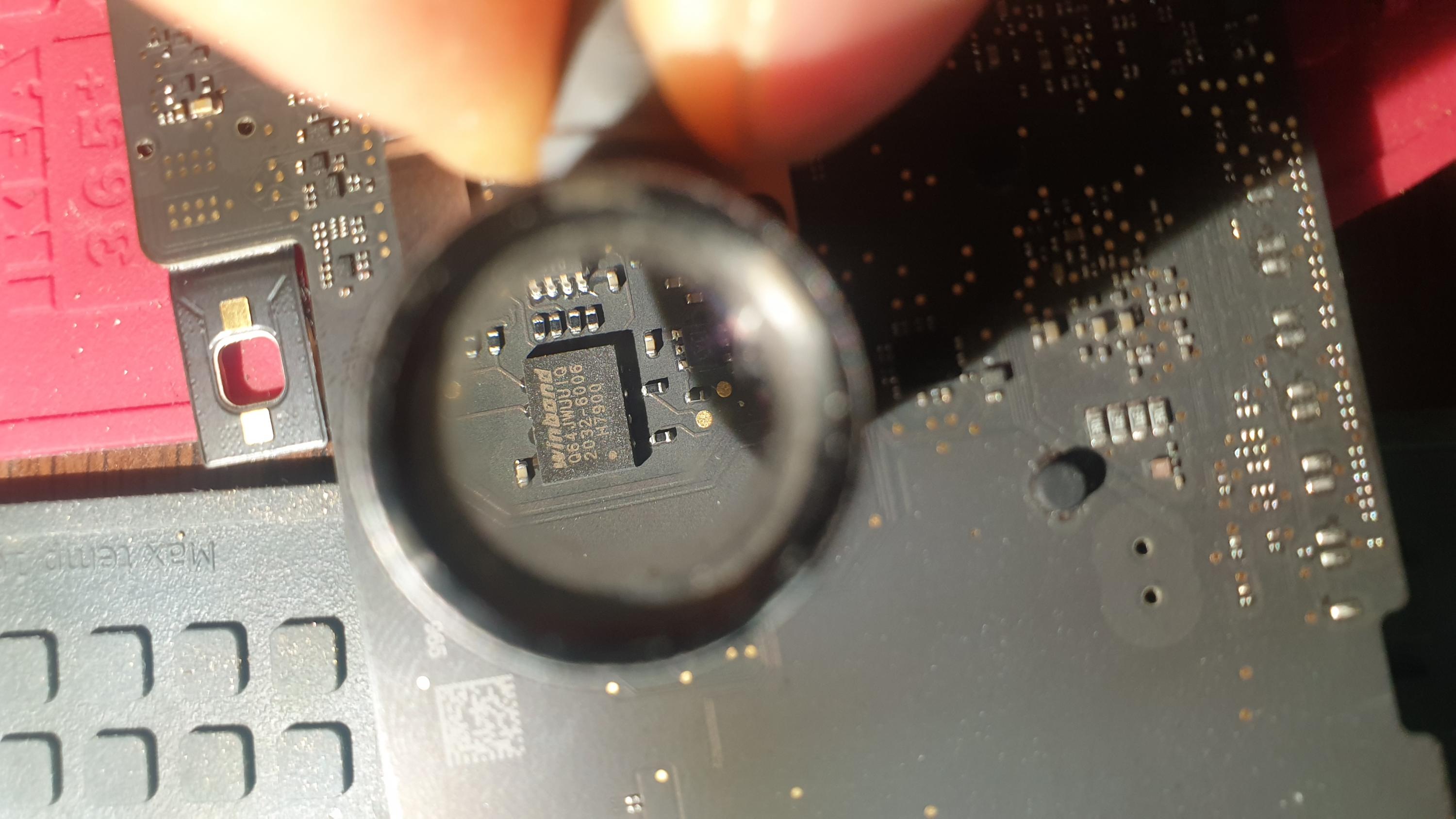

                    • betonel
                      • Nov 2015
                      • 32
                      • romania

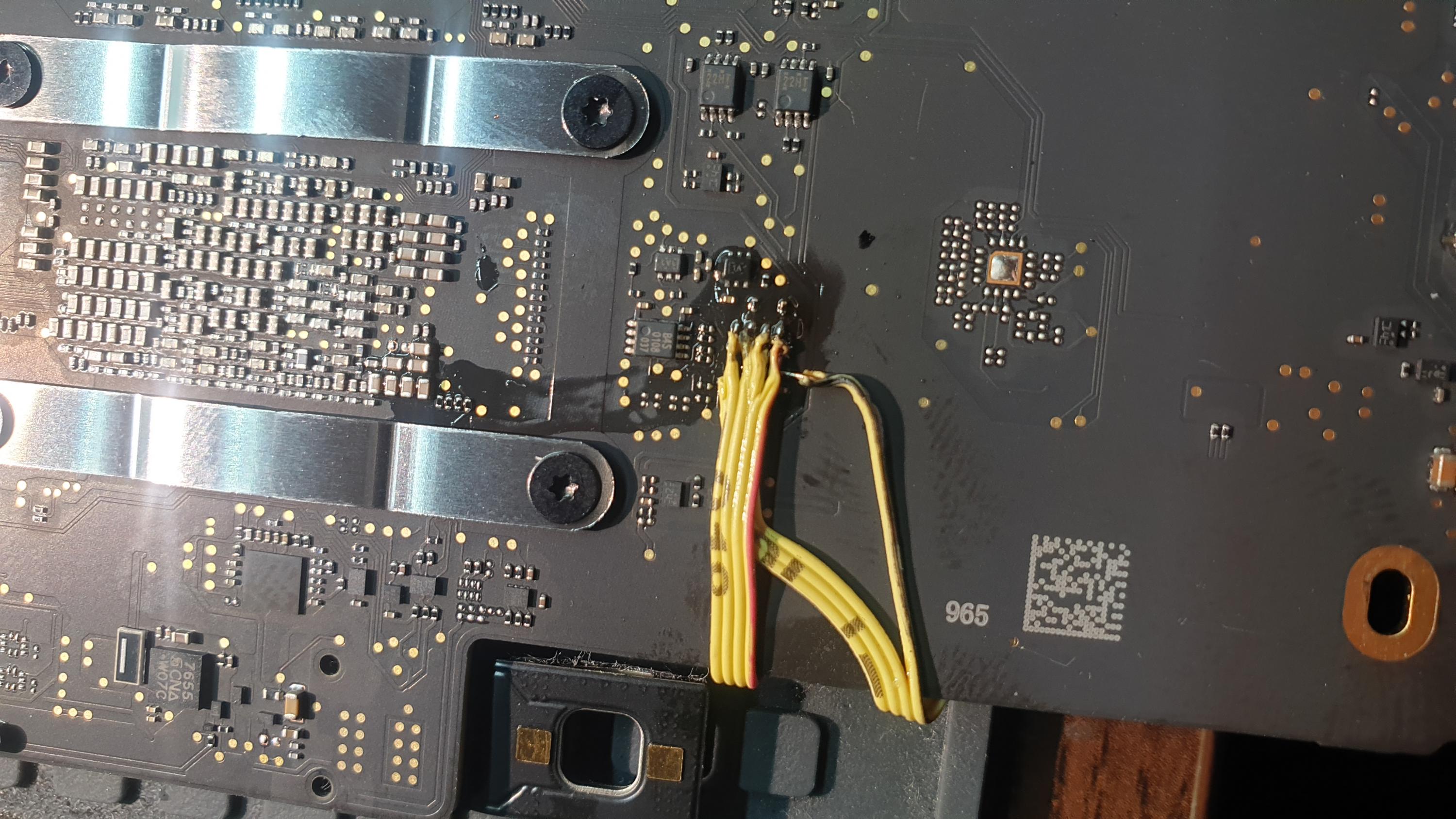

                      Winbond chip is located on the back side of the board similar with T2 models. Attached you can find some pictures of what I've done. Be careful, it's 1.8V chip, so you need to use appropriate programmer adapter.
                      If you wonder what kind of wires I've used.. it's old pc IDE cable
                      Instead of wasting money on T203 (~$200) and get stuck with uson4*3 or DS809SE (~$200) which is exactly an R809F i use this:
                      64$ RT809F + 15 adapters ( 1.8V adapter required!)
                      https://s.click.aliexpress.com/e/_A6uAnD
                      Programmer ( same as DS809SE )
                      25$ MacBook Apple Notebook Maintenance Serial Number Modification Tool T2 Chip Unlock BIOS Read Adapter Board
                      https://s.click.aliexpress.com/e/_ApVJfz
                      Let us program USON2*3 U3750+U3710 Wifi+BT ROM, XSON4*4, Apple T2 ROM USON 4*3 and Macbook M1 SOC, WSON6*5, WSON**6 and WLCSP 16 ball used on A1534 bios or SSD rom.
                      $52 Sam Connector with Seat Socket Serial Line for DS809SE
                      https://s.click.aliexpress.com/e/_A0aPKx
                      Small mod is required to work with RT809F: undo all pins from connector and put it reverse way -> red will be on opposite side , and run a wire from PIN 8 (+) to pin 8 on the board , which you can hold it by hand, without needing to power on MB machine.
                      • betonel
                        • Nov 2015
                        • 32
                        • romania
                        Originally posted by Stephen
                        Sure I can get some M1 info for a locked device.
                        Attached is my SOC chip dump and multiple tests.
                        SN from this dump is FVFDV113Q05P.
                        Please upload yours..
                        Unlocked with Secure boot disabled is wanted.
                        btw: if you re not a bot, to get correct SN, xor all 1 with 1
