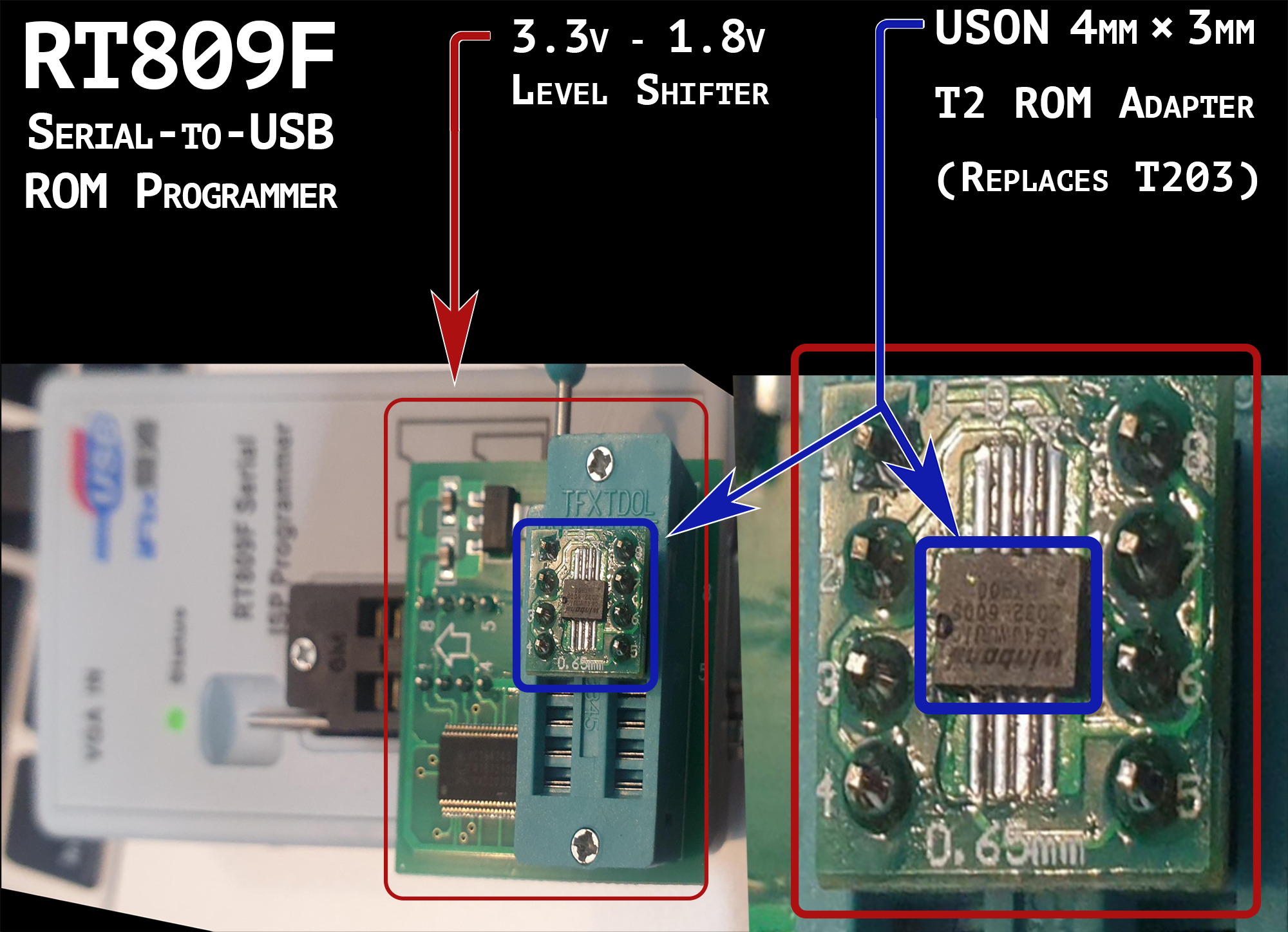

    Instead of wasting $$$
    ~$250+ - on T203 for a USON 4x3 or
    ~$200 - for an DS809SE (exactly an R809F)
    Use these...
    $ 64 - RT809F (with 15 adapters)
    $ 10 - 1.8V 'Level shifter' (for T2 ROM)
    Very good advice:
    If the M2012 - 2013 Retina 13"+15" isn't needed, would this be a good deal?
    $38 www.aliexpress.com/item/201005003289066054.html
    - Includes the CH314a
    - The PCB to solder the T2 ROM (4x3mm)
    - Includes J6100 connectors for Late-2013 - 2017 (excludes M12-E13 retina)
    - Negates any need for getting the VCC, CLK, wiring (already done).
    Already Includes the:
    $20 - T2 board
    $45 - "SAM connectors" (just not the M12 - E13, looks but ≠ L13-M14)
    $ 5 - Includes CH314a plus the 'DIL' adapter interface to the cables...
    (not as good a programmer but can be okay)
    The attached annotated image shows Betonel's suggested means of reading
    the T2 with the Level Shifter and, by soldering it on a 4x3 reader.
    (which he suggests bc 'clamshell' adapters are all a FORTUNE for 4x3mm).
    Betonel: I found a "3mm x 3mm" that's 1/3rd the price ... think it'd fit..?
    https://www.aliexpress.com/item/1005001510434419.html
    (I ask bc it looks like the width of the chip is 'unconstrained' in the holder..?)

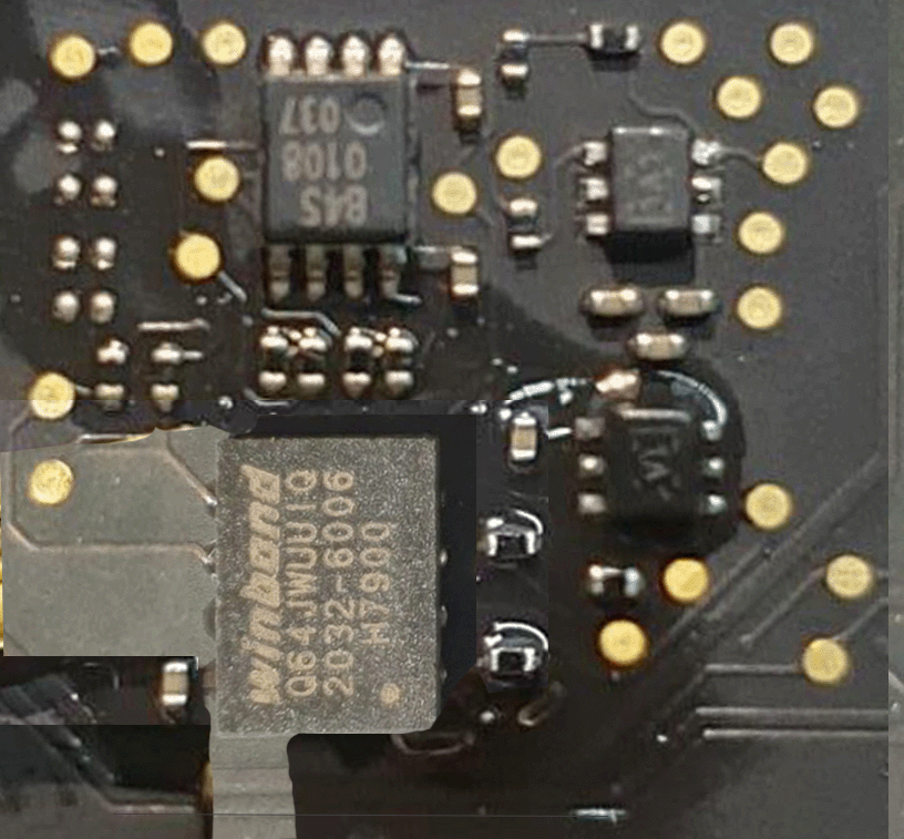

    Last:
    You wired the board analyzer (Zaleae) where the T2's ROM mounts...
    Are you really decoding the SINGALS that way ..? (reverse engineering it?!)
    The M1 looks RIDICULOUSLY difficult :'( (see animated GIF)

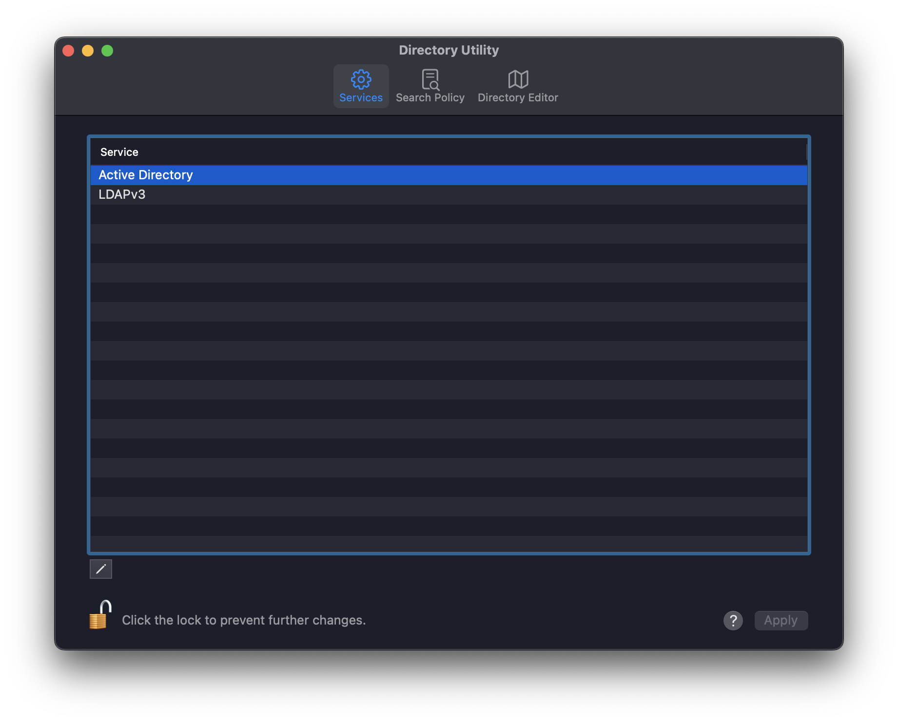

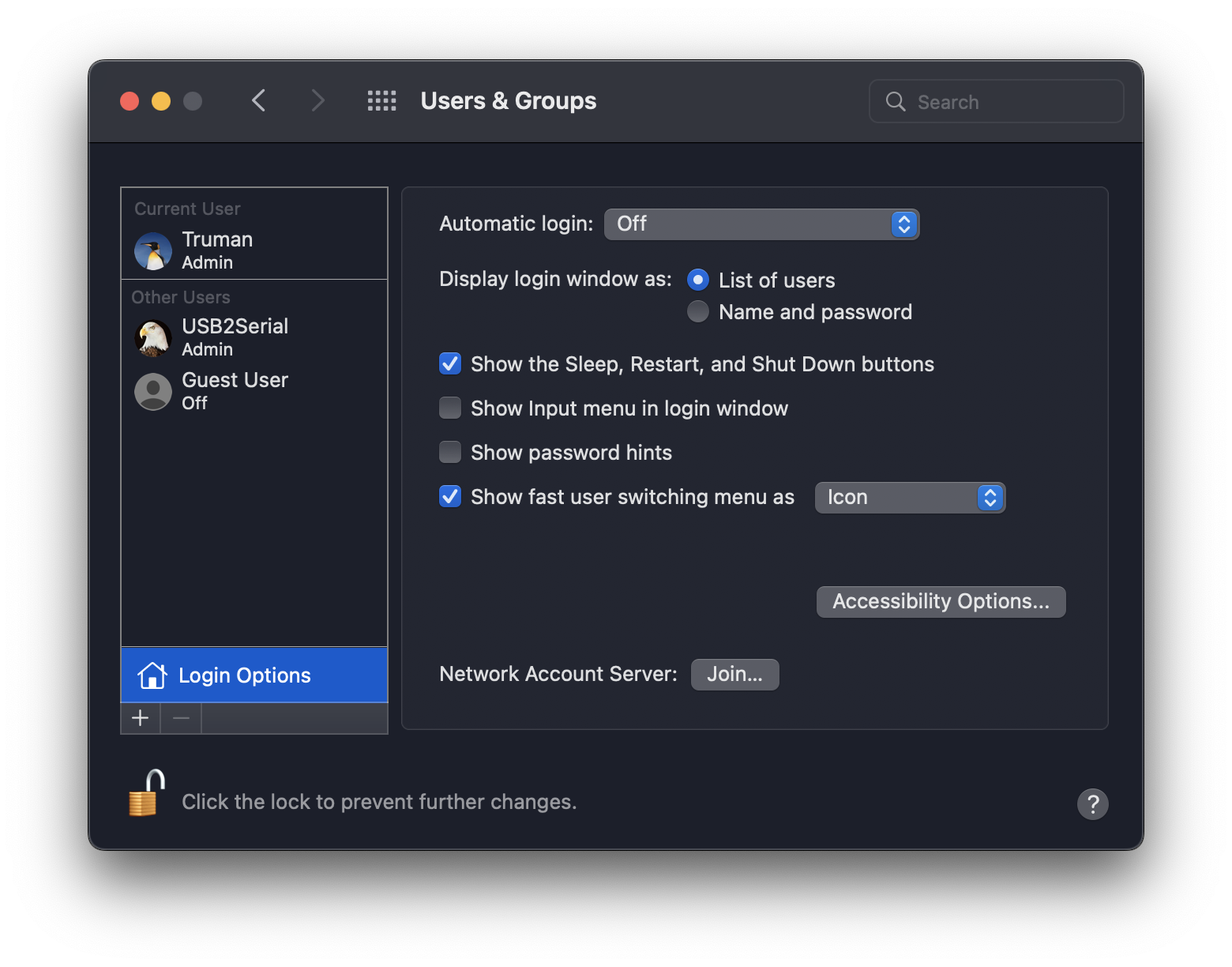

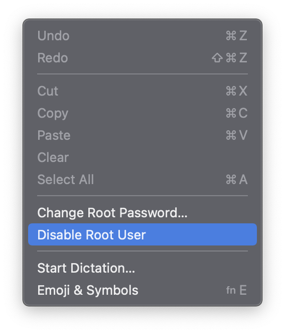

                                      Re: Macbook M1 bypass FMM / EFI Unlock
                                      Too bad more units don't have this enabled:
                                      I'm not sure if this does anything ... but it might ?
