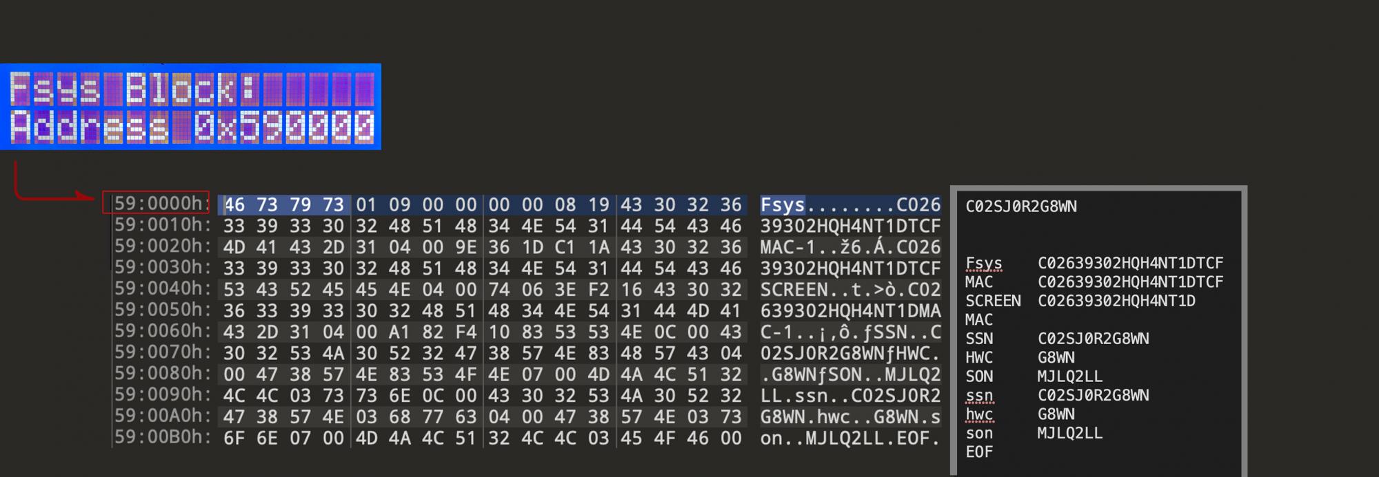

        Lessons from non-T2 computers which may apply to T2 ..?
        - Pre T2 units with changed SN's “About this Mac” say “bad SN", unless:
        - The CRC is at 0x590000 has also bin.
        - I located (but don’t understand the changes)...
        - And thus, I'll provide pictures of the regions, or study on my own).
        LMK if there’s anything you’d like me to do with the equipment i have.
        The question is -- how was the SN used to get whatever is at 59 0000 ...?
        There were also a TON of differences between the two bins, only separated by
        - one with a C-Zero-...
        - one with a C-Capital O ...
        Yet, when using VBinDiff (great for seeing the differences at each row) ... the differences were FAR more than the SN and the CRC (if that's what's there). And the implicit question is, how this info could allow inferences of what we can do for T2 and more importantly M1 macs going further.
        Thanks!
