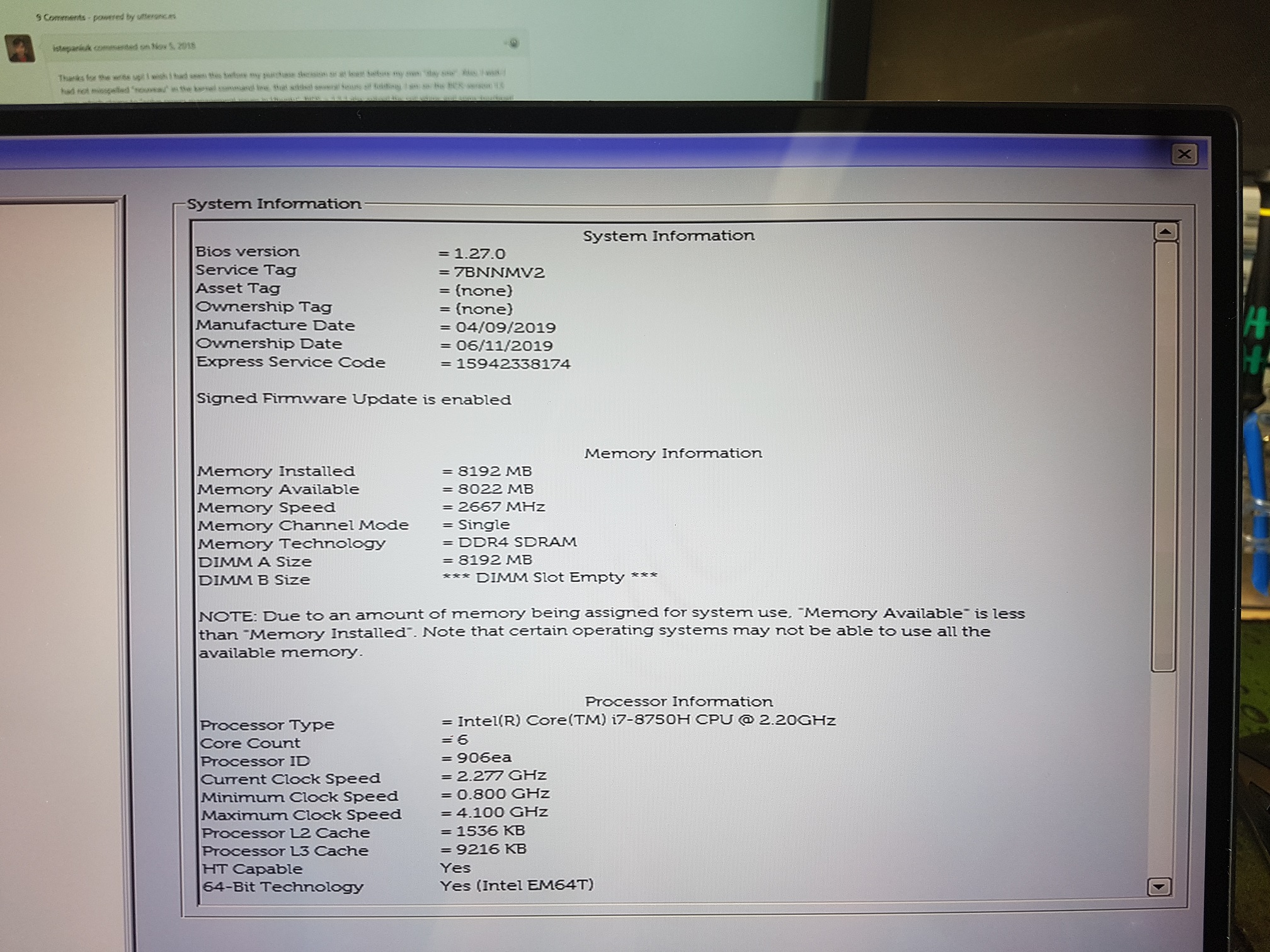

                Hello all!
                Ive replaced the PCH on a Dell XPS 9570 that was dead, and now its back to life.
                Can someone help me clean ME region on the original bios?
                Model P56F002
                service tag 1Y6LHR2
                board no. LA-G341P
                Thanks in advance

                  Here's your Clean BIOS, try it.
                  The Service Tag inside your dump file is "7BNNMV2", and it also refers to "Dell XPS 15 9570".

                    Thank you !

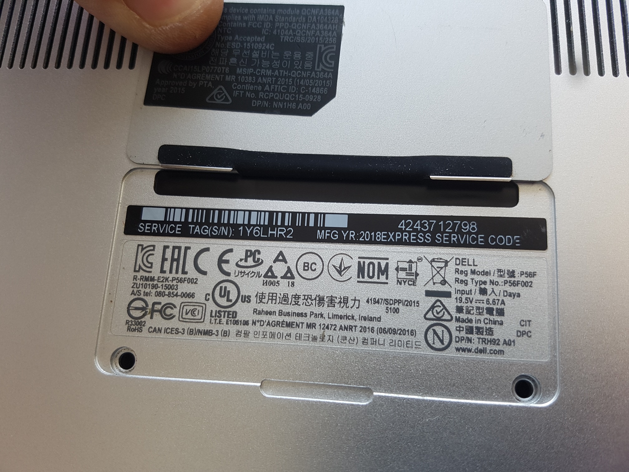

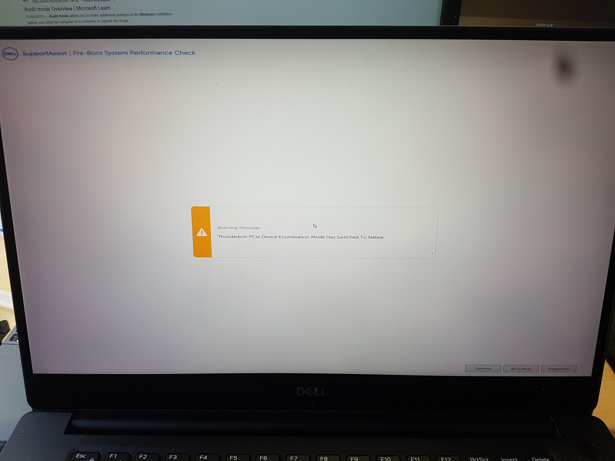

                    Ive flashed it, and I still encounter 2 issues which Im not sure if its due to the PCH replacement, or Bios.
                    First, each time I restart the machine I get this message
                    thunderbolt pcie device enumeration mode has switched to native
                    The switch option is disabled on the bios, and still this happens every time I reboot the machine
                    Secondly, I can install the GPU drivers (1050ti) with no problems, but when machine is rebooted, again, it appears in device manager with exclamation mark code 43 error.
                    If I reinstall drivers, it appears as normally installed and running with no errors.
                    The service tag on the cover is 1Y6LHR2, maybe someone worked on the bios before getting the machine...not sure.
                    Would the service tag mismatched create some of the issues im describing here?
                    Photos attached
                    Thanks for any inputs, appreciate it

                      Try this New BIOS and see what will happen, I think if it works fine will let you insert the Service Tag in the BIOS menu.
                      Also it could help you with the other issues.
                        Hey Hardware1!
                        First of all thank you for your help on this one.
                        This dump worked fine, and I was able to enter the correct Service tag.
                        And it fixed the PCIe switch message.
