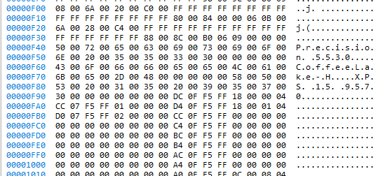

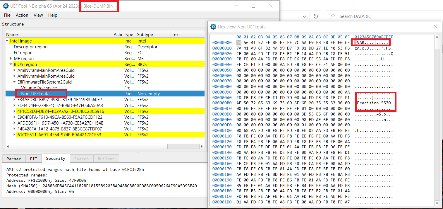

              I actually managed to retrieve the dump of the bios chip, I am attaching it. Can you spot if there are any problems / repair it / fix it? Service tag is 158BQQ2. Thanks in advance.

                This bios file cannot be edited as it is for the Precision 5530.
                  Uhm, the repair guy told me he extracted it from my XPS 15, can i ask you how to show him proof that he gave me the wrong file? So i can tell him to stop messing around

                          Also, can you please tell me how you can say the BIOS I attached is for Precision 5530 and not XPS 15? I want to show the guy that he sent me wrong file, but searching for "9570" in UEFITool I can find many instances of text "Precision 5530 Coffee Lake-H XPS 15 9570" so... I can't understand why they're both mentioned (see attached image).
                          Thanks again for all your help.

                              I went back to the repair guy and he said that the other file he sent me was wrong, and here is the correct one... He said this was ripped the first time he started working on my laptop. I find it strange that it's only a 8MB file, I expected a 32 MB file. I called him about this and he said that the chip is damaged and the programmer could only read this. I told him that the programmer should recognize the chip brand/model and based off that read 32 MB nevertheless, even if the BIOS is corrupted and it's all filled with junk bits or 0xFF, but reading another size… I don't know. Is he still messing around with me????
                              He told me that he has replacement chips to resolder, but before that he wants to program them with the correct BIOS file and he still couldn't find one. I also find this strange, on the same website that he got the other BIOS he sent (alisaler.com) there's a BIOS for the XPS 9570, albeit for a different board model/revision… Would that make a difference or would it be good?
                              In the meantime I'll try to have him flash the file you sent earlier.
