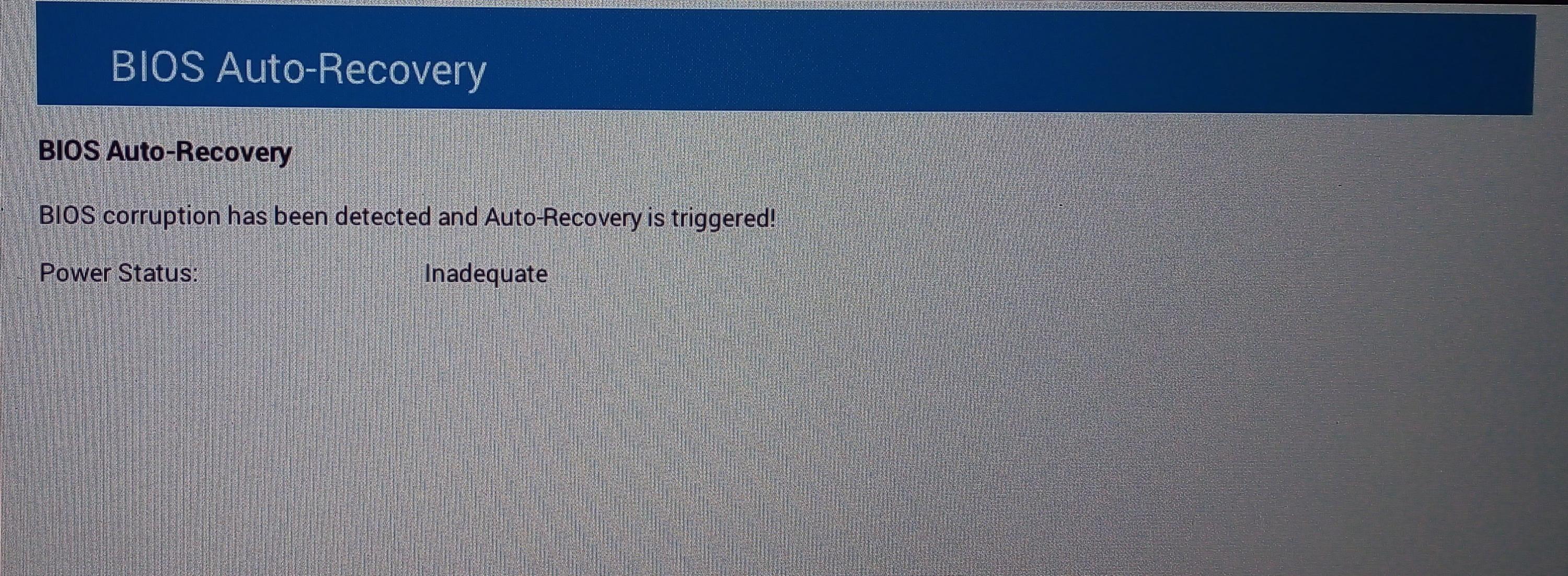

                                          #100
                                          Dell G3 15 bios help
                                          Hello everyone
                                          here is my problem:
                                          When I start the computer I get this message:
                                          "bios corruption has been detected and auto recovery is triggered power status inadequate."
                                          Could you please help me?
                                          Thanks in advance
                                          Attached you will find my original BIOS.
                                          Thanks again.
                                          dell G3 15 3500
                                          motherboard: selek g3 mlk n18p 19795-1
                                          SERVICE TAG: 95LSD63
