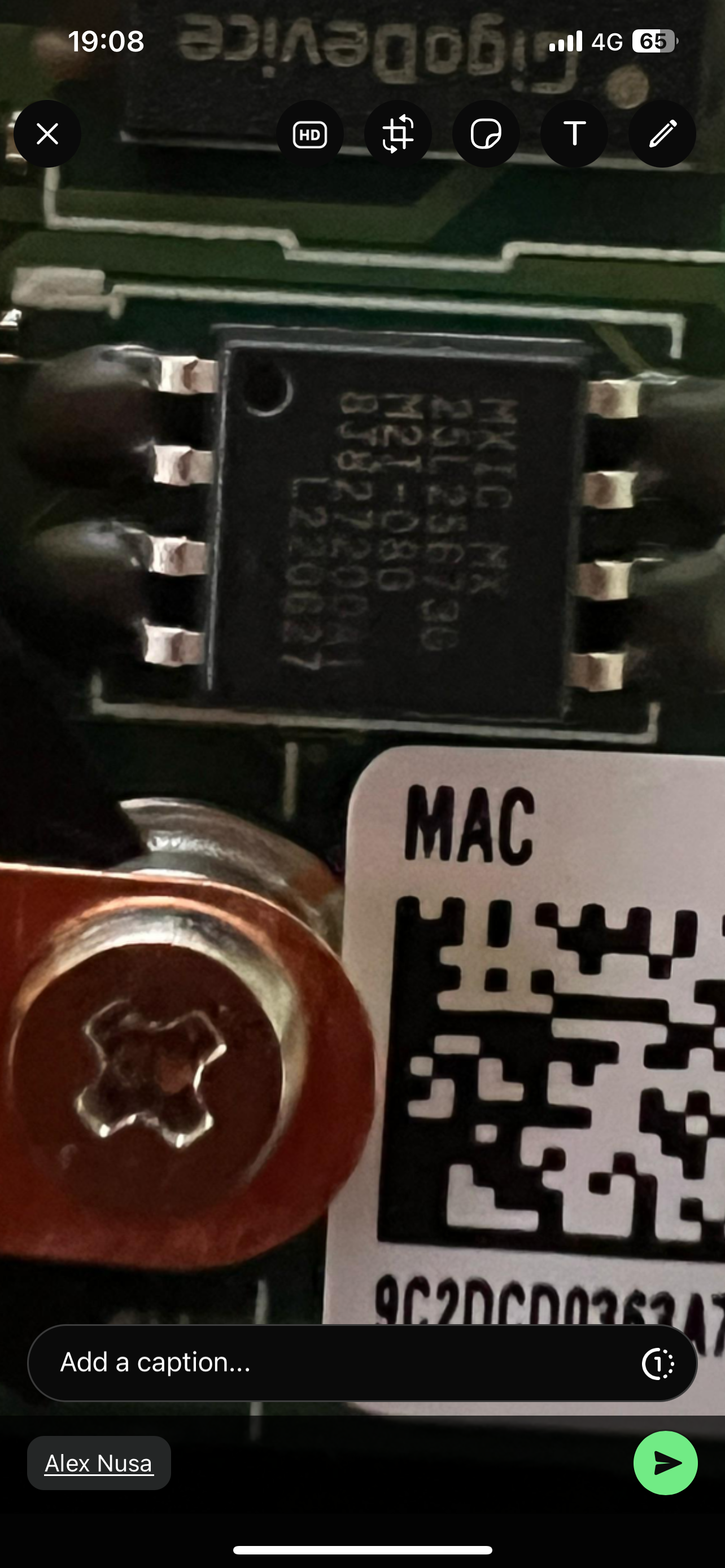

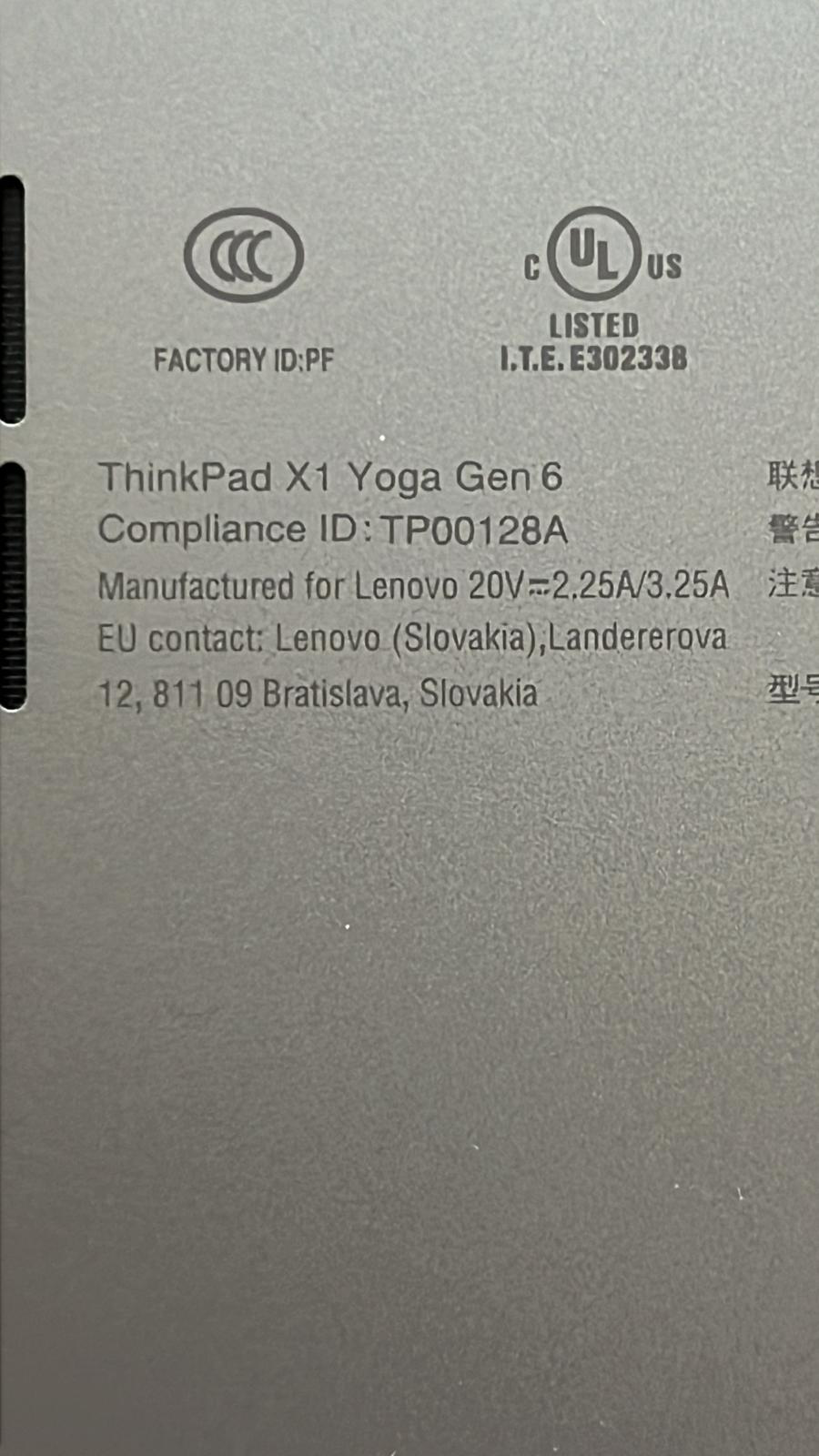

            #3225
            hi,
            anyone who may have a good bios backup for thinkpad x1 yoga 6th generation?
            currently the bios is empty,the old backup probably corrupted( when is written error : “file and chip in disagreement “
            sn PF3​ZQLDN
            bios in the picture attached.
              SMDFlea commented
              Editing a comment
              If you have a CH341A programmer use NeoProgrammer software. Make a backup.
