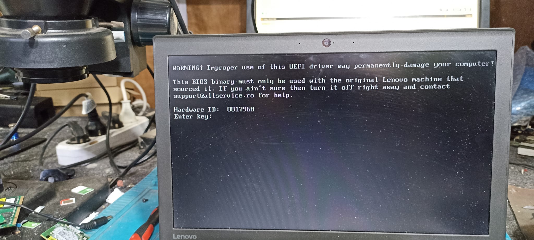

                            #1313
                            Re: LENOVO BIOS AUTO-PATCHER for Supervisor Password Removal
                            thanks for help it work but it ask for hardware key after hit on enter without any key i get invalid key
                              • 22182
                              #1314
                              Enter any ID to hardware Id.
                              • corona100
                                • Mar 2020
                                • 155
                                • U.S.A
                                #1315
                                i know that you don't understand me but this is the reality and if you put any thing you get invalid key error
                                • corona100
                                  • Mar 2020
                                  • 155
                                  • U.S.A
                                  #1316
                                  thanks for help .your dump ask for 7 hwid key
                                  i use the patcher on another pc i get the cleared and its work like charm
                                  thanks again
