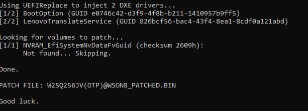

        Lenovo T495s 20QK
        The first try didn't worked out and the bios beeped 5x times (wrong checksum). UEFITool revealed the wrong hash:
        Code:
        FfsParser::checkProtectedRanges: Phoenix protected range [BB0000h:F30000h] hash mismatch, opened image may refuse to boot
        RelativeOffset: 00BB0000h Size: 380000h
        Hash: 894F0EC4AAE777028ADC60150B10ECE724FC165E6530129DD6B56E45623192E6
        With the help of HxD i calculated the SHA256 of above range and replaced the old hash with the new one (search the old hash and replace it with the calculated one with help of HxD). A boot with manipulated checksum and patched BIOS binary worked. Supervisor password was removed. Thank you very much!
        Donation incomming (:
        EDIT:
        Output of patcher:
        Code:
        Using UEFIReplace to inject 2 DXE drivers...
        [1/2] BootOption (GUID e0746c42-d3f9-4f8b-b211-1410957b9ff5)
        [2/2] LenovoTranslateService (GUID 826bcf56-bac4-43f4-8ea1-8cdf0a121abd)
        Looking for volumes to patch...
        [1/1] NVRAM_EfiSystemNvDataFvGuid (checksum 2609h):
              Found volume at offset 710000h (checksum 91f8h)
              Volume checksum does not match... Skipping.​
