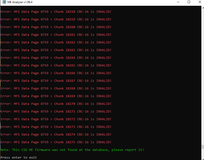

                                    #2357
                                    Re: LENOVO BIOS AUTO-PATCHER for Supervisor Password Removal
                                    Im stuck at "Entering Setup" all the time the same message.
                                    • Markus1741
                                      • Sep 2020
                                      • 967
                                      • N/A
                                      #2358
                                      Hello, you also didn't mention that your original BIOS file is corrupted in the ME region, of course it can't work.
                                      I cleaned the Me region from your original file, try these two files.
                                      Good luck ...
