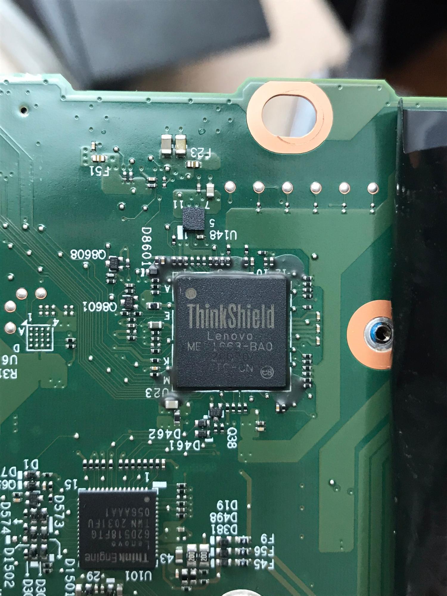

        Re: mec 16xx dump with info block
        Originally posted by 69d0b913
        Thank you for your time, but I managed to remove the T14 bios password using my RT809H, this machine does everything, you just have to know how to use it, after many tests I discovered some achievements that no one shares.
        Hi! How you removed the password with rf809h? pls help me!!!!

          #184
          I don't know which machine is trying to remove the password, but if it's the ones in this topic, go back to the beginning of this one Thread, nao tem erro.

              #186
              Hello, password on T590. I have Vertyanov, read mec1663 epprom area 2kb and write edited bin with same FF inside. Now laptop show me messages like this. Invalid RFID Configuration Area etc. I can't enter to bios settings... Do you have mec 2kb bin without password?

                      #190
                      P52 has mec1653, jtag pins are same as other thinkpads.
                      did put the pull up resistor for reset , but Vertyanov_JIG gives error.
                      did anyone managed to read the eprom from P52

                          #192
                          Same here. Everything look good but unable to read data.

                            #193
                            Assuming everything is OK, I suggest to take a look at motherboard schematic, check JTAG interface, you will see each signal has a PULL-UP resistor which are not populated in motherboard.
                            Now check the programmer to see if it has these PULL-UP resistors on JTAG signals.
                            You may have to add these PULL-UP resistors to motherboard JTAG signals for programmer to work… worth a try.

                              #194
                              You don't need a resistor, just jump and read it, if you couldn't read it, you can extract the EC from the original file and then just flash the MEC16xx, nothing more than that. After the procedure you will have to write all the machine information such as the serial number of the machine board and a few more things. Some machines can't read the MEC16xx just write, I had this same experience on a T14 thinkpad, I discovered it after 3 weeks of attempts, so I just wrote it I used the same way I described it above and then I was successful.
