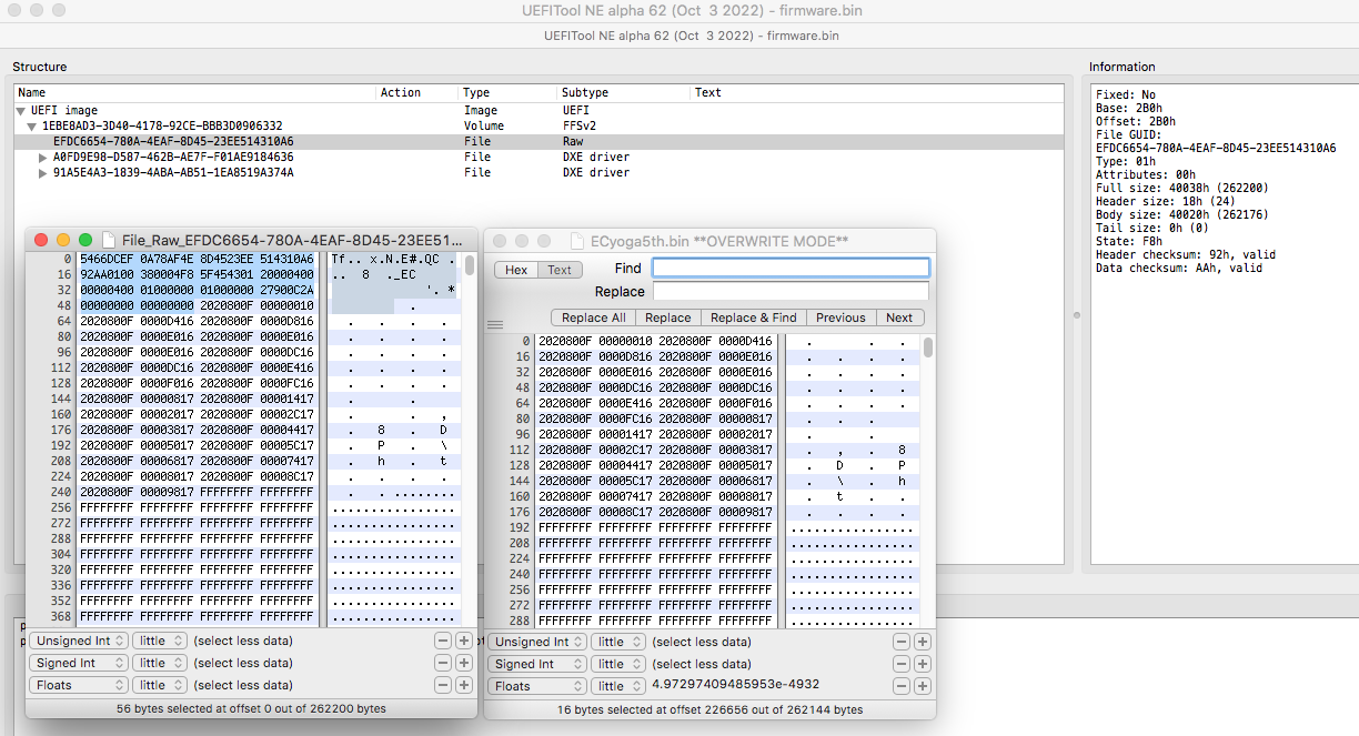

      Re: mec 16xx dump with info block
      Originally posted by roadrun
      Hello, can you explain how to find the MEC-Image in an bios update? And how I trim it correct. I can read the CHIP ID, but after verifying the checksum is 0 and RT809H says it is encrypted.
      I have downloaded an bios update for LINUX, which contain 2 cab files. One is an bin for EC with 760kb , which is to much for an MEC1633.
      open 760kb file with UEFITool, extract as is file GUID: EFDC6654-780A-4EAF-8D45-23EE514310A6 and you will obtain a 262.200 bytes file. Your file should be 262.144 bytes so you have to trim 1st 56 bytes. It seems I used an old bios update version and I had to trim only 32 bytes.

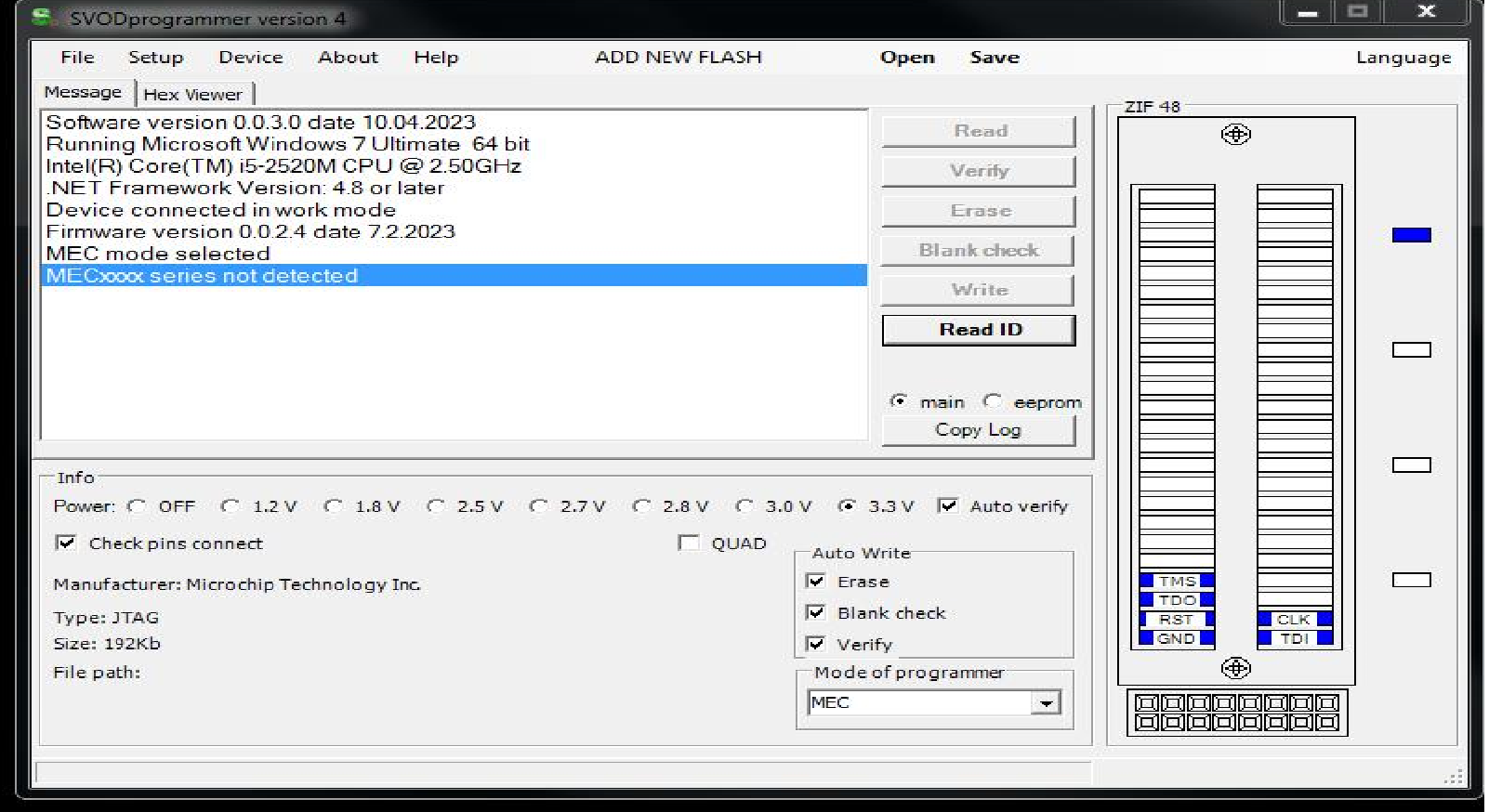

          how to read mec1663 with vetyanov ihave nm-c881 motherbord thanks

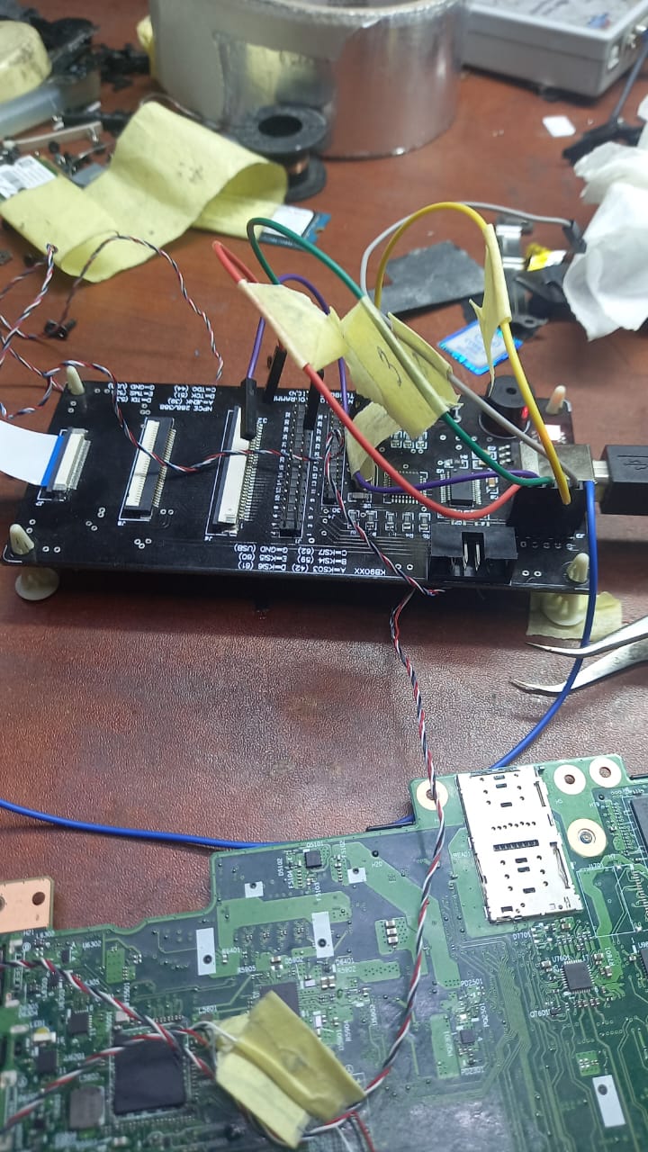

              #346
              I NEED HELP I HAVE 2 T490S AFTER Write FILE LAPTOP DEAD HELP ME PLEAS

                #347
                I tried svod3 it didn't work

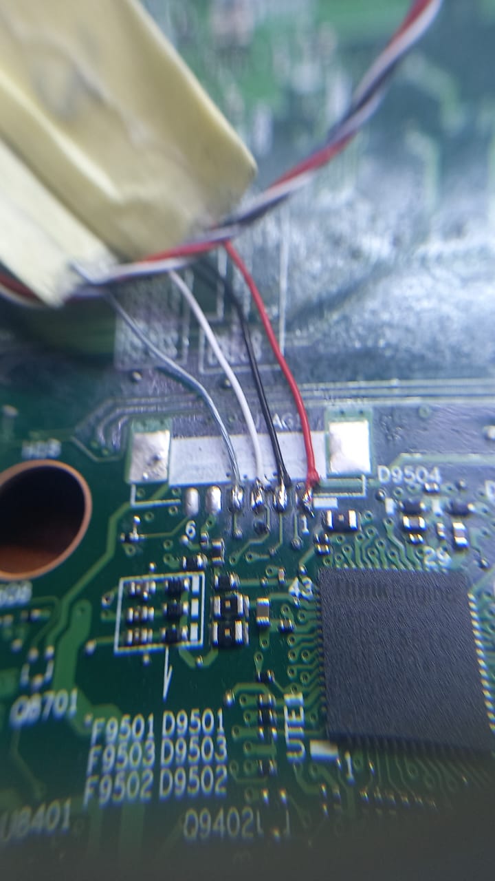

                  #348
                  Why 4 cables, not 5 cables?
                  You move resistor after write?
                    Originally posted by dimah77
                    Using RT809F, choosing MEC1633-256K , unlock done.
                    Don't choose MEC1633#ISP , it provide 192K file and password is not removed after write back.
                    Hello friend, can you send me the schematic you used to connect the rt809f programmer to the jtag connector please.

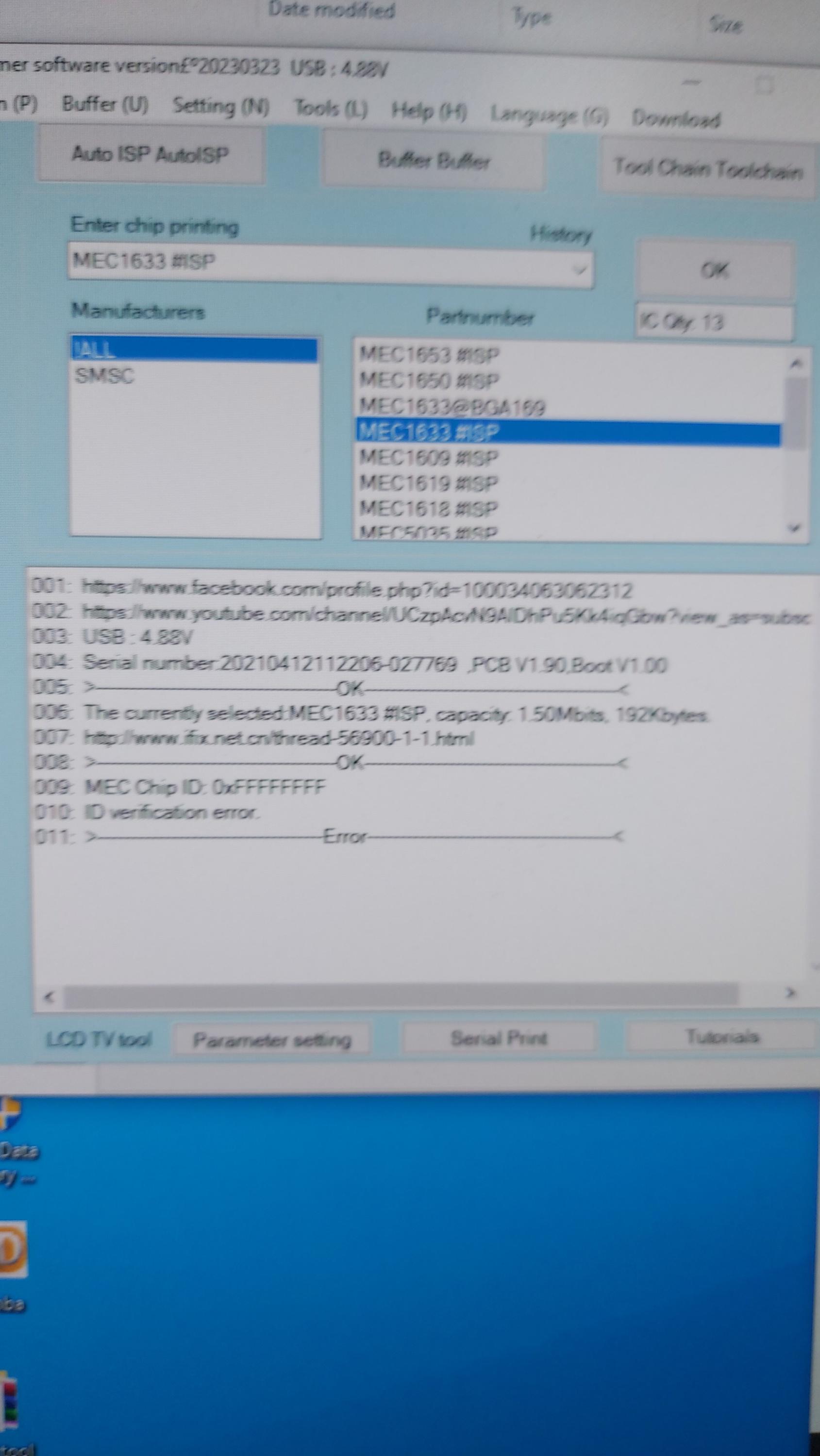

                      Hello Guys I am trying to read the MEC 1663 on this laptop Lenovo X1 Gen8 NM-C661 Rev 1.0 with RT809H but it's giving me error Mec Chip ID:0xFFFFFFFF, ID verification error. I have moved the 10k reset resistor in pic 1 and I have also tried to put the 4 pull up resistors pic 2 and it's still giving same error, I also tried to connect reset pin to RT809H but no change, is there anything I am missing. I have done different models before with no problems. I have tried to select different part number on RT809H but same result

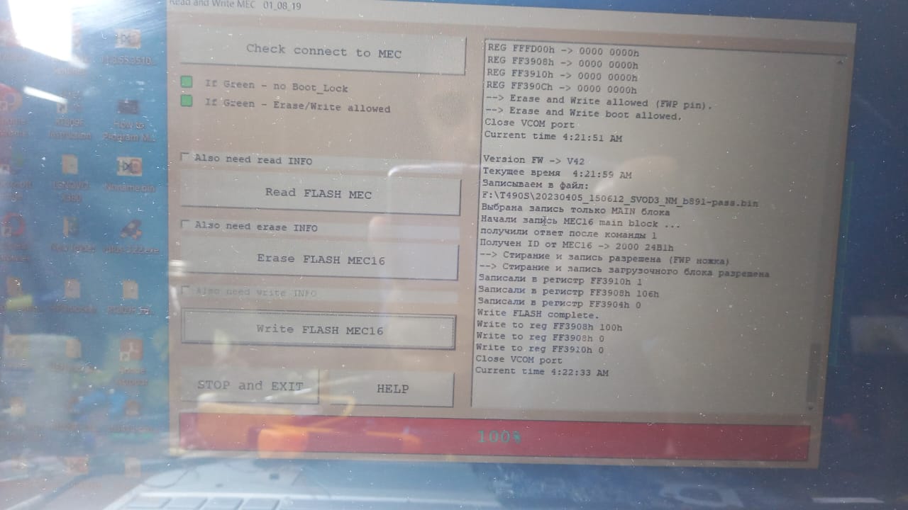

                        #351
                        Originally posted by LenBios
                        @syladrian
                        select MEC1653 from RT809H List, connect the charger and read the chip it should be 290kb.
                        Erase the chip and write the File back
                        (done 2days ago)
                        Hey mate, thanks for the tip with the charger, that was what made it possible for me to read, erase and write.
                        However my device is dead now, is that resistor really necessary or can i also bridge that? i lost it already as its so small
