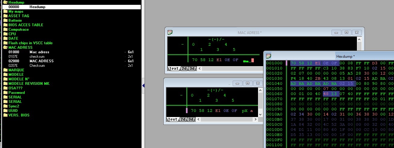

Re: Panasonic Toughbook CF-53 Mk3 BIOS Password Removal
Afaik it contains SN etc and probably ME is not cleaned so it is way better to just upload your own dump and get the password removed on that.Comment
So if we clean the ME and leave the SN as is it will be possible to work fine?
I ask because i'll receive a pallet with 30 laptops for unlock.Comment
Warning Mac adress and UUID
if used in the same corporate network.
Attached Filesif you find these attachements useful please consider making a small donation to the site
So i must change the MAC address and UUID in every bios.
Perhaps it will be easier if i remove the bios password on every bios my self.
Is there any guide for CF-53 ?Comment

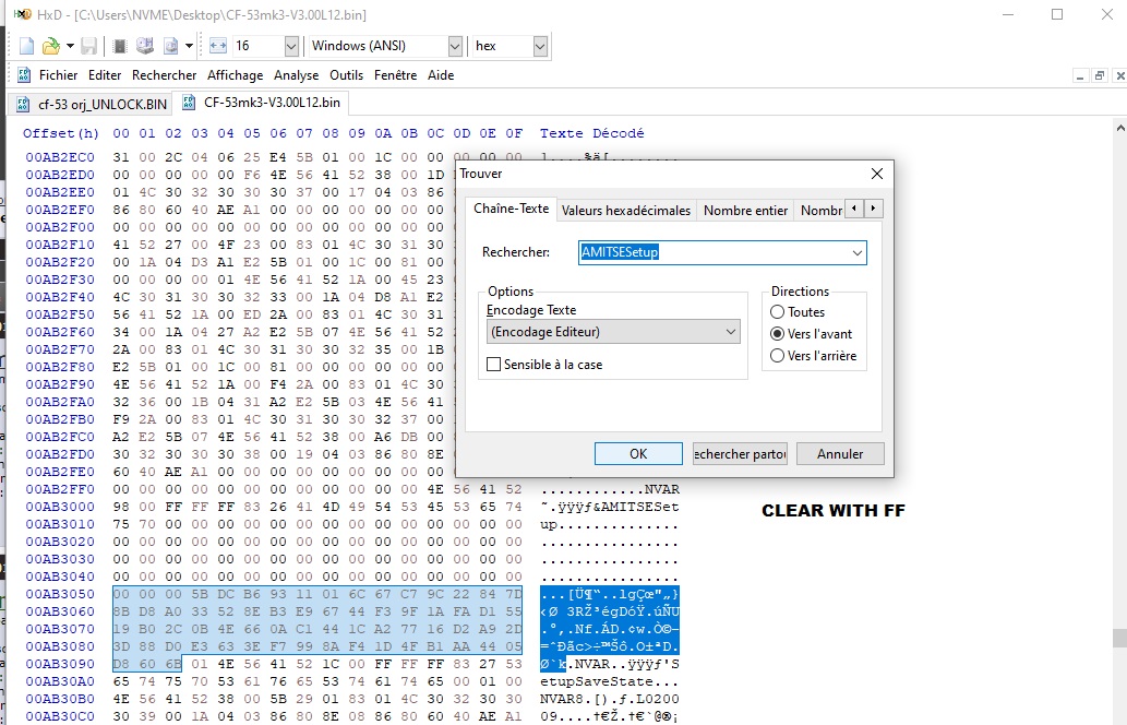

here sur bad caps
, just compare with other files
edit :
I forgot the 01 at the end and replace by 00 and not FFAttached Filesif you find these attachements useful please consider making a small donation to the site
yes, beware the address changes for each bios.
Search with the keywords "AMITSESetup".(the second often)
I gave you the technique for the supervisor password.
It can have the user's password too.
It is just above if there is a.
It will always start with 5B.
Look at my picture here you will understand.
https://www.badcaps.net/forum/showthread.php?t=88289Comment
Ok, i'll let you know when i receive the pallet. Thank you!Comment
Hello, I have done what you indicate, and it has worked for me. It asked me for a password to enter the BIOS, and now it no longer asks me for it. Thanks a lot!!!Comment
