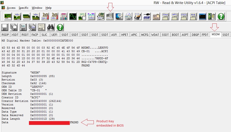

            ok, take your time... for a while i had idea to test and try that win8 licencing sh*t but never had any laptop suitable... maybe together we can do it
            u can use rweverything to see if serial is embedded in bios ok
            here is tool

              ok, that utility didnt open bin file, it read your own bios in laptop directly, so i have to flash ur fixed bios, install windows and then give it a try. if that work, can i just save key file , flash newer bios and put serial back so im sure all other things of bios are ok ?

                ehm, this tool does not open bin file, it reads serial for win8 from windows... all you need is to install matching win8 version (core, pro, enterprise), read key, activate windows (must be connected on net) and it shuld work... ive done it few times on Toshiba laptops
                that will work if i fixed bios propertly

                                  its latest version, and key is inserted, should also be visible with rweverything when you reinstall

                                      Re: acer v5-571 bios corrupted . need repair
                                      ok ive seen the windows key, but file version 2.18 is 13mb instead of 8mb.
