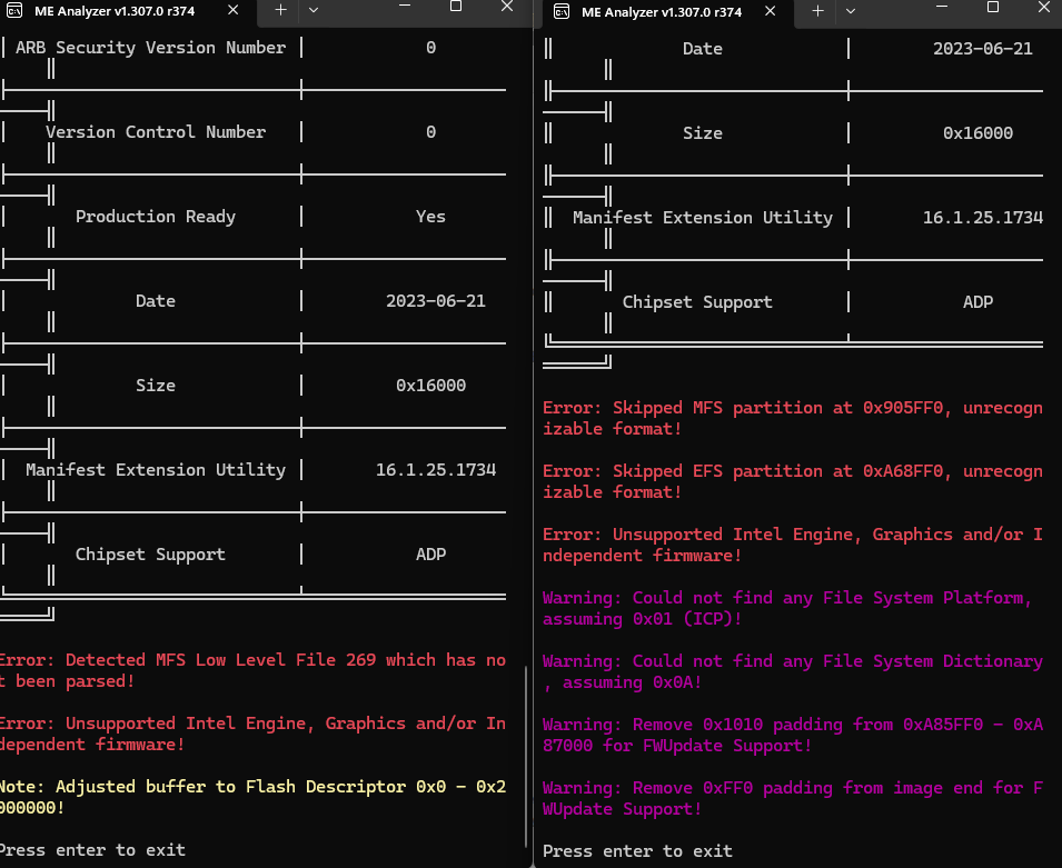

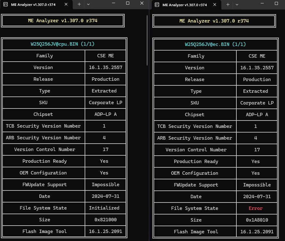

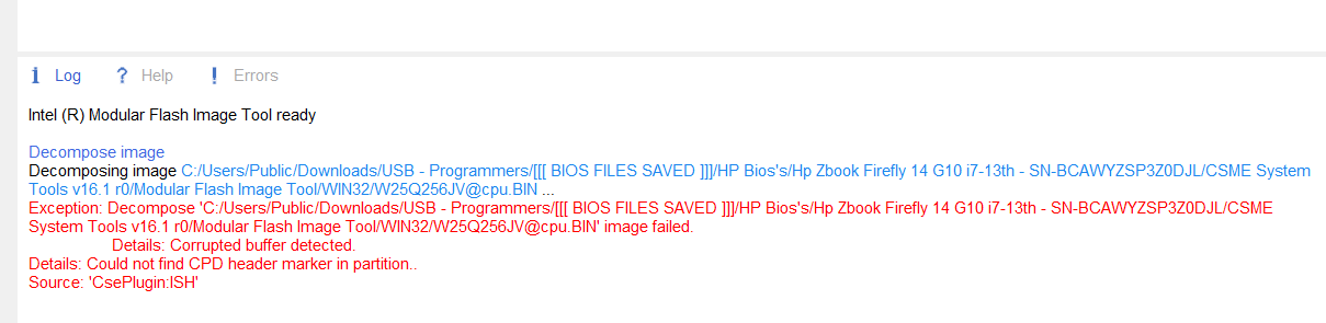

    • I extracted both 32mb bios files (Main + EC). But when i run the main 32mb bios through MFIT.exe , it produces this error; ie:,
    Click image for larger version  Name:	MFIT_error.png Views:	0 Size:	13.9 KB ID:	3753827
    ME analyser info's:
ID:	3753830 Click image for larger version

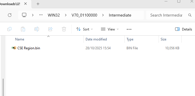

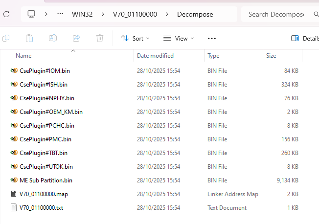

    Steps I tried to create a cleaned ME Bios-
    • So, I then downloaded the full Hp Bios file direct from Hp website (sp163147), extracted it to a folder (from the exe) which gave me a number of files. The MAIN bios file though (V70_01100000.bin) is 40MB (I was expecting a 32mb file..?). So, I tried dropping that into MFIT, which surprisingly was accepted, and it extracted the 40mb file down into two folders, 'Decompose' & 'Intermediate'. These folders combined only totalled 19.6mb... so.. where did all the rest of the 40mb go to?
    So im kinda stuck now... I have my dumped 32mb main bios that MFIT wont accept, and I have a 40mb bios file downloaded from Hp's exe that is accepted by MFIT, and no way of making a cleaned ME bios from either...?
    Extracted Folders contents;
    Click image for larger version  Name:	40mb_Intermediate.png Views:	0 Size:	15.4 KB ID:	3753825 Click image for larger version  Name:	40mb_decompose.png Views:	0 Size:	41.2 KB ID:	3753826
