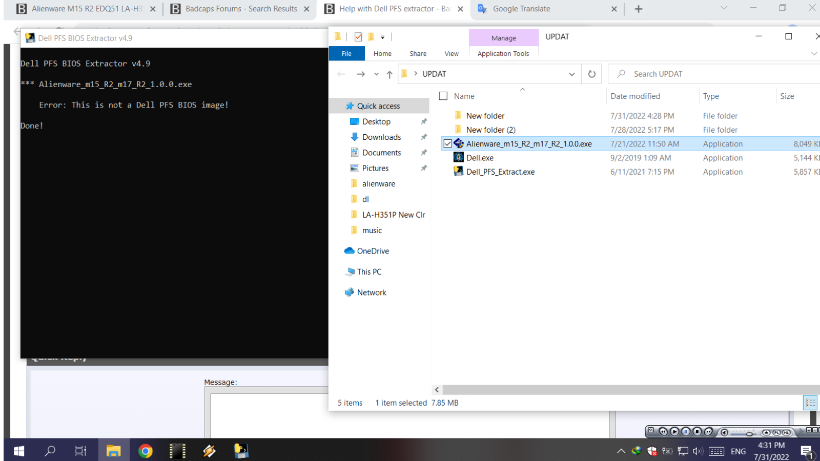

              hi bro
              I am facing this error
                • 21211
                Re: Help with Dell PFS extractor
                Originally posted by ali.nb66
                hi bro
                Its a different type,it will not extract using PFS extractor.
                Firstly you can extract a rom file by using the command line
                Alienware_m15_R2_m17_R2_1.16.1.EXE /writeromfile
                The rom will be written,then it needs editing to the correct size. You can use AMI_PFAT_EXTRACT software to remove the PFAT header,it will not remove the end part (footer) so it will need further editing with a hex editor. It isn`t a full bios image,it is only a bios update !

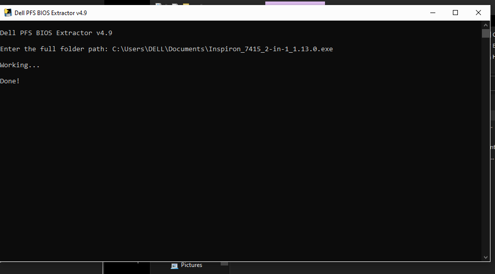

                              • EduarDOOX8
                                • Jan 2020
                                • 6
                                • Poland
                                I have a problem. I got message . . Done! But no file is created. I was searched for it manually, nothing. I changed folder, i changed bios, i changed extractor. Every time i got Done! But no file is created. Whats the problem? I searched that python is needed so i installed it but nothing changed
                                  Make a folder that contain bios + pfs extractor and try
                                  https://www.youtube.com/watch?v=nZ3gRlI0bvw&t=71s
                                    Same story, changing partition with one folder including both files same story, running as administrator same story, changing names of bios files same story
                                    Is Windows 10 Home a problem, maybe that should be a pro version?
                                    I tried extractor from here and from labone site
                                      • 21211
                                      post a link to the bios you`re trying to extract
