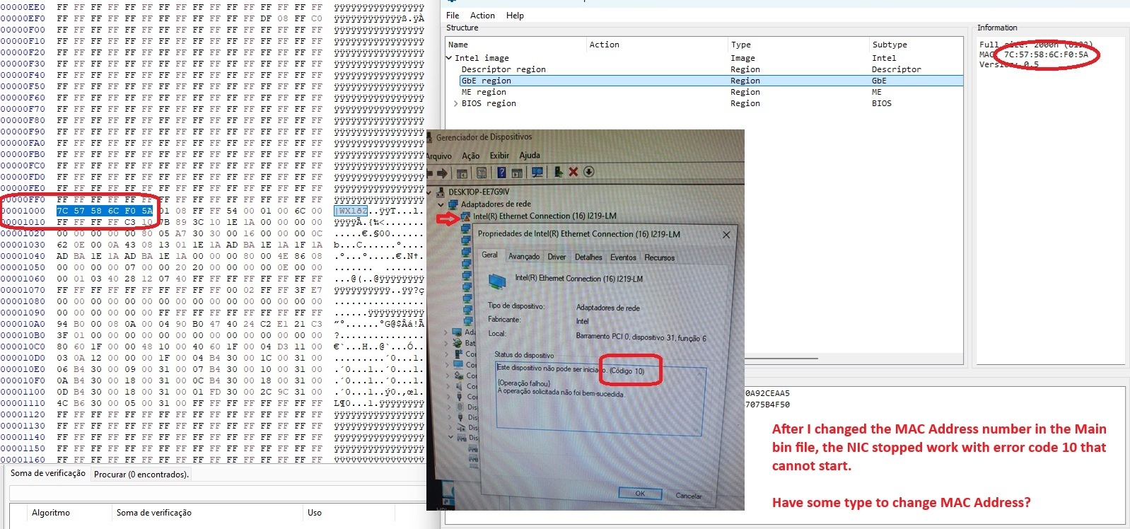

                            #474
                            Originally posted by rex98
                            I noticed there's a lot of unlock request for this model HP EliteBook 640 14 inch G9
                            The patch won't work if the bios version is latest. use this bin flash both it won't work if you only flash the main you should Flash Both.
                            first boot press f10 apply factory defaults and restart, 2nd boot reset security settings to defaults and exit.
                            use BCU and put your original DMI.
                            frequently asked questions:
                            can i use this to my HP EliteBook 640 14 inch G9- yes
                            This is the both BID U75 and U86 its all you need.
                            Please, someone could help me?
                            I used the below Main Bios + EC that rex98 shared for fix one Notebook Serial BRJ32683B7 HP 640 G9 with BIOS issues.
                            Files: HP EliteBook 640 14 inch G9 U75 CLEAN UNLOCKED MAIN+EC.zip
                            After applied these files Main+EC in the unit it Works very well, but I need change the MAC Address. And when I changed the line 1000 of Main BIN file with new MAC Address and re-applied these files in the Main + EC Chip the NIC stoped works with erro code 10.
                            Attached the Picture.
                            Best Regards,
                            Vilmar​

                              #475
                              Best Regards,
                              Vilmar
                              Post your BIOS dump that actually working right now in your laptop and the MAC address what you want to have.
                              I will try to fix it.

                                #476
                                Hello, Stefan!
                                Thanks a million.
                                The Main+EC Bin files that worked fine are from the below link that I download.
                                Files download: https://www.badcaps.net/filedata/fetch?id=3672350
                                - HP EliteBook 640 14 inch G9 U75 CLEAN UNLOCKED MAIN+EC.zip (26.59 MB, 89 views)
                                I want chage the MAC Address 7C:57:58:6C:F0:5A from these BIN to my MAC Address: 48:CA:84:9B:FE:AC
                                Have a great day!
                                Vilmar
                                • Stefan Steff
                                  • Mar 2024
                                  • 401
                                  • Romania
                                  #477
                                  Hello, Stefan!
                                  Thanks a million.
                                  Have a great day!
                                  Vilmar
                                  Here you go...
                                  • vilmar27@hotmail.com
                                    • May 2023
                                    • 44
                                    • Brasil
                                    #478
                                    Here you go...
                                    Thanks a million! I'll test it later today.
