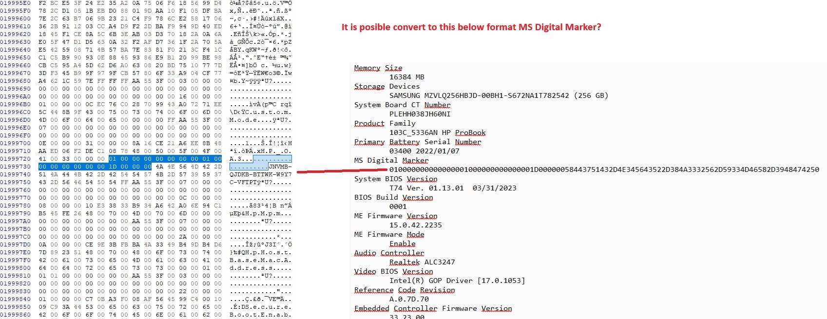

        • vilmar27@hotmail.com
          • May 2023
          • 44
          • Brasil
          #484
          Originally posted by Stefan Steff
          You need to recalculate the CRC word (last two bytes) of the modified Gbe region after changing the MAC address bytes.
          The Checksum word (Word 0x3F, NVM bytes 0x7E and 0x7F) is used to ensure that the base NVM image is a valid image. The value of this word should be calculated such that after adding all the words (0x00- 0x3F) / bytes (0x00-0x7F), including the Checksum word itself, the sum should be 0xBABA. The initial value in the 16 bit summing register should be 0x0000 and the carry bit should be ignored after each addition.
          Hello, Sfefan!
          Again thanks a lot for help and explanation.
          Please, have you some tools or easy type to recalculate the CRC and update the BIOS BIN file with changed MAC Address? (I tried to use the UEFI_Tools NE to extract the Gbe Region, change with Phyton acript attached, and after Rebiuld again, but is not easy....).
          Or if I change only first two digits of MAC Address is not necessary to recalculate the CRC?
          Example: From 7C:57:58:6C:F0:5A to 8C:57:58:6C:F0:5A (If I use this same BIN file to fix other unit I will need to change the MAC Address again to avoid conflit in the network enviorement).
          Best Regards,
          Vilmar
            • May 2023
            • 44
            • Brasil
            #485
            Please, I really apreciate if you can help me with one more information.
            I would like to save to reuse the Windows activation key from the old BIN file with issues so I can reinsert it later when tattoo with DMI after fix the System with new BIN file.
            In the line 01 00 00 00 00 00 00 00 01 00 00 00 00 00 00 00 1D 00 00 00, it’s possible to locate the activation key, but to write it along with the DMU using the HP BCU tool, it requires a different format with the MS Digital Marker. Is there a way to locate this MS Digital Marker key in BIN file or convert it to that format?
            Attached is a photo with the detail.
            Best Regards,
            Vilmar
