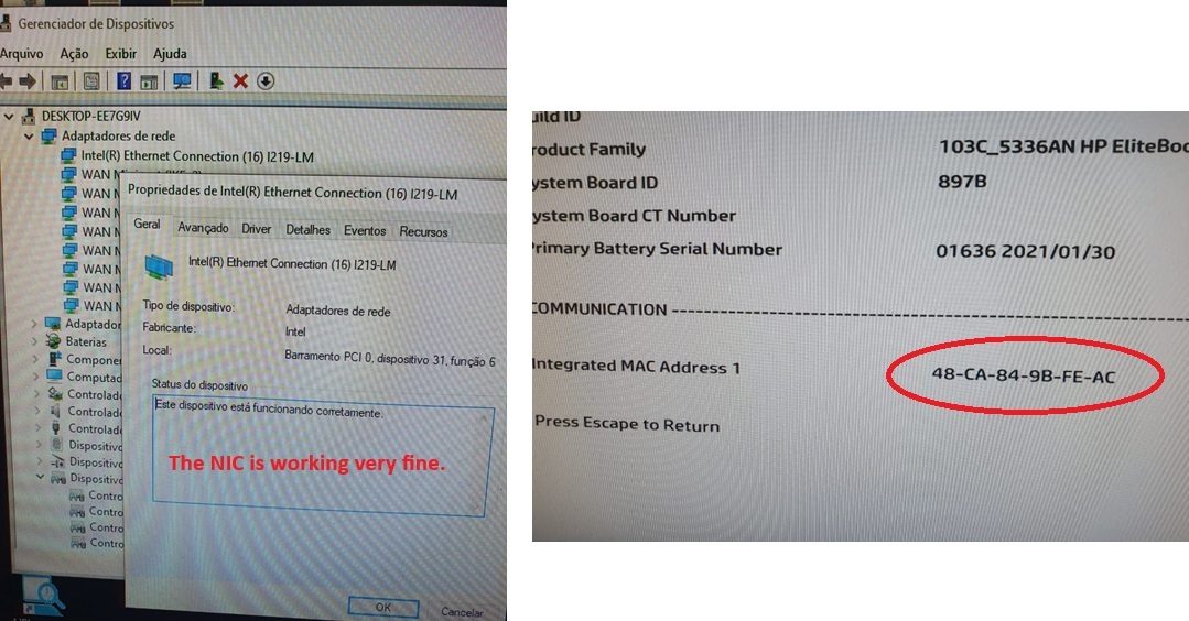

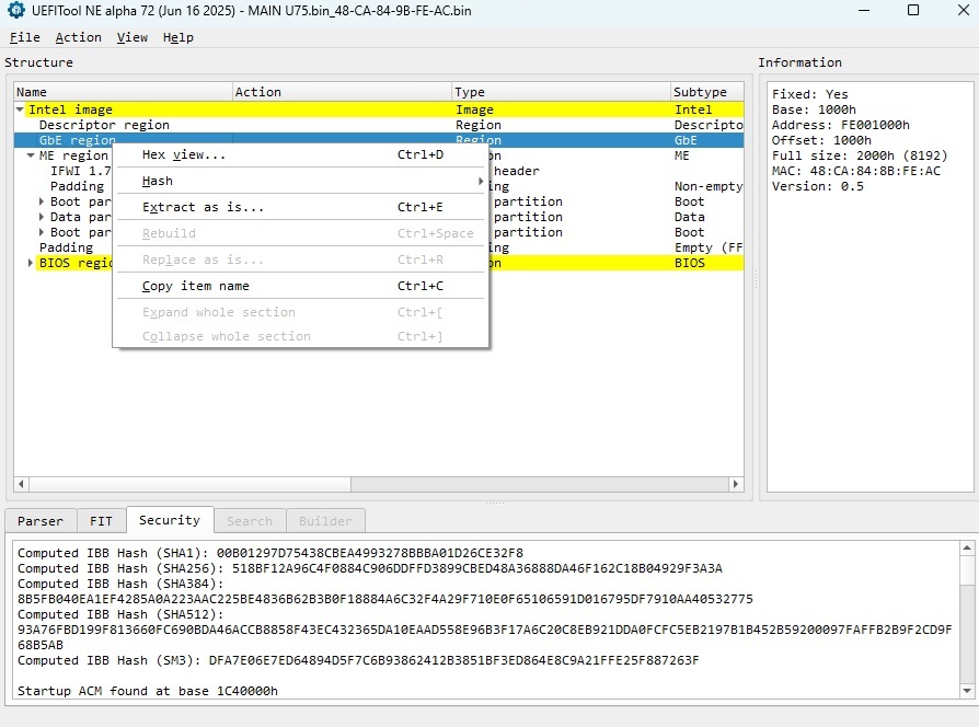

HP EliteBook 640 G9 Bios password
    commented on 's reply
    https://www.badcaps.net/forum/troubl...49#post3672349
  • rasta24
    replied
    Could you help me unlock the password please?
    hp elitebook 640 g9
    sn: 5cd3214qmb
    Leave a comment:
  • Stefan Steff
    replied
    Originally posted by dlareklami
    Thanks. You mean the AX211 or any other WiFi cards won’t ever work in this model? Even if there are no whitelist messages? I don’t get any errors on boot, it just behaves like there’s no card at all. Nothing in BIOS, diagnostics, or OS.
    I was only talking about what I had encountered so far...
    I'm 99.99% sure it's not a whitelist issue.
    Post your BIOS dump and maybe someone has the knowledge to check it and see if it's a way to enable your WiFi card.
    Leave a comment:
  • dlareklami
    replied
    Thanks. You mean the AX211 or any other WiFi cards won’t ever work in this model? Even if there are no whitelist messages? I don’t get any errors on boot, it just behaves like there’s no card at all. Nothing in BIOS, diagnostics, or OS.
    Leave a comment:
  • Stefan Steff
    replied
    Originally posted by dlareklami
    Hi everyone,
    I have an HP EliteBook 640 14-inch G9 Notebook PC (SKU: 4D0Y7AV, IDS Base Model) that was factory-built without a Wi-Fi/Bluetooth module.
    Now I need to use it with a standard Intel AX211NGW Wi-Fi 6E + Bluetooth 5.3 card, but the system doesn’t detect it at all, not in BIOS, not in HP Diagnostics, and not in the OS (Windows or Linux).
    BIOS Feature Byte: 476J65bB7B7H7M7Q7W7m7saBaEaFapqauawbhcA
    Build ID: 22WWRTCZ601#SABB#DABB
    System Board ID: 897B
    I’d like to request help to remove or bypass the WLAN whitelist / enable the WLAN interface in BIOS.
    I think that your WiFi card is not supported with or without whitelisting...
    If you have whitelisting problem then you must see some message at startup like:
    Wireless module not supported.
    The system has detected a Wireless module installed in the system is not supported. System halted. Please remove device and restart.
    Bluetooth Module ID (704)
    or
    Wireless module not supported.
    The system has detected a Wireless module installed in the system is not supported. System halted. Please remove device and restart.
    WLAN Module ID (702)​
    or something similar...
    Leave a comment:
  • peste
    commented on 's reply
    post merged...next time look for a thread with the name and model, motherboard model of the laptop, and post there, if you can't find it, then make a new thread..
  • dlareklami
    replied
    Hi everyone,
    I have an HP EliteBook 640 14-inch G9 Notebook PC (SKU: 4D0Y7AV, IDS Base Model) that was factory-built without a Wi-Fi/Bluetooth module.
    Now I need to use it with a standard Intel AX211NGW Wi-Fi 6E + Bluetooth 5.3 card, but the system doesn’t detect it at all, not in BIOS, not in HP Diagnostics, and not in the OS (Windows or Linux).
    BIOS Feature Byte: 476J65bB7B7H7M7Q7W7m7saBaEaFapqauawbhcA
    Build ID: 22WWRTCZ601#SABB#DABB
    System Board ID: 897B
    I’d like to request help to remove or bypass the WLAN whitelist / enable the WLAN interface in BIOS.
    Leave a comment:
  • adamgouadma
    replied
    Originally posted by rex98
    I noticed there's a lot of unlock request for this model HP EliteBook 640 14 inch G9
    The patch won't work if the bios version is latest. use this bin flash both it won't work if you only flash the main you should Flash Both.
    first boot press f10 apply factory defaults and restart, 2nd boot reset security settings to defaults and exit.
    use BCU and put your original DMI.
    frequently asked questions:
    can i use this to my HP EliteBook 640 14 inch G9- yes
    This is the both BID U75 and U86 its all you need.
    Thank you, you are brilliant
    Leave a comment:
  • vilmar27@hotmail.com
    replied
    Please, I really apreciate if you can help me with one more information.
    I would like to save to reuse the Windows activation key from the old BIN file with issues so I can reinsert it later when tattoo with DMI after fix the System with new BIN file.
    In the line 01 00 00 00 00 00 00 00 01 00 00 00 00 00 00 00 1D 00 00 00, it’s possible to locate the activation key, but to write it along with the DMU using the HP BCU tool, it requires a different format with the MS Digital Marker. Is there a way to locate this MS Digital Marker key in BIN file or convert it to that format?
    Attached is a photo with the detail.
    Best Regards,
    Vilmar
    Leave a comment:
  • vilmar27@hotmail.com
    replied
    Originally posted by Stefan Steff
    You need to recalculate the CRC word (last two bytes) of the modified Gbe region after changing the MAC address bytes.
    The Checksum word (Word 0x3F, NVM bytes 0x7E and 0x7F) is used to ensure that the base NVM image is a valid image. The value of this word should be calculated such that after adding all the words (0x00- 0x3F) / bytes (0x00-0x7F), including the Checksum word itself, the sum should be 0xBABA. The initial value in the 16 bit summing register should be 0x0000 and the carry bit should be ignored after each addition.
    Hello, Sfefan!
    Again thanks a lot for help and explanation.
    Please, have you some tools or easy type to recalculate the CRC and update the BIOS BIN file with changed MAC Address? (I tried to use the UEFI_Tools NE to extract the Gbe Region, change with Phyton acript attached, and after Rebiuld again, but is not easy....).
    Or if I change only first two digits of MAC Address is not necessary to recalculate the CRC?
    Example: From 7C:57:58:6C:F0:5A to 8C:57:58:6C:F0:5A (If I use this same BIN file to fix other unit I will need to change the MAC Address again to avoid conflit in the network enviorement).
    Best Regards,
    Vilmar
    Leave a comment:
  • Stefan Steff
    replied
    Originally posted by vilmar27@hotmail.com
    Hi, Stefan!
    I would like to express my sincere gratitude for you help. After applying the modified BIN file, the onboard network card is now functioning perfectly😁
    Please, I would be very grateful if you could explain what other changes are necessary—besides modifying the MAC address at line 00001000 for the NIC to work properly when I change the MAC address?
    Best regards,
    Vilmar
    You need to recalculate the CRC word (last two bytes) of the modified Gbe region after changing the MAC address bytes.
    The Checksum word (Word 0x3F, NVM bytes 0x7E and 0x7F) is used to ensure that the base NVM image is a valid image. The value of this word should be calculated such that after adding all the words (0x00- 0x3F) / bytes (0x00-0x7F), including the Checksum word itself, the sum should be 0xBABA. The initial value in the 16 bit summing register should be 0x0000 and the carry bit should be ignored after each addition.
    Leave a comment:
  • Radny Canoy
    replied
    Originally posted by danito
    try
    Work like a Charm boss, Thank you so much, very much appreciated.
    password is gone and company boot splash gone too, just a little work for DMI.
    once again, thank You Sir!
    Leave a comment:
  • vilmar27@hotmail.com
    replied
    Originally posted by Stefan Steff
    Here you go...
    Hi, Stefan!
    I would like to express my sincere gratitude for you help. After applying the modified BIN file, the onboard network card is now functioning perfectly😁
    Please, I would be very grateful if you could explain what other changes are necessary—besides modifying the MAC address at line 00001000 for the NIC to work properly when I change the MAC address?
    Best regards,
    Vilmar
    Leave a comment:
  • danito
    replied
    Originally posted by Radny Canoy
    Good Day everyone.. i hope someone will help.
    it has Bios Password and company Splash Logo.
    any help is much Appreciated.
    HP EliteBook 640 G9
    SN: 5CD3221GNH
    PID: 7P955PC#UUF
    Attached is the Main Bios
    try
    Leave a comment:
  • Radny Canoy
    replied
    Good Day everyone.. i hope someone will help.
    it has Bios Password and company Splash Logo.
    any help is much Appreciated.
    HP EliteBook 640 G9
    SN: 5CD3221GNH
    PID: 7P955PC#UUF
    Attached is the Main Bios
    Leave a comment:
  • vilmar27@hotmail.com
    replied
    Originally posted by Stefan Steff
    Here you go...
    Thanks a million! I'll test it later today.
    Leave a comment:
  • Stefan Steff
    replied
    Originally posted by vilmar27@hotmail.com
    Hello, Stefan!
    Thanks a million.
    The Main+EC Bin files that worked fine are from the below link that I download.
    Files download: https://www.badcaps.net/filedata/fetch?id=3672350
    - HP EliteBook 640 14 inch G9 U75 CLEAN UNLOCKED MAIN+EC.zip (26.59 MB, 89 views)
    I want chage the MAC Address 7C:57:58:6C:F0:5A from these BIN to my MAC Address: 48:CA:84:9B:FE:AC
    Have a great day!
    Vilmar
    Here you go...
    Leave a comment:
  • vilmar27@hotmail.com
    replied
    Originally posted by Stefan Steff
    Post your BIOS dump that actually working right now in your laptop and the MAC address what you want to have.
    I will try to fix it.
    Hello, Stefan!
    Thanks a million.
    The Main+EC Bin files that worked fine are from the below link that I download.
    Files download: https://www.badcaps.net/filedata/fetch?id=3672350
    - HP EliteBook 640 14 inch G9 U75 CLEAN UNLOCKED MAIN+EC.zip (26.59 MB, 89 views)
    I want chage the MAC Address 7C:57:58:6C:F0:5A from these BIN to my MAC Address: 48:CA:84:9B:FE:AC
    Have a great day!
    Vilmar
    Leave a comment:
  • Stefan Steff
    replied
    Originally posted by vilmar27@hotmail.com
    Please, someone could help me?
    I used the below Main Bios + EC that rex98 shared for fix one Notebook Serial BRJ32683B7 HP 640 G9 with BIOS issues.
    Files: HP EliteBook 640 14 inch G9 U75 CLEAN UNLOCKED MAIN+EC.zip
    After applied these files Main+EC in the unit it Works very well, but I need change the MAC Address. And when I changed the line 1000 of Main BIN file with new MAC Address and re-applied these files in the Main + EC Chip the NIC stoped works with erro code 10.
    Attached the Picture.
    Best Regards,
    Vilmar
    Post your BIOS dump that actually working right now in your laptop and the MAC address what you want to have.
    I will try to fix it.
    Leave a comment:
  • vilmar27@hotmail.com
    replied
    Originally posted by rex98
    I noticed there's a lot of unlock request for this model HP EliteBook 640 14 inch G9
    The patch won't work if the bios version is latest. use this bin flash both it won't work if you only flash the main you should Flash Both.
    first boot press f10 apply factory defaults and restart, 2nd boot reset security settings to defaults and exit.
    use BCU and put your original DMI.
    frequently asked questions:
    can i use this to my HP EliteBook 640 14 inch G9- yes
    This is the both BID U75 and U86 its all you need.
    Please, someone could help me?
    I used the below Main Bios + EC that rex98 shared for fix one Notebook Serial BRJ32683B7 HP 640 G9 with BIOS issues.
    Files: HP EliteBook 640 14 inch G9 U75 CLEAN UNLOCKED MAIN+EC.zip
    After applied these files Main+EC in the unit it Works very well, but I need change the MAC Address. And when I changed the line 1000 of Main BIN file with new MAC Address and re-applied these files in the Main + EC Chip the NIC stoped works with erro code 10.
    Attached the Picture.
    Best Regards,
    Vilmar​
    Leave a comment:
  • zenius
    by zenius
    12-08-2024, 06:13 AM
  • traxformania
    TONGFANG "GM7TG7P" Bios Password Problem?
    by traxformania
    I'm using TONGFANG "GM7TG7P" model laptop for over 3 years and i'm entering the same bios administrator password everyday. My laptop has Aptio BIOS (American Megatrends, AMI).
    But today it's not accepting my password. I'm %100 sure i'm entering the correct password.
    I'm trying to reset my bios without success.
    I tried :
    -I removed the BIOS battery and main battery. Waited for a long time but it didn't work. They already stated in the user manual that the password will not be reset even if the batteries...
    11-15-2023, 07:32 AM
  • tlindi
    Toughbook CF-18KHH65LE (Customer Special Configuration) Supervisor Password needed remove HDD locking and BIOS Access ...
    by tlindi
    Sublect line continuation: ... Jaguar IDS PC aka Panasonic
    >Read BIOS guides, methods, resources and tools
    Ack
    >Try the method at BIOS guides, methods, resources and tools before requesting help
    Ack
    >Explain you were not able to succeed with the methods at BIOS guides, methods, resources and tools
    python ./main.py "/mnt/c/temp/205605f9e1b60403a41787efeffe9cad-flas_maybe5.BIN" --output-dir "/mnt/c/temp/205605f9e1b60403a41787efeffe9cad-flas_maybe5.txt"
    01-30-2025, 04:26 AM
  • Nopslide
    HP Omen 15-dh0052nf power-on & bios password
    by Nopslide
    Hello everyone, I come here to tell you my problem regarding the power-on password. It is not a bios reset demand, and i can't have any access to windows. This is the bios and power-on password that is blocking all other things.
    My Omen 15-dh0052nf purchased second-hand was configured with the bios password upon purchase (very simple password :P ).
    Having decided to sell it in order to get something more powerful, I reset all BIOS settings and set a blank administrator password. But the power-on password cannot be changed to a blank one so I let the actual password set....
    04-01-2024, 04:27 PM
  • Wutru
    HP Elitebook 820 G4 BIOS repair assistance required
    by Wutru
    Hi guys,
    If someone would be able to provide some expertise, I'd be very grateful.
    BIOS Corruption - Cause
    So I managed to corrupt my machine by installing linux and enrolling custom secure boot keys. I did choose to enroll the Microsoft keys as well, to prevent any potential bricking due to 3rd party drivers from HP being signed with those keys.
    After doing that, and rebooting(it did boot, powerLED, fanspin etc.), the laptop did not give any video output on the LCD or video connectors. I think I was able to get in BIOS and trigger the beeper by pressing ESC....
    09-06-2025, 10:32 AM
