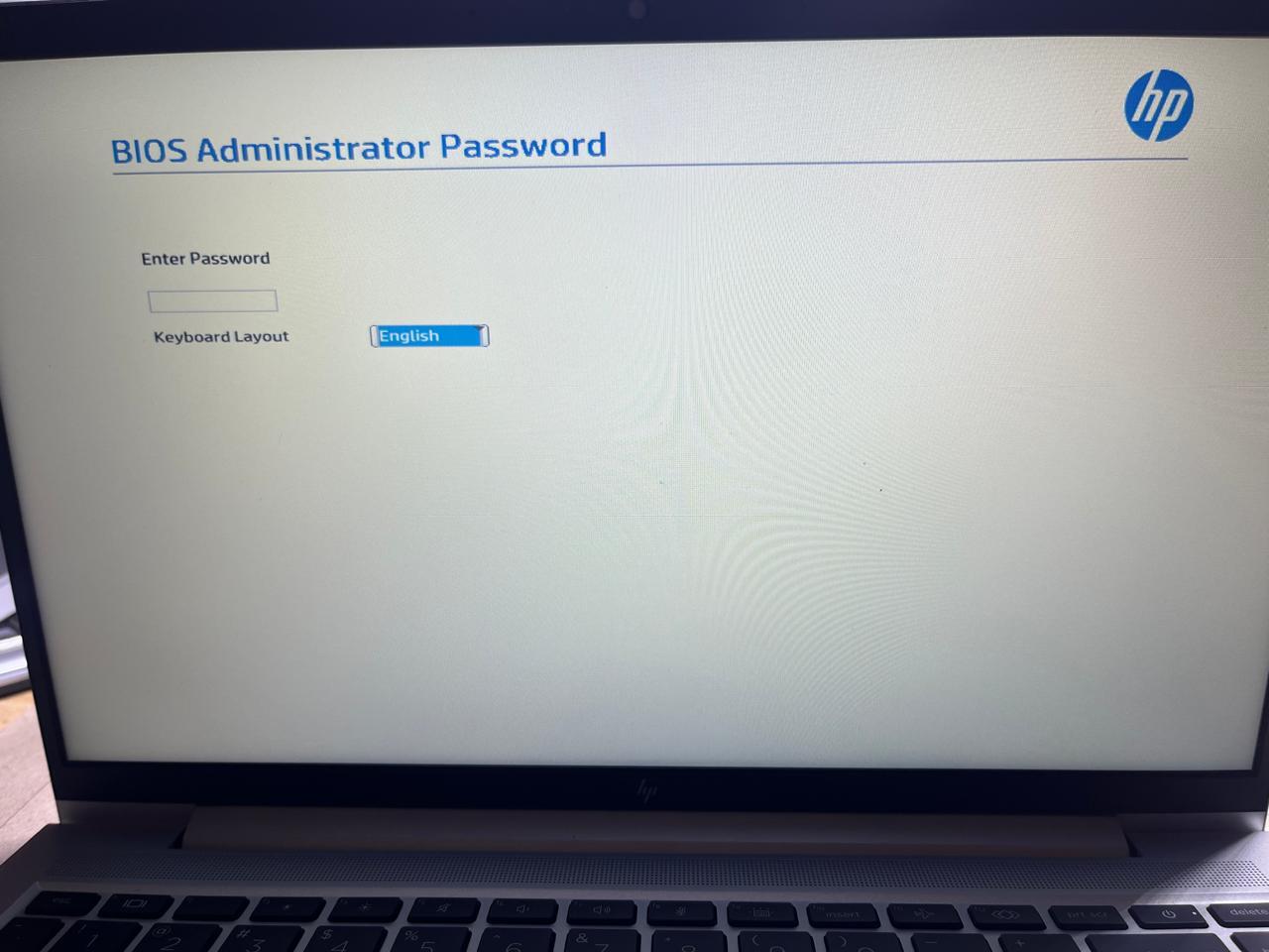

                Still locked, first screen is giving me this....anyhelp?

                  Now use rex98 Bios at post number #355.
                  Good luck

                    No LUCK from post #355(rex98)

                      Did you flash both main and Ec with rex solution !!
                      Did you follow his steps!!

                        Yes, flashed both, its even not displaying

                          i'm sorry it didn't work coz i haven't noticed its a two bios version for this model. its U75 and U86.
                          the post number # 355 is U86
                          this is the new one for U75
                          HP EliteBook 640 14 inch G9 U75
                          The patch won't work if the bios version is latest. use this bin flash both it won't work if you only flash the main you should Flash Both.
                          first boot press f10 apply factory defaults and restart, 2nd boot reset security settings to defaults and exit.
                          use BCU and put your original DMI.​

                                opps i'm sorry post # 355 should be deleted the EC file i sent is wrong i haven't noticed. thats why it didn't work. i'll create a new one now.

                                  Here use this its the new BID U86.
                                  HP EliteBook 640 14 inch G9 U86

                                          Ok, flashed both SPI and EC using the files from rex98 at #412 and it worked. Thanks!
