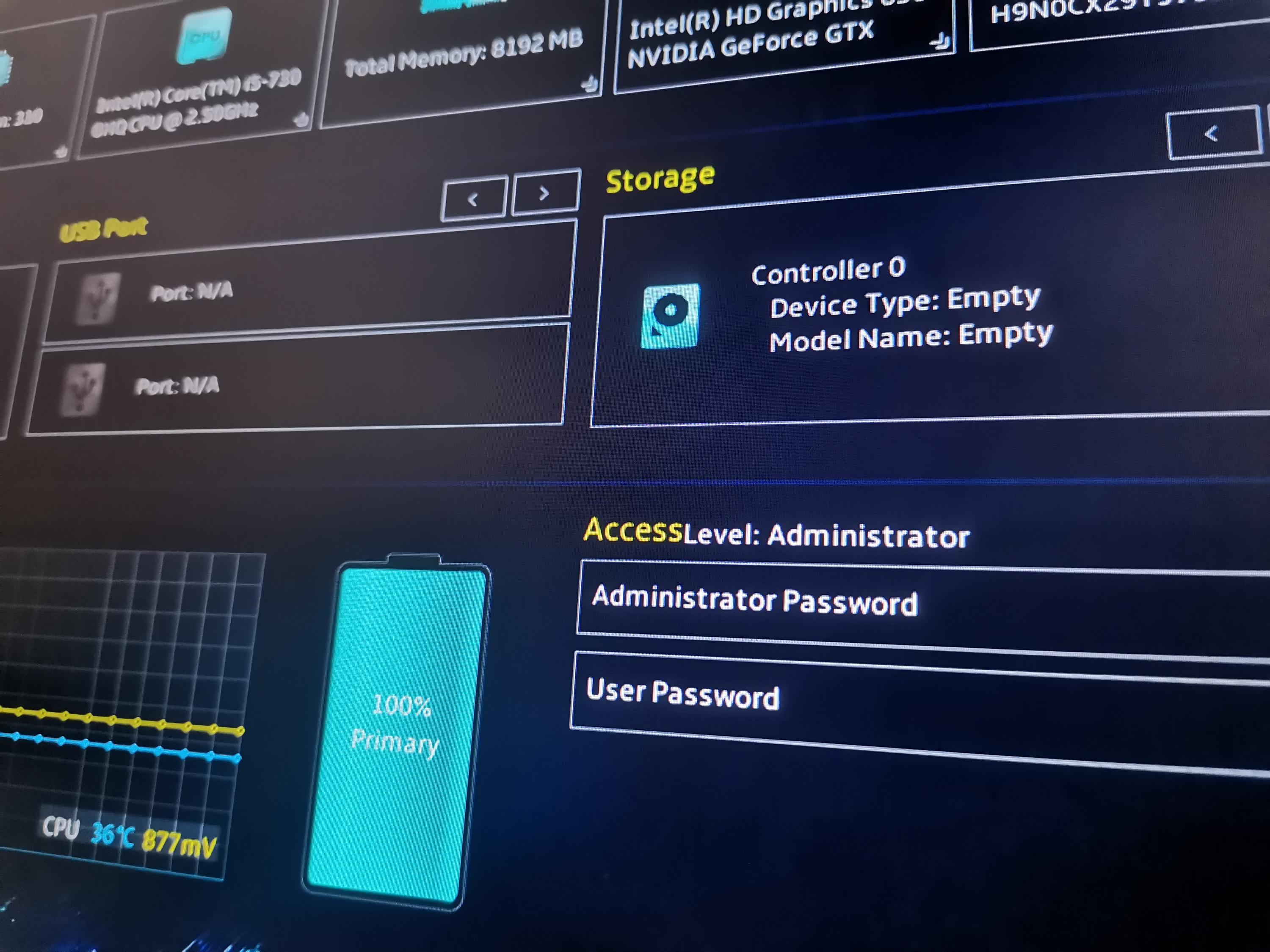

    Hi guys, I've got an Asus GL503V that does not turn on when using battery but works perfectly using adapter.
    It came in with no power. I resolved the issue by replacing 2 mosfets PQ21, PQ22 and an mlcc 10uf 25v on +VIN_VCCGFX_CORE line.
    When I power up the laptop, BIOS detects battery and shows 100%. It's the same when booting up on windows, It shows 100% on taskbar. Despite that still can't turn on using battery.
    When adapter is inserted, PCN2 connector pins 1,2 and 3 shows random voltage between 2.6v to 4.6v constantly changing. When battery and adapter is inserted, I only get 0.20v on pins 1,2 and 3 of PCN2 connector.
    Can you guys give any idea as to where I should check next?
    I don't have schematic for this but I uploaded boardview. Hope someone checks. Thanks

    I still haven't found any solution to this. I replaced charging IC BQ24780s 3 times. I also replaced PQ82. All surrounding components on PU15 was also checked and found nothing faulty. I even replaced PQ26 and PQ27 just to make sure, but still battery wont charge and voltage on P_MBAT pins 1,2 and 3 is fluctuating. What else could I possibly miss??? I'm beginning to realize that I may not found a fix for this... Hope someone takes a glimpse. Thanks.
    PS laptop works perfectly fine, I just cant charge the battery.

          What hapends if you unplug the charger while laptop is working? (with battery attached)
          BAT+ voltage stable?
          PR505 and PR506 resistence ok?

            Re: Asus GL503V does not power on battery
            @myth77
            Laptop turns off immediately after removing charger with battery connected.
            At B+ I get random voltage between 5v to 8v. Its like ticking with 1 second interval. This happens without battery. If battery is attached I get 0v on B+
            PR505 and PR506 resistance is ok (220k ohm)
            I got 3.3v on CLK and DATA on PCN2 connector.
            I get 100% battery in Bios pls check image. Thanks

                        Give us measurements of BQ24780S pins and we'll help you sort it out. Without any measurements, no one can help. Mentioning only symptoms dont help in technical resolution.
