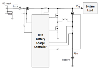

    In a Hybrid Power Boost configuration, the synchronous buck converter runs as a normal buck converter when the adapter provides power to the system and is charging the battery. When the adapter power is not sufficient, the synchronous buck converter runs in reverse to boost the battery voltage to around 20V. Thus the battery supplements the adapter whenever the adapter power is not sufficient. This requires no circuit changes from a traditional adapter.
    The change is required in the control circuit (the battery charger controller). The advantage of this system over a traditional charger is that the battery is able to assist the adapter during turbo workloads. This system has the disadvantage that the light load efficiency is pretty low as it is difficult to achieve high light load efficiency at high input voltage.
    In this design, the system is fed from the AC adapter, and a MOSFET (we will call it battery-to-system MOSFET) allows the current to flow from the battery to the system when on battery only, while prevent current from flowing directly from the AC adapter to the battery when AC adapter is plugged in.
    Therefore, when on AC adapter, the main power rail voltage will be the voltage provided by the AC adapter. In general this voltage is between 19V and 20V. A few machines use 12V or 16V.
    When on battery, the main power rail voltage will be the voltage provided by the battery. This depends on the number of cells in series in the battery and the state of charge, but it is lower than 19V. (see Battery voltage section)

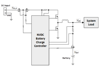

    1.3. Narrow VDC design
    https://en-support.renesas.com/knowledgeBase/6680047
    Originally posted by Renesas
    This figure shows the Narrow VDC (NVDC) topology. Here, the system bus (Vsys) is not connected directly to the adapter. It is connected to the output of the buck converter. Hence, NVDC operates only as a buck converter, both when NVDC charges the battery and when the battery supplements the adapter and provides power to the system. NVDC implementation reduces the switch-over period between the charging mode and the hybrid power mode. NVDC implementation allows the system to minimize the period of overloading the input power source when CPU is in Turbo Boost mode.
    The advantage of using the NVDC system is that the overall system efficiency is better compared to the Hybrid Power Boost (HPB) charger. The system can be designed for a smaller voltage rating since the system has a lower Vin. The disadvantage is that the charger components’ size and power dissipation increases.
    In this design, the system is fed directly from the battery charging rail. The voltage on the main power rail is always close to the voltage on the battery. (see Battery voltage section)

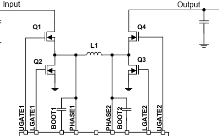

    1.5. Buck-Boost converter
    A synchronous 4-switch buck-boost converter uses a first set of high-side and low-side MOSFETs before the inductor. They can act as a regular buck converter to step down the voltage coming from the AC adapter. There's a second set of MOSFETs after the inductor, they are used as a boost converter to step up the voltage coming from the AC adapter.
    That way, the machine can take 5V to 20V from an USB-C charger and still be able to charge the battery. Of course, with only 5V as the input, the power will be lower than with 20V, so the battery will charge slower and the laptop may not turn on without battery or when the battery is discharged.
    (From ISL9238 datasheet)

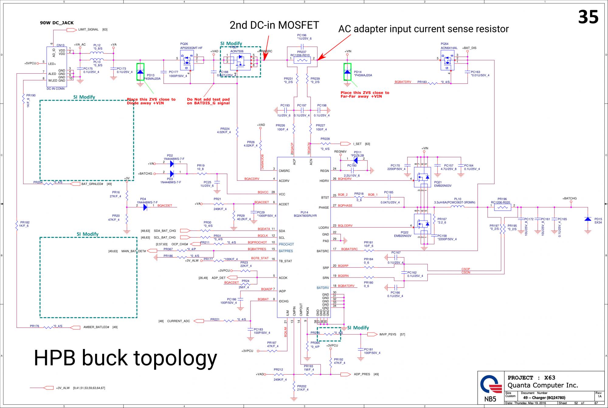

    • With an HPB configuration you have to check the voltage after the 2nd DC-in MOSFET and after the current sensing resistor for AC adapter power input. You are supposed to find the AC adapter voltage.
      (from Quanta X63 schematics)

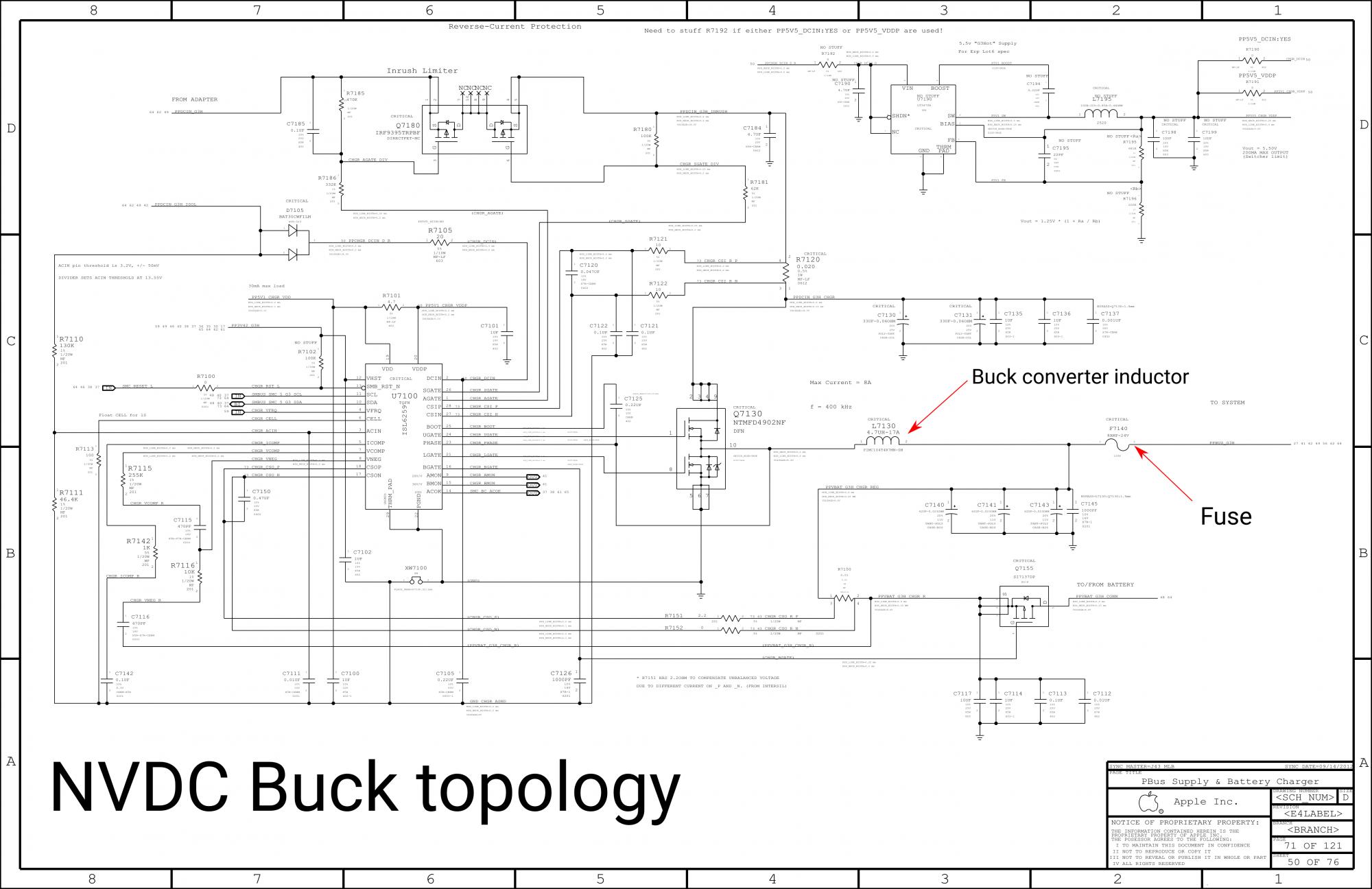

      • If it's a buck converter you have to check the voltage after the buck converter inductor and after the fuse if it exists.
        (from Apple 820-00165 schematics)

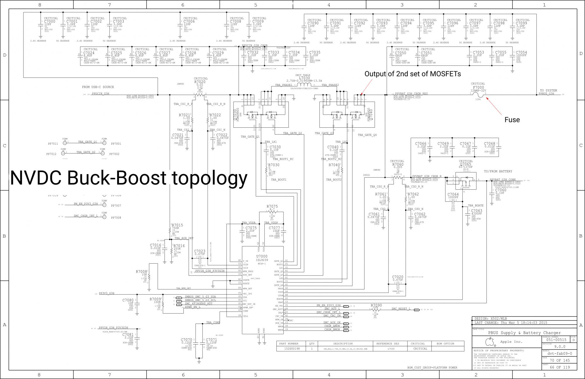

      • If it's a buck-boost converter you have to check the voltage at the output of the 2nd set of MOSFETs and after the fuse if it exists.
        (from Apple 820-00239 schematics)

    2.1.1. Burnt fuse
    You found voltage before the fuse (after the buck converter output inductor or buck-boost 2nd set of MOSFETs), but not after it: fuse is blown. Replace it and go to the next section "Short to ground on main power rail". Don't apply power before resolving the short to ground.

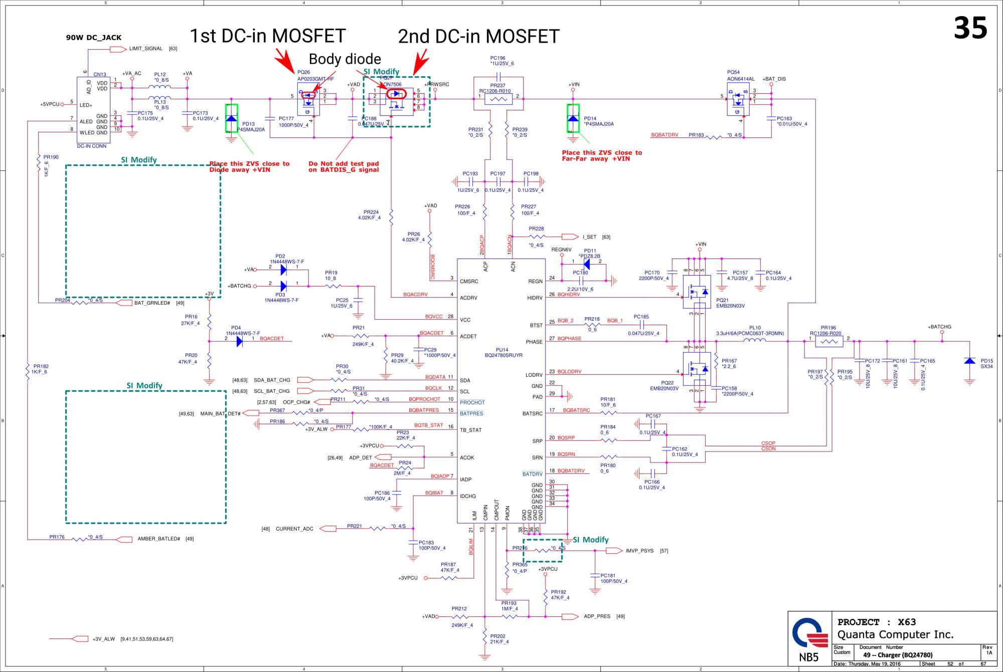

    2.1.3. Shorted DC-in MOSFET
    This is the second most common issue. What is troubling for beginners here is that the MOSFET that is blocking the current is *not* the MOSFET that has failed.
    What happens here is that the MOSFET that shorts is the one with the body diode in forward (in the illustration below, the 2nd one, note that they can be exchanged), not the one with the body diode in reverse.
    Effectively, the shorted MOSFET will have drain/source/gate connected together. Both DC-in MOSFET gates are also connected together. And Both DC-in MOSFET sources are connected together. So with gate/source of DC-in MOSFET in forward bias shorted, it also causes gate/source of the DC-in MOSFET in reverse bias to be shorted. This MOSFET is therefore turned off permanently, not letting the current through.
    The other MOSFET could also be shorted, in the case of an HPB topology the main power rail will be present since current will flow through the shorted MOSFET and through the body diode of the other MOSFET, but some signal from the charger IC might be missing causing the platform not to turn on. In an NVDC topology the main power might be missing.
    Simply check resistance between drain/source/gate of both DC-in MOSFETs to confirm they are not shorted. It should show at least several kohms.

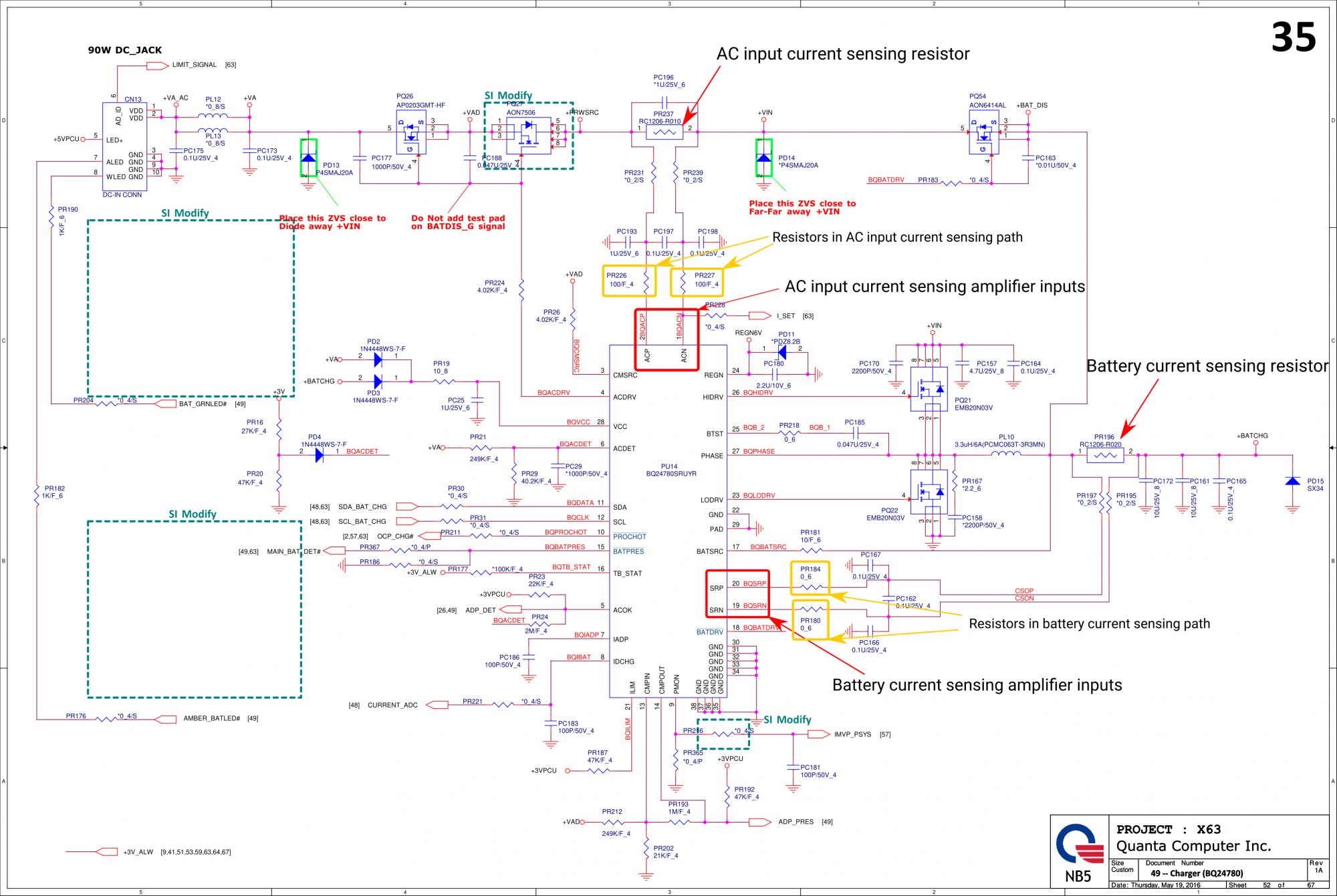

    2.1.4. Burnt current sensing lines
    The charger IC also monitors the current flowing from the AC adapter, and from/to the battery to prevent overcurrent conditions. It can happen that the current sensing circuits get burnt, either the current sensing resistors themselves or the resistors that connect them to the current sensing amplifier inputs of the charger IC.
    Easiest way is to measure resistance directly across the pins of the current sensing amplifier inputs of the charger IC. The measured resistance should be the sum of the current sensing resistors, and the resistors that connect it to the charger IC. This also accounts for a possible break in the line that could be caused by liquid damage for example.

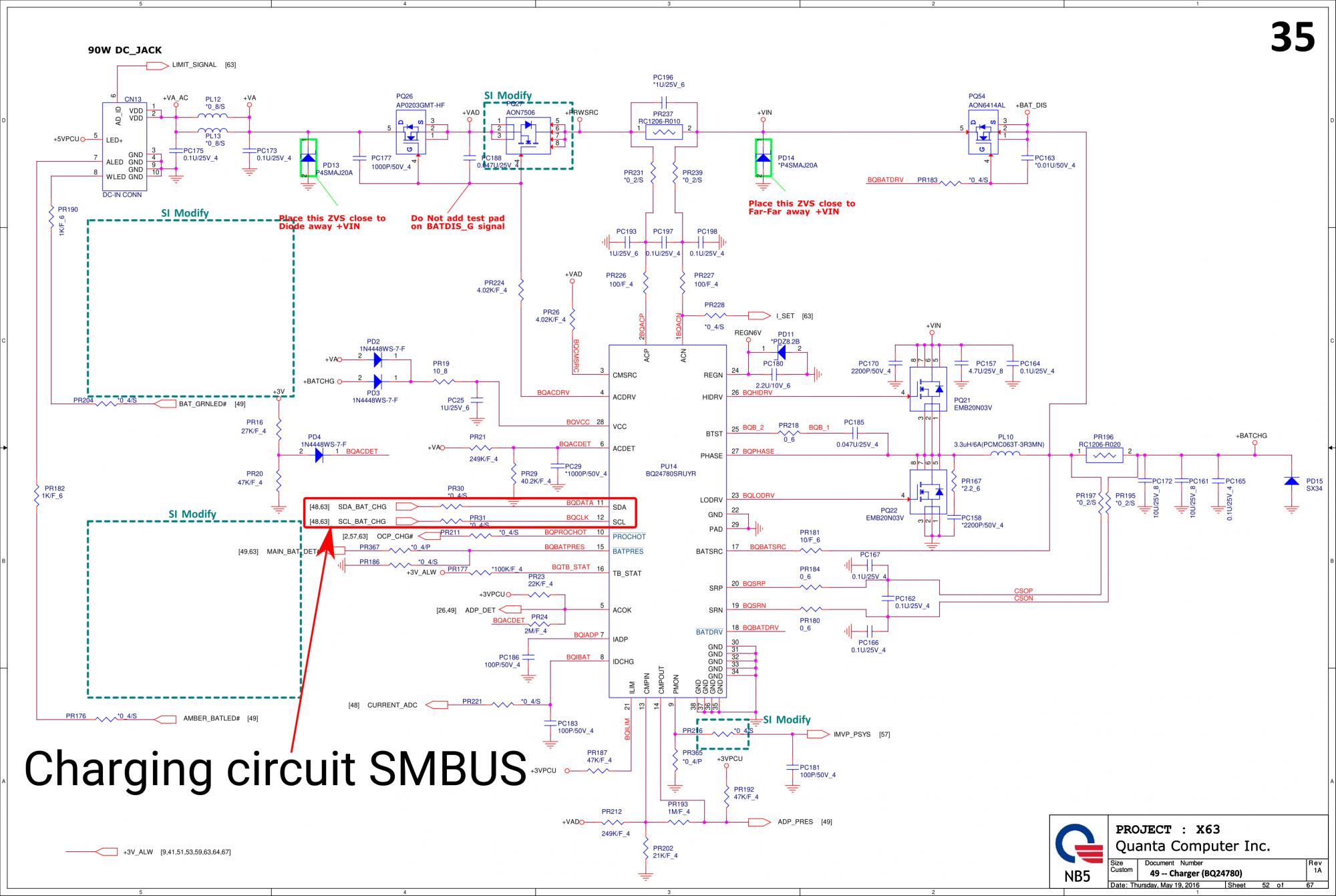

    2.2.2. Battery not detected
    Issue on charging circuit SMBUS.
    Check voltage and diode mode to ground on charging circuit SMBUS SDA and SCL lines

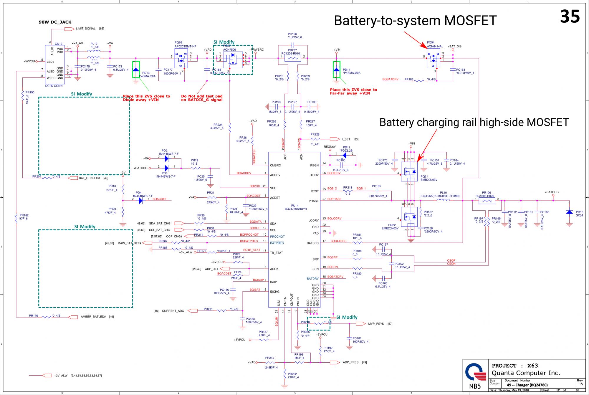

    2.2.4. High voltage on battery charging rail
    It could be a shorted high-side MOSFET on the buck converter for the battery charging rail.
    In the case of HPB toplogy, it can also be a shorted battery-to-system MOSFET.
    Some charger IC have a "CELL" pin to control the default voltage to apply to a battery relative to its number of cells in series. Wrong setting can cause wrong voltage.
