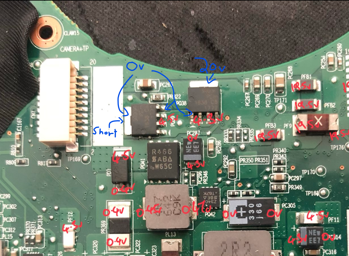

    Originally posted by techtiger
    if you are sure of the chaging IC is ISL95520HRZ then test pin 1 2 30 31 32 ACIN is pin 1 (+19V) & GATE PASS is pin 30(+20-25V) your fist 2 FETS are N-CHANNEL what are the Reading of the 2 fets S G D ? dont remove components if you are not sure for father damage !
    techtiger here are the values for pins on ISL95520HRZ
    1 - 3.195
    2 - nothing as far as I can see, not OL or 0v just nothing, numbers on my MM bounce, I note it traces back to a resistor adjacent, the same behaviour here also
    30 - 4.63
    31 - 4.25 - 4.52
    32 - 4.25 - 4.52

      [QUOTE=Themi;980333]When mosfets were attached to board these were the values:
      mosfet closest to DCIN
      D - 19.52v
      S - 4.3v
      G - 4.25 - 4.52v
      mosfet furthest from DCIN
      D - 4.25 - 4.52v
      S - 4.5v
      G - 4.25 - 4.52v
      Removed both mosfets from board and found mosfet furthest from DCIN is faulty after testing with diode mode on multi meter.]
      what was the reading diode mode SOURCE DRAIN GATE ?

        [QUOTE=techtiger;980341]
        D - 19.52v
        S - 4.3v
        G - 4.25 - 4.52v
        D - 4.25 - 4.52v
        S - 4.5v
        G - 4.25 - 4.52v
        I will get these readings tomorrow after replacing faulty mosfet and replacing the other.
        Do I need to conduct the diode test (-) to ground and (+) to source, drain and gate?
        While mosfets are de-soldered, is it worth conducting any other tests directly to the pads?
          Thanks Spider.
          1 - 3.195
          30 - 4.63
          31 - 4.25 - 4.52
          32 - 4.25 - 4.52
          PIN 1 must be 19V from Dc jack PIN 2 ACOK should be 3.3V depends on the plateform 31 32 should be+19V CLR PIN 30 +20V
          pin 1 is connected with a brown cap what is the voltage on the other side this cap is connected VIA or direct to DCIN try to do a continuity test with MM
              Ok this is what I have so far.
              I cannot find continuity between pin 1 and a brown cap anywhere. Can you specify using one of my images in case I have missed it. I can only find continuity between PR136 (connected to pin 1) and DCIN (blue circles).
              Voltages from charge IC. Blue circle shows continuity probe point to second blue circle in below image.
              Voltages from area near DCIN. Continuity test from previous image to here ok. Note I have found a blown capacitor at PC260 near DCIN. Resistance across this blown cap is 60K.
              PC260 (blown)
              Resistance tests at IC
                ok then it's connected with the Blue circle resistor one side +19V other side 3V may be it's faulty or leaking remove it & check with MM , check the Ohms pin 1 of PU5, remove the
                blown capacitor PC260 no

                  Updates
                  Just want to say thanks to everyone who chimed in an helped me. Really appreciate it.
                  I managed to get everything back up and running.
                  I received the two mosfets and a replacement 100nF smd cap to replace the blow decoupling one near the DCIN.
                  I soldered then new stuff on and checked voltages. Everything came back, had my 5v, 3.3v and both mosfets were reading 19.5v at the sources. All the fuses were reading 19.5v also.
                  Tested the machine and everything was ok. Let it run on heaven benchmark for 30 min with no problems.
                  Thanks again all

                                        Sorry for gravedigging,
                                        I have the same laptop but instead of having voltage on the first two mosfets, I only get 20V on the drain of the first one.
                                        I get a short to ground on the drain of the second mosfet.
                                        Any idea?

                                          Flux and remove the 2nd mosfet. Then measure the resistance to ground again. No power to the logic board during these tests.
                                          Also review the above sticky by @Piernov on charger circuits.
