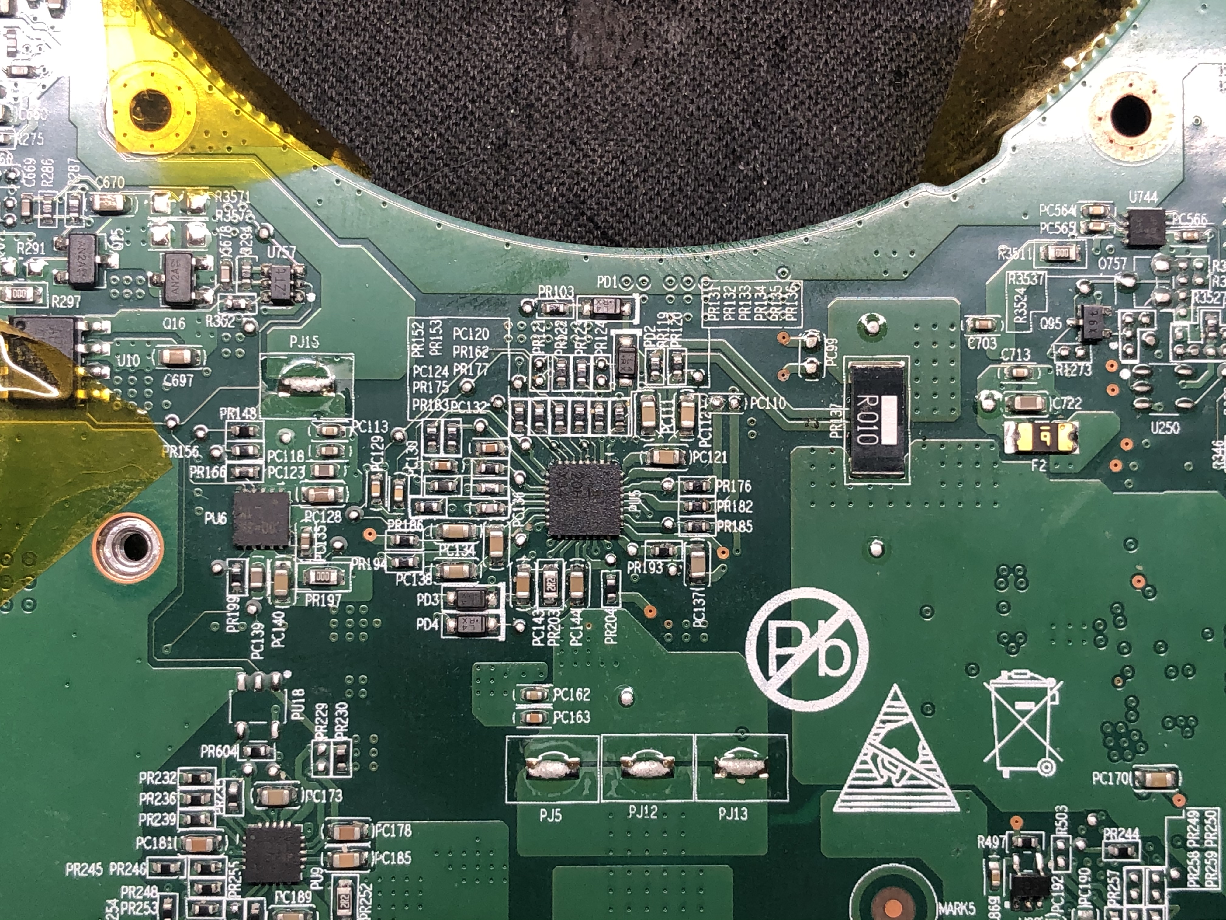

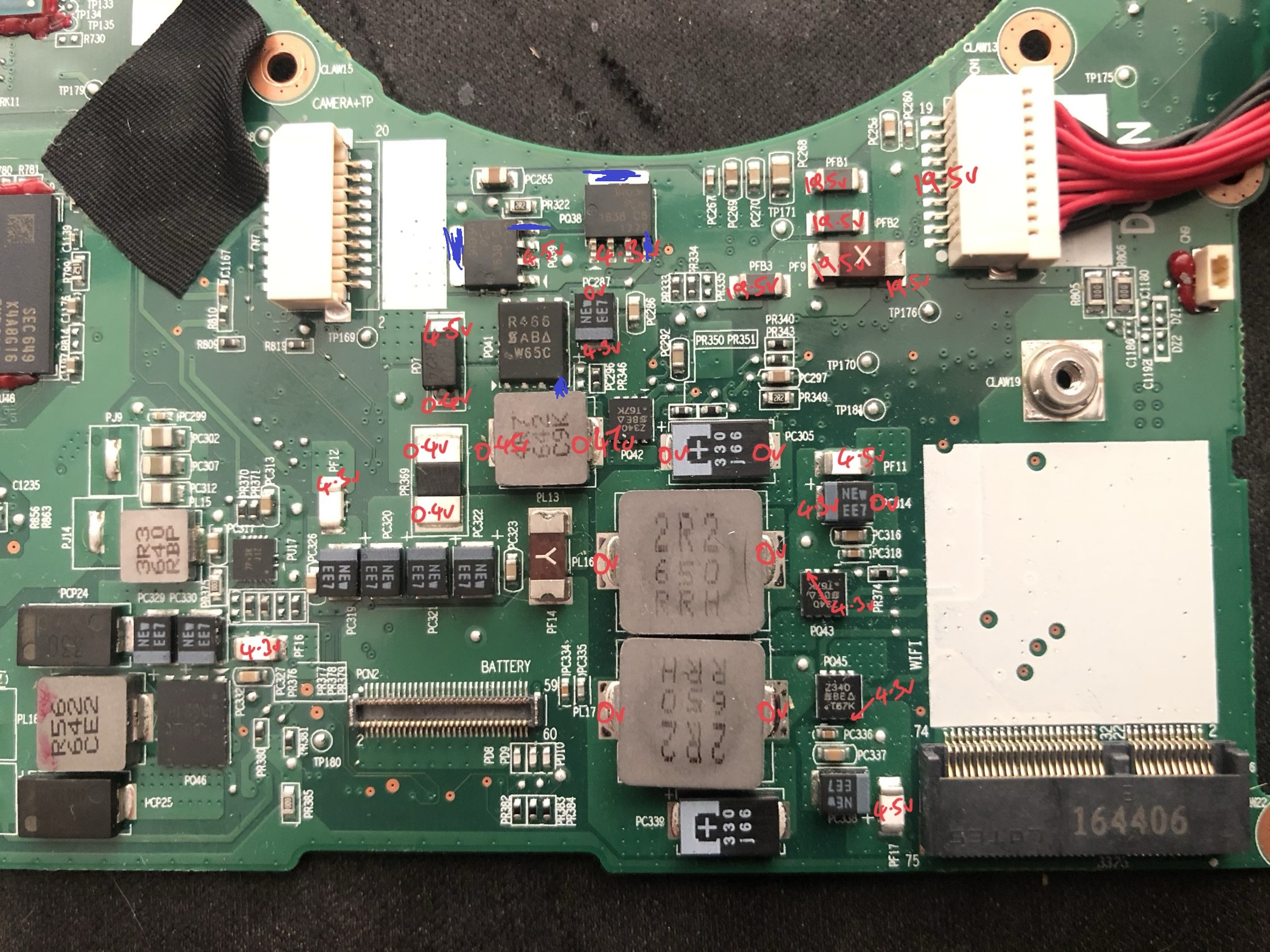

    I’ve got a Razer Blade 2017 RZ09-01953 with no power.
    I’ve done some multimeter reading and attached them in an image below.
    I’m aware I should be getting 3.3v and 5v at the two big coils/high power resistors (?) at bottom of the image near the DCIN connector but I have no voltage there at all.
    There’s continuity across all of the white board fuses
    Could anyone help me diagnose what could be wrong here.
    Happy to provide further readings / images.
    Many thanks

    Re: Razer Blade RZ09-01953 no power
    read volts on blue marked zone... also the 4th pin of that mosfet (gate)
    without power in diode mode check value on 4.5volt point, possible on first mosfet after 19v input.
      Can you explain this part to me again or visualise in drawing?
      Here are the other measurements

          Ok I think I measured the mosfetts the wrong way round.
          Here’s the updated readings
            black probe on gnd (ground) metal of usb or so on and red on pin (all without power connected
            taht mosfet.... first reply u measured... can u read it's code ?
            that one black on gnd red on pin 1-2-3 and 4
            look also for mainboard code... so we can search for schematic
            edit: 0.47 volt output make me think of a shorted capacitor... do you have lab psu ?

              Ok so codes from the board are:
              RZ09-01953W71-R3W1
              B6 NT
              BETTY R6_MB
              20161227
              20161228
              Codes from both mosfetts (both the same)
              3R030
              PEm
              1638 C6
              1772
              When I measure with no power to board and multimeter in diode mode, black probe to ground and red probe to each pin 1, 2, 3 then 4 on both mosfetts I get same readings for each mosfett.
              Starts at between 0.7-0.9v climbs gradually to 1.98v then displays .OL

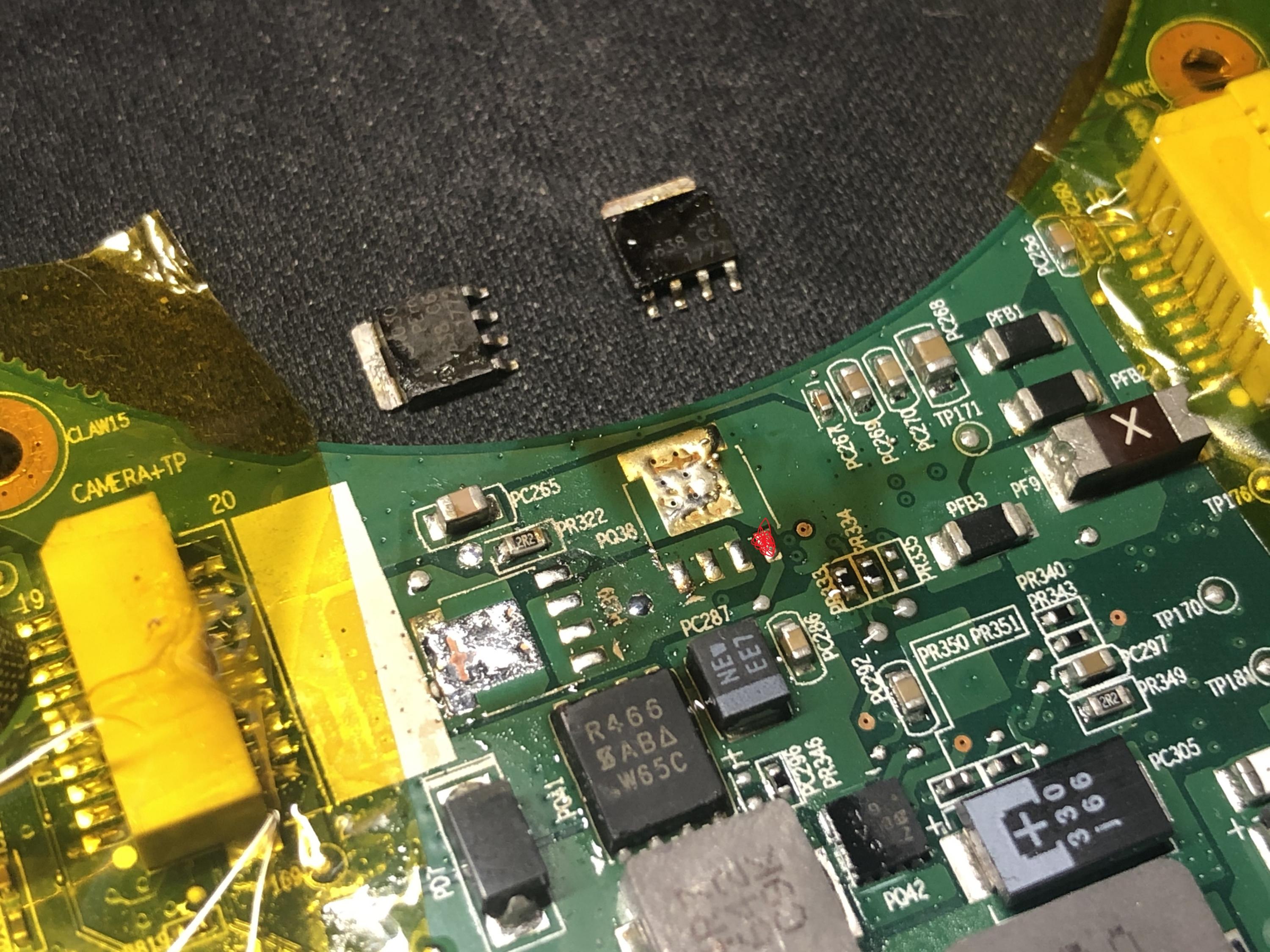

                        Removed these two mosfets today and found the left one to be faulty going through various off board tests
                          can u check now voltage on that red spot without the mosfet ?
                          also if u suspect the second one to be fault, can u solder back right one (only that )and check pin volts ? pin 1-2-3 should have 19 volt and pin 4 should be near 8 volt.
                          • Themi
                            • May 2020
                            • 79
                            • Scotland
                            mosfet pads closest to DCIN
                            4.6v at the red pad (gate)
                            0.655 at pads 1, 2 and 3 (source)
                            19.52 at large pad (drain)
                            mosfet pads furthest from DCIN
                            4.59v at the red pad (gate)
                            4.25-4.52 (fluctuating) at large pad (drain)
                            from all my tests on the mosfet yesterday the good one appeared to pass but I'm not 100% sure on the values vs what it was designed at. Hopefully tomorrow I'll receive new ones so I'll solder the one closest to DCIN first and check values then reattach the other one.

                                      When mosfets were attached to board these were the values:
                                      mosfet closest to DCIN
                                      D - 19.52v
                                      S - 4.3v
                                      G - 4.25 - 4.52v
                                      mosfet furthest from DCIN
                                      D - 4.25 - 4.52v
                                      S - 4.5v
                                      G - 4.25 - 4.52v
                                      Removed both mosfets from board and found mosfet furthest from DCIN is faulty after testing with diode mode on multi meter.
