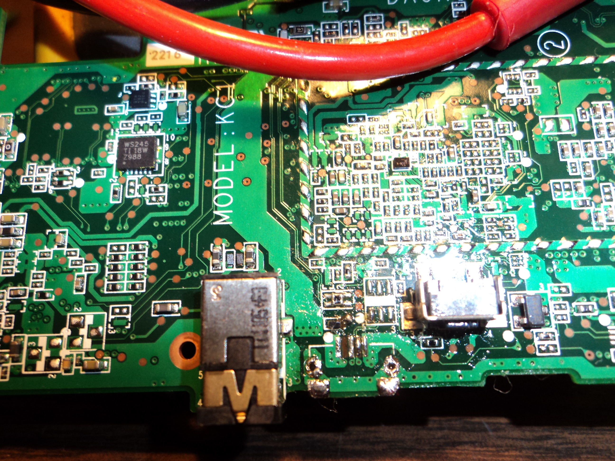

    Hi guys; i have here a Kindle mother board that charger port fell off, i have a new port but there is a missing trace pad on the board the second trace on the left next to the ground pin,
    can i chant this missing pin; see pic on the link,thanks and have a merry Christmas.
    http://www.ebay.com/itm/Kindle-Fire-...8AAOSw8-tWXglW
    • 31087
    Re: Missing trace pad help
    there are 2 ground pins, the other side is the 5v.
    the remaining 2 are usb data
    they link to the other side of the board, so you could fit a fine wire through the hole to solder to the pin.

      Thanks stj;i have another same board that is bad and i scraped at the beginning of the missing pad and it is tied to the first pin which is ground and goes to that black chip,if so i can chant it to the first pin on the left and connect a small wire to the black chip right in front of the missing pin see pic of the board that is ruined and has only 2 trace paths

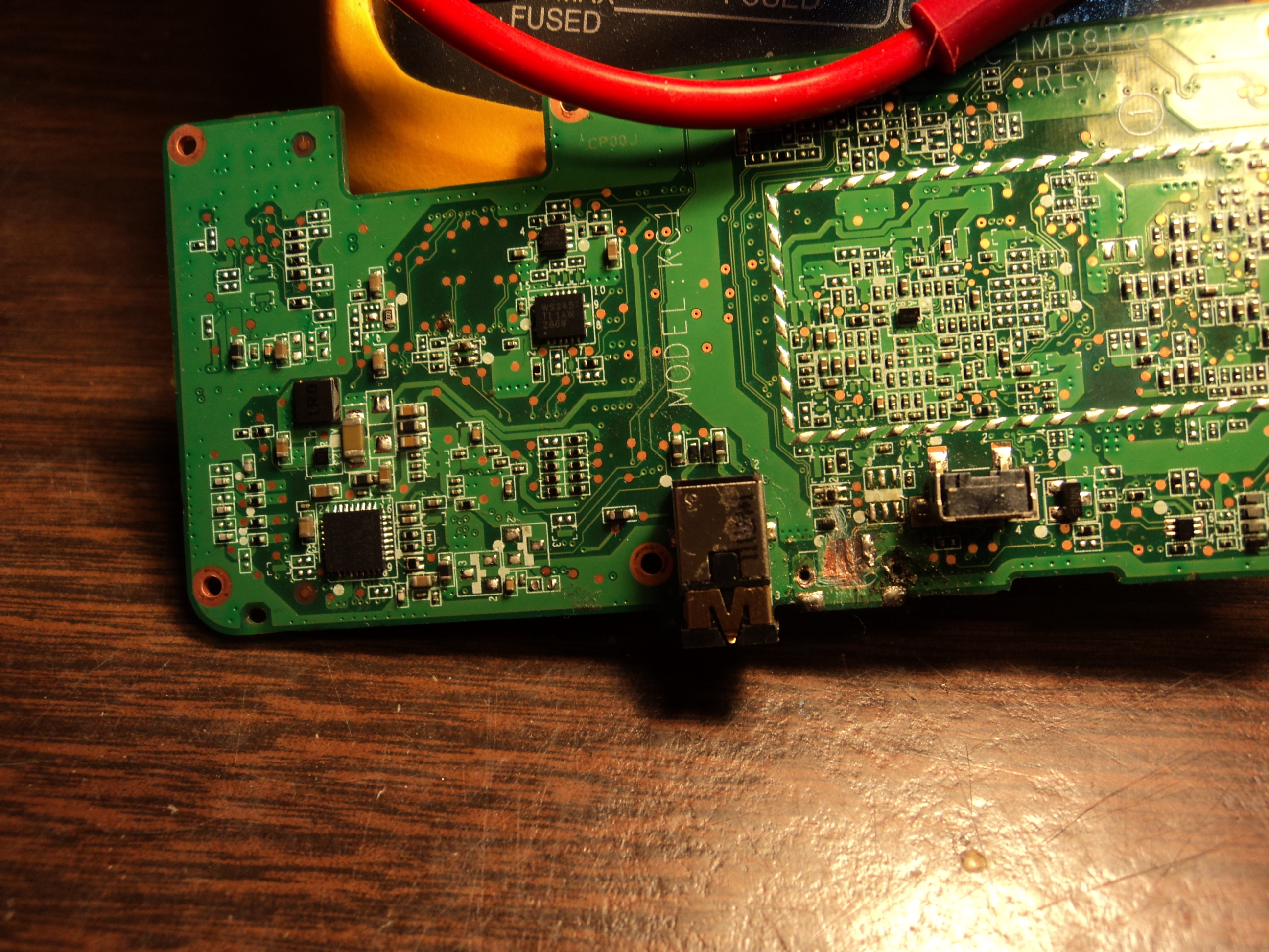

          Sorry here it goes

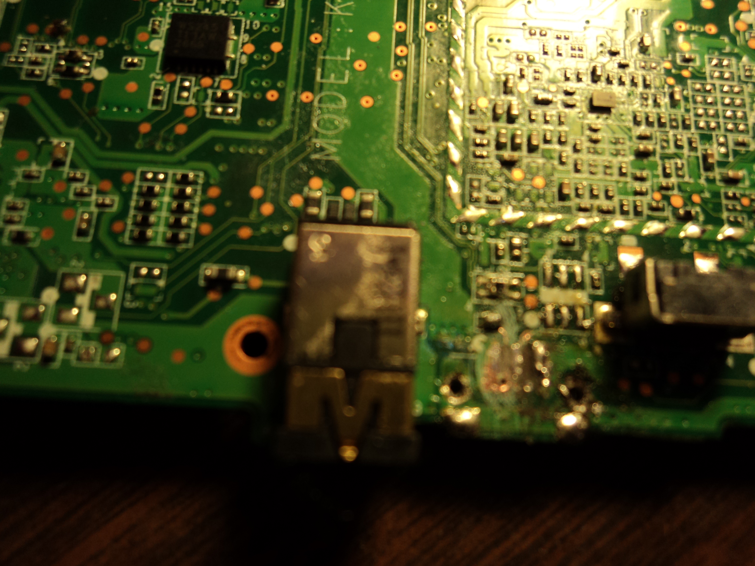

            here is one more pic,Sorry is kinda hard to take good pic with a crapy camara

              Here another pic hope is better

                  The extreme connections are for power, as I saw in the first pic the pads are OK, even without the other 3 pins connected the charging should work, in your next picture, you filled in the solder, remove that to avoid any shorts and wire wrap if you need the the data connection too, generally, you can use the flash card for transfer. Good luck.

                    Thanks TossDon, since there is no trace path on the second trace on the board, can i connect a wire from second port pin to the black chip,but i don't know if i have to connect it somewhere else/ thanks and have a Merry Christmas .

                      Here the real board pic attach

                        First, clean/remove all the solder dunes and then solder the new connector, the first and last pins should be soldered, leave all the others for now, MAKE SURE there are no shorts and connect and see if charging gets restored. FYI, The second pin from left is the ID for the device and Pin3/Pin4 are for data sync, all three are not needed for charging. Let me know how it goes.

                          If i don't connect those 2,3,4 pins what happens?
                            • 31087
                            in theory it will charge, but you cant use the port to connect to a pc - although it should charge from the pc, just no data transfer.

                              stj is right, you won't be able to connect to PC for data sync but it will still charge from any USB port.
