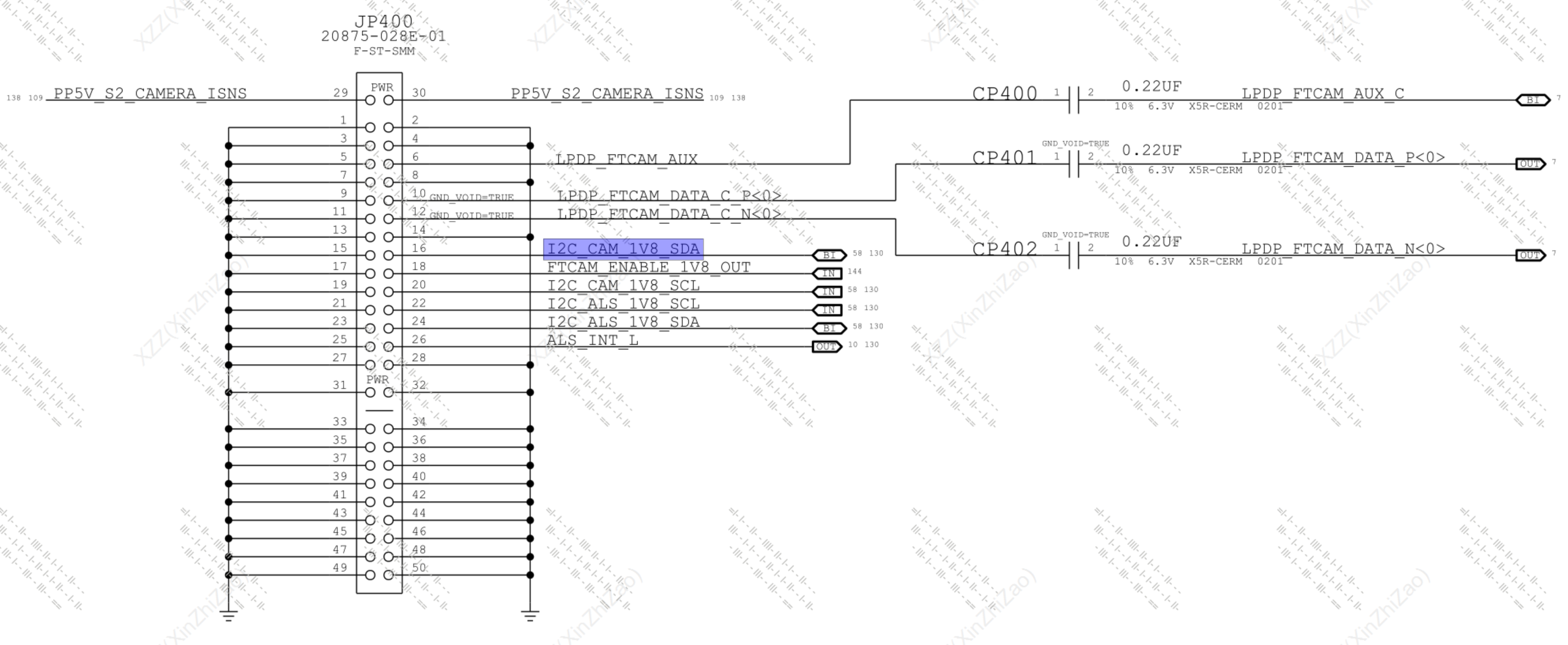

    Perhaps you are disconnecting the flex on JP400 to make this unit function?
    JP400 is linked to the ALS (ambient light sensor) and the camera controller logic.
    Remove all power. Meter in DIODE mode (not resistance mode). Red meter probe, yes red, to ground. Black meter probe to the point to test.
    With the flex cable attached onto JP400, measure the DIODE mode readings for:
    I2C_CAM_1V8_SCL
    I2C_CAM_1V8_SDA
    I2C_CAM_1V8_SDA
    I2C_CAM_1V8_SCL
    Then disconnect the flex cable from JP400 and measure the above points of interest again.
    Post each measurement.

      so without flex connected is:
      I2C_CAM_1V8_SCL 0.549
      I2C_CAM_1V8_SDA 0.549
      with flex is:
      I2C_CAM_1V8_SCL 0.454
      I2C_CAM_1V8_SDA​ 0.454

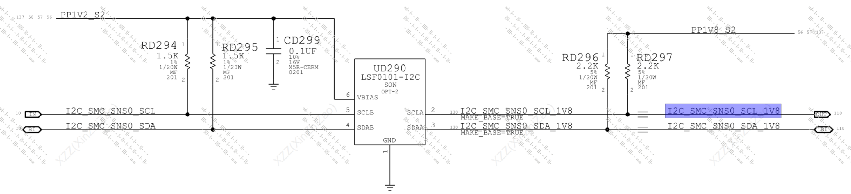

      but the issue shows up when JP600 is connected, sorry not mentioned before which flex make that.
      • mon2
        • Dec 2019
        • 14845
        Diode readings are fine.
        Carefully, review the voltage to ground measurements (not diode mode) for both sides of the level shifter @ UD290. This bidirectional FET level shifter is used to shift from the 1v2 to / from the 1v8 voltage domains.
        • veedo
          • May 2016
          • 31
          • United Kingdom
          I have 1v2 and I have 1v8 as well, with and without flexes connected.
          RD296 and RD297 have 1v8 on both ends, RD295 AND RD294 have 1v2 on both ends.

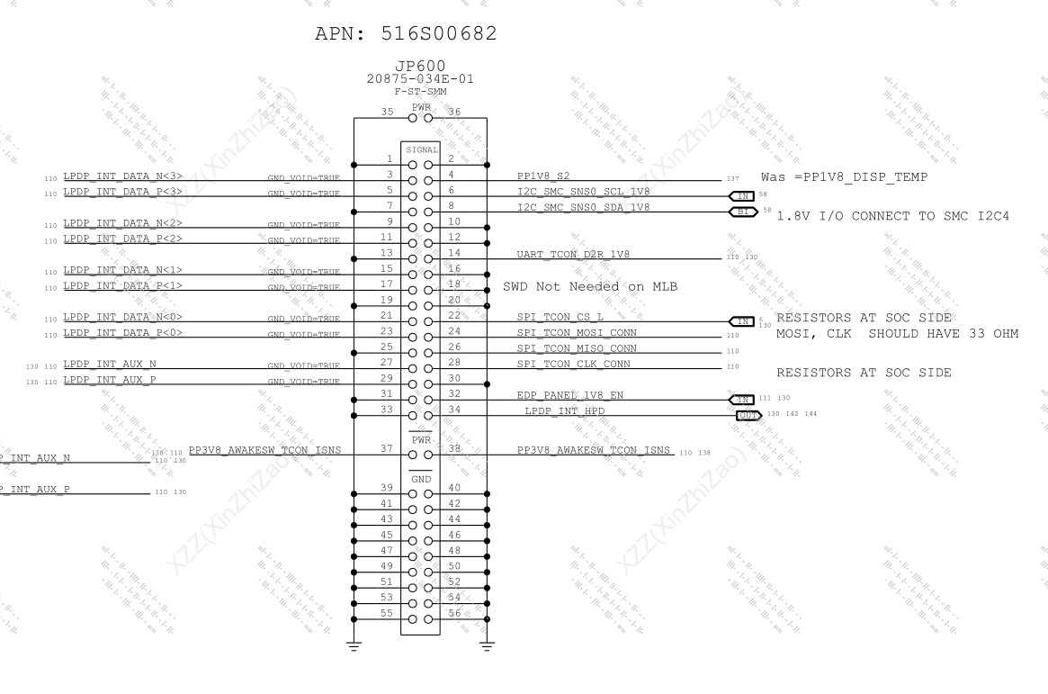

                  I have exactly the same Macbook Pro 14" A2442 (M1 Pro)
                  water damage arround UP800, UR700,UR730,UR760
                  I've cleaned all corrosion but there is no backlight.
                  I tried to reball UP800 but doesn't help still the same. Chime and apple logo without backlight and after some time macbook restarts (bootloop)
                  I read this and i disconnected JP600 and i was able to restore system and fully start and test macbook (everything is working, camera, keyboard, lid sensor, microphone, speakers, wifi, bt, battery, ....)
                  I probably need to replace UP800 but i don't understand what is causing the bootloop on JP600.
                  Any idea ?
                  • mon2
                    • Dec 2019
                    • 14845
                    Remove all power. Measure each contact used by JP600 in diode mode. Red meter probe, yes red to ground. Black meter probe to the pin to test.
                    Confirm the diode mode measurements against the schematic to see if the diode measurement is ok or not. Start with the I2C / SMBUS lines.
                    Post your table of measurements with their pin #s / labels as shown in the schematic to make the review easier.
                    • obelix24
                      • Jun 2023
                      • 300
                      • Slovakia
                      1 GND
                      2 GND
                      3 OL
                      4 0.157
                      5 OL
                      6 0.510
                      7 GND
                      8 0.510
                      9 OL
                      10 GND
                      11 OL
                      12 GND
                      13 GND
                      14 0.800
                      15 OL
                      16 GND
                      17 OL
                      18 GND
                      19 GND
                      20 GND
                      21 OL
                      22 0.310
                      23 OL
                      24 0.348
                      25 GND
                      26 0.310
                      27 OL
                      28 0.346
                      29 OL
                      30 GND
                      31 GND
                      32 0.658
                      33 GND
                      34 0.315
                      Whole top Line of pins (except GND are OL) so i guess there is problem. According to BRD file all this pins go to oposit side to Resistors and Capacitors and then directly to CPU.

                                OK i've connected one USB-C port and connected power it was taking 20V
                                BL_PWR_EN (RP873) - 1,2V but drops to 0V
                                I2C_LUXE_DEBUG_SCL - 1,2V but drops to 0V
                                I2C_LUXE_DEBUG_SDA - 1,2V but drops to 0V
                                SPMI_DISP_BKLT_CLK - 0V
                                SPMI_DISP_BKLT_DATA - 0V
