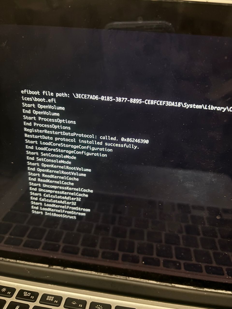

macbook pro late 2012 A1425 boot issue
  • dqtech
    Badcaps
    • Jul 2018
    • 632
    • N/A
    this is my first time having this issue...everytime turn on will have this kind of word before apple logo appear....and sometimes just stuck here and have to force shutdown and turn on again....anyone have solution for this?
  • dqtech
    Badcaps
    • Jul 2018
    • 632
    • N/A
    this is full video...even after reformat macos also have this kind of word before apple logo...please help how to disable this....
    • dqtech
      Badcaps
      • Jul 2018
      • 632
      • N/A
      problem solve...i did PRAM and everything goes to normal
