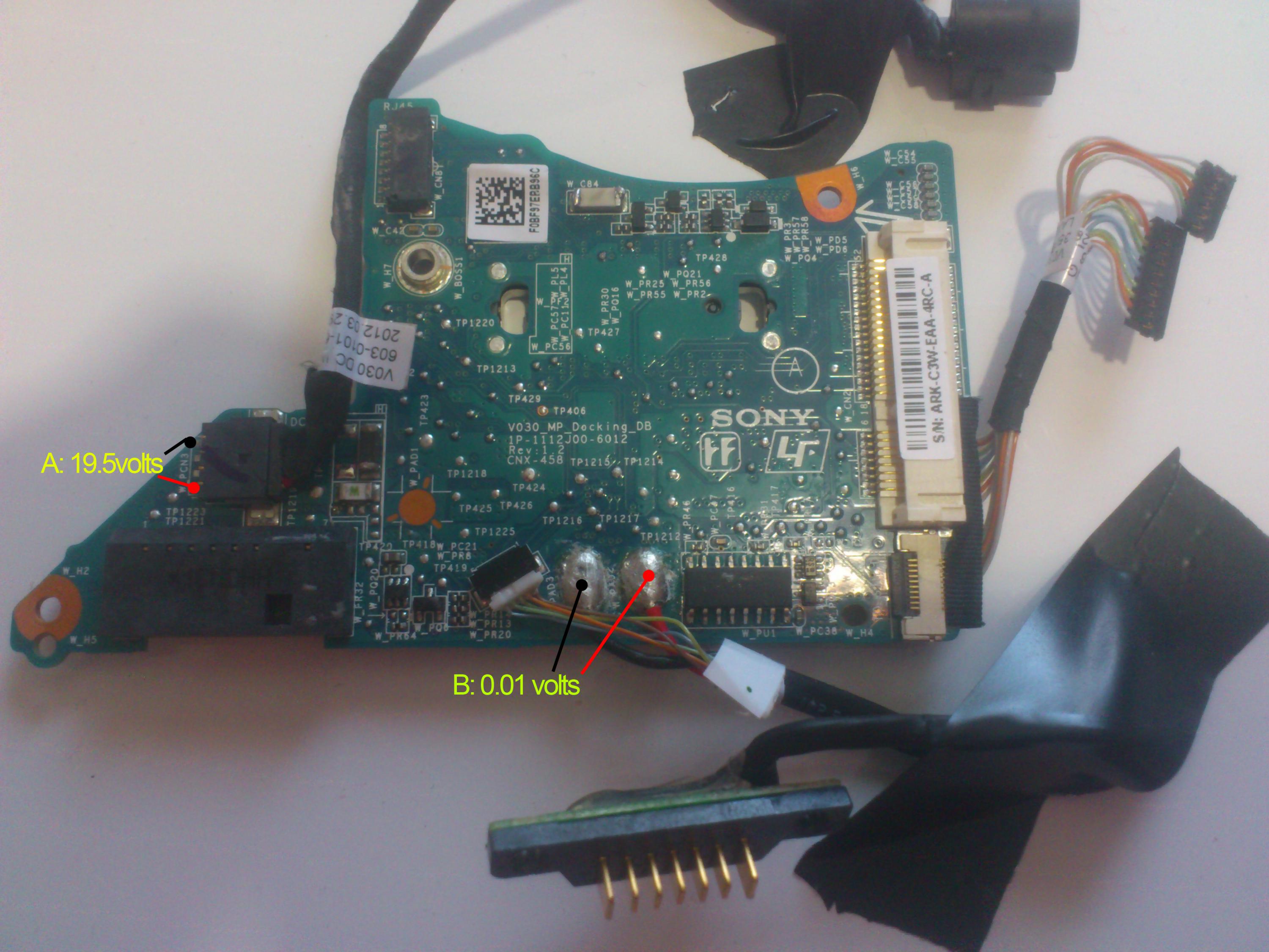

                            Re: Sony Vaio VPC-SB26FG cannot power on
                            Hi Guys, unfort. it wasnt just the mosfet, I get some readings now from the new mosfet but still not powering on . I'm not sure if the power board is fully working.I have 0.5v from the powerboard 6 pins connector(connected to motherboard) Does anyone has the schematics for the powerboard cnx458 ?

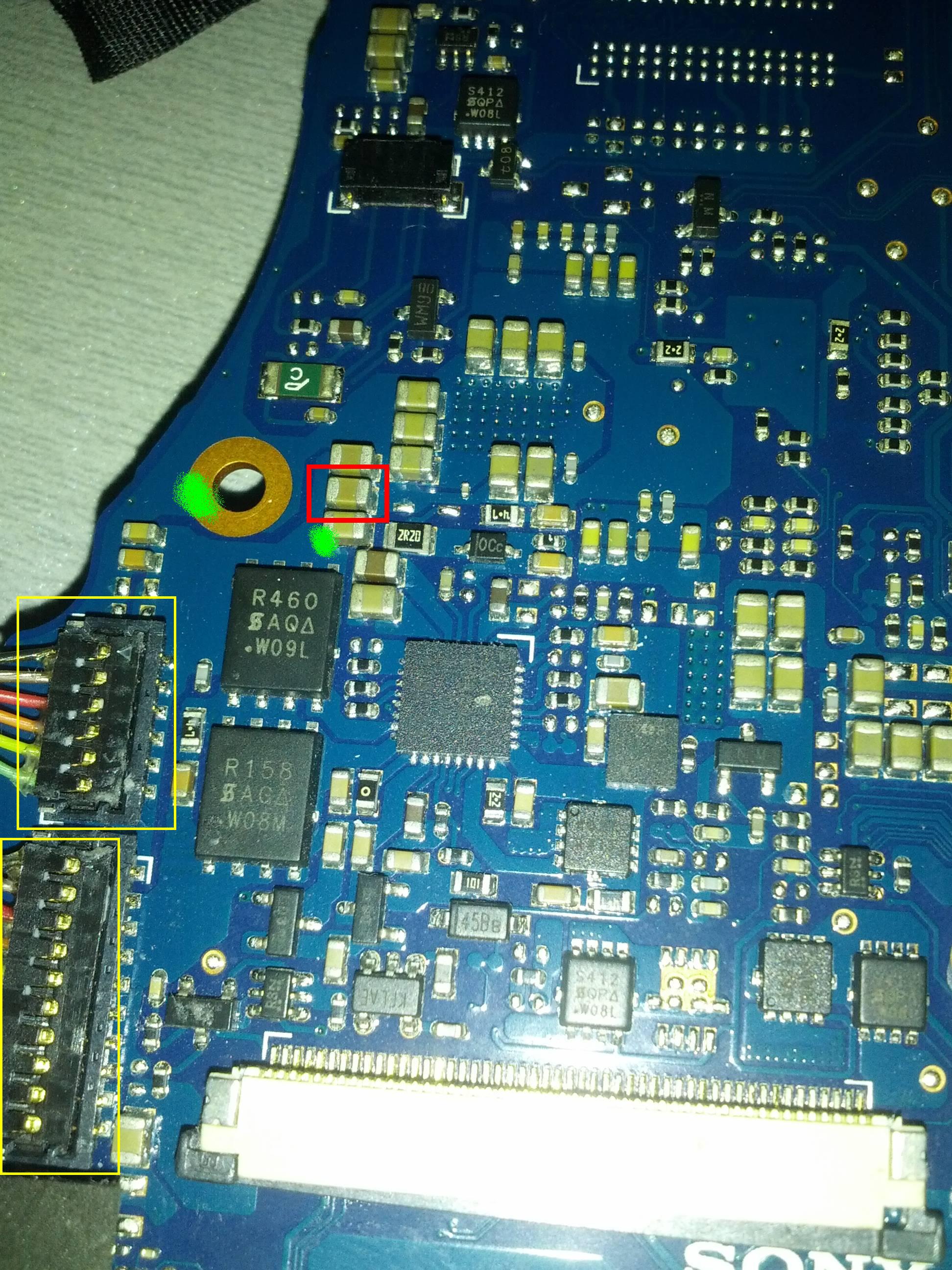

                              Hi guys!
                              I have just registered to share a bit of my experience with this mobo.
                              I had no power at all on this laptop (current draw was 0.01A when connecting the power adapter to the laptop). BTW, I am using a very convenient chinese cheap power meter to see what happens to the laptops when I connect them: http://www.ebay.com/itm/261219652805 .
                              I had the black connectors (in yellow rectangles) on the mobo shorted with each other and to the ground. Therefore, the power daughter board MBX-458 did not provide 19V to the shorted circuit.
                              Then I soldered regulated power supply terminals to the points shown GREEN. The voltage was set to 1.5V, the current to 3A. The capacitor in a RED rectangle became hot immediately. So, it was shorted to the ground. After I have removed it, all the shorts with black (6-pin and 10-pin) connectors went away. The cap was replaced by a compatible 10uF/25V ceramic cap, and laptop turned on, was assembled and passed to the customer.
                              Of course, in your case this can be ANY other cap or semiconductor, but the main method is the same: apply safe voltage (lower than the intended voltage for the shorted circuit) to the shorted circuit and slowly raise the current while controlling the temperature of the board (with your hands or using any pyrometer).
                              Good luck, colleagues, and successful repairs to you all! :-)

                                      Hi all! I've got the same problem with the same model of Sony. However, 90% of dead Sony I get in service all of them have the same problem- one ceramic capacitor shortened, usually near the CPU but in this case it's the same cap shortened as in michaeleangelo's case. The work methode is very right, but I prefer to check out the circuits, the caps with the multimeter only. In some difficult cases I use a infrared thermometer to find the chip/ element that is defect, sometimes it doesn't get hot- could have two degrees above the motherboard and checking with fingers you can't feel the right temperature.

                                        OK ! My MBX-238 - THE SAME shorted capacitor ! Thank you for hint. Now both power connectors are NOT shorted anymore. Unfortunatelly, its still doesnt power on. When i plug both black connectors to mobo i can measure 19v. But just when i plug DATA BUS connector (beside both power connectors) i lost 19v imediatelly and system not power on. What is wrong ? Thank you for help.
                                        (just for info, im testing that mobo WITHOUT shorted capacitor as i have no spare for exchange, but i hope its not my source of problem)
