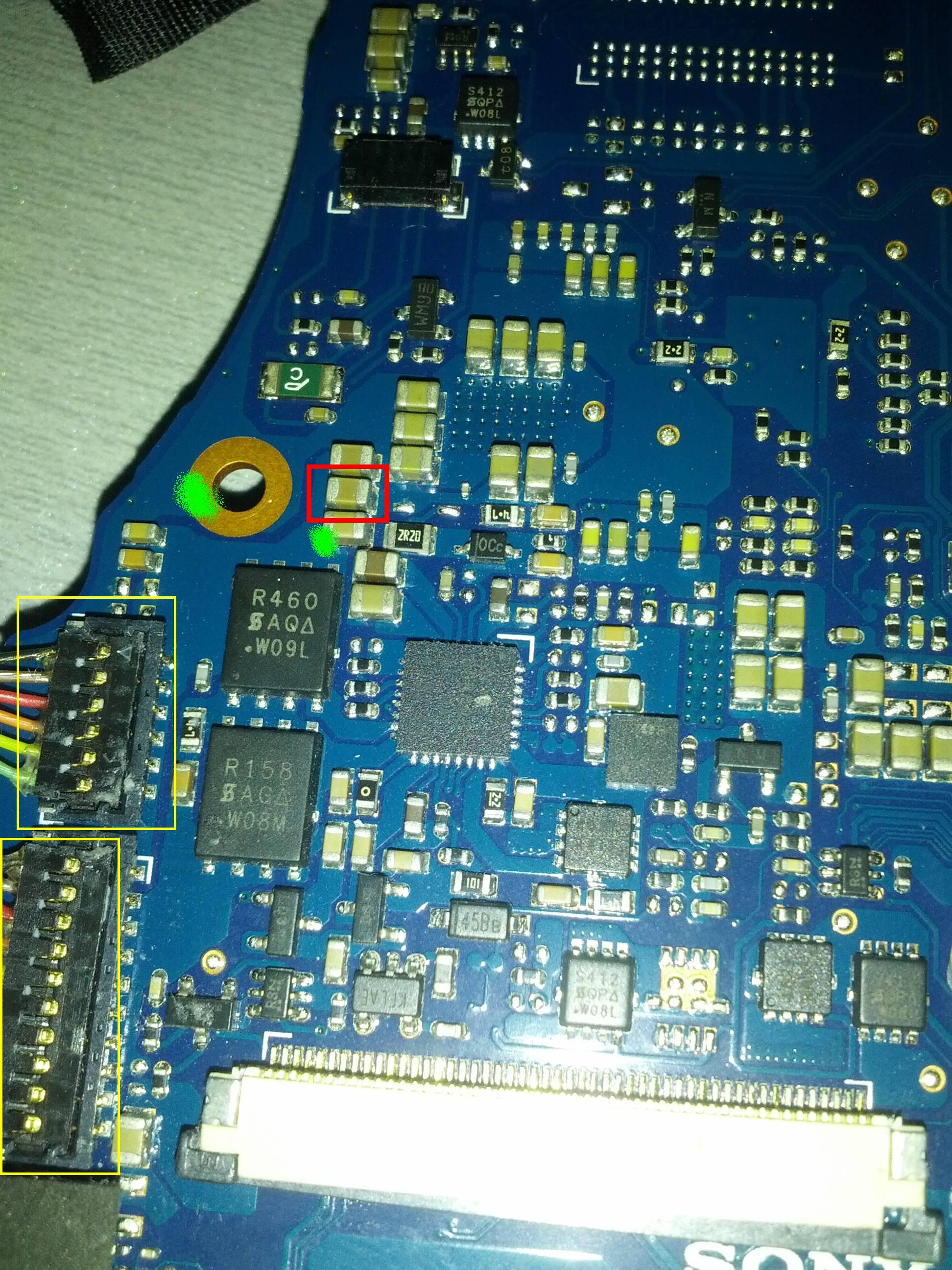

    Hello, when you were repairing a MBX-458, why did you apply current to the cap in red box? And not the others?
    Hi there!
    The cap that is in the red box was faulty. But when I applied current to GREEN points, I did not know this yet.
    The reason I applied current to these (GREEN) spots is that these are main GROUND and VIN (+) in points on this board. And when you apply current to the shorted cirquit, it starts to dissipate heat. The component that gets warm is most likely to be defective.
    In my case it was the capacitor outline in red.

      Why do you think you would get anything more than 0.01V on these pads without battery connected and with KBC (keyboard controller) disconnected (it is located on the MAIN board, MBX-238, and rules the charging process)?
      The points you measure voltages at are battery "+" and "-" terminals, and there has to be no voltage (or close to none) without battery.
      The point we discuss in this thread is that there is a short cirquit on the MAIN board (MBX-238) that causes CNX-458 to SHUT OFF the output if it detects overcurrent on any of the outgoing cirquits.
      So, please measure the resistance between the green points on my photo. If it is close to zero, then apply regulated current supply to these points and check what elements do heat up.
      Is there any reaction on the "power on" button?

        Of course, in your case this can be ANY other cap or semiconductor, but the main method is the same: apply safe voltage (lower than the intended voltage for the shorted circuit) to the shorted circuit and slowly raise the current while controlling the temperature of the board (with your hands or using any pyrometer).
        Good luck, colleagues, and successful repairs to you all! :-)
        Thanks a lot! For me it was the one next to it.
        It took me a while to find it, because it didn't really get hot, even with 6A. But as the cable already got warm, I simply tried first your broken one and then the one where I put current on --> Got it
        It's back to life, Thank you man!

                  hi there. Check also the caps next to the one you have changed. Also check in the small psu board under the stickers of the connectors for tiny fuses.

                    I simply changed all of the 3 caps (10uF, 25V) to make sure it will last longer, maybe they didn't use 25V caps
                    For me there was nothing else to do

                        I've had a VPCCSA with that model motherboard recently, not powering on.
                        Replaced the cluster of three caps marked in the picture and got it starting up again.

                          The capacitor in a RED rectangle became hot immediately. So, it was shorted to the ground. After I have removed it, all the shorts with black (6-pin and 10-pin) connectors went away.
                          Same problem thx for sharing, laptop works again.

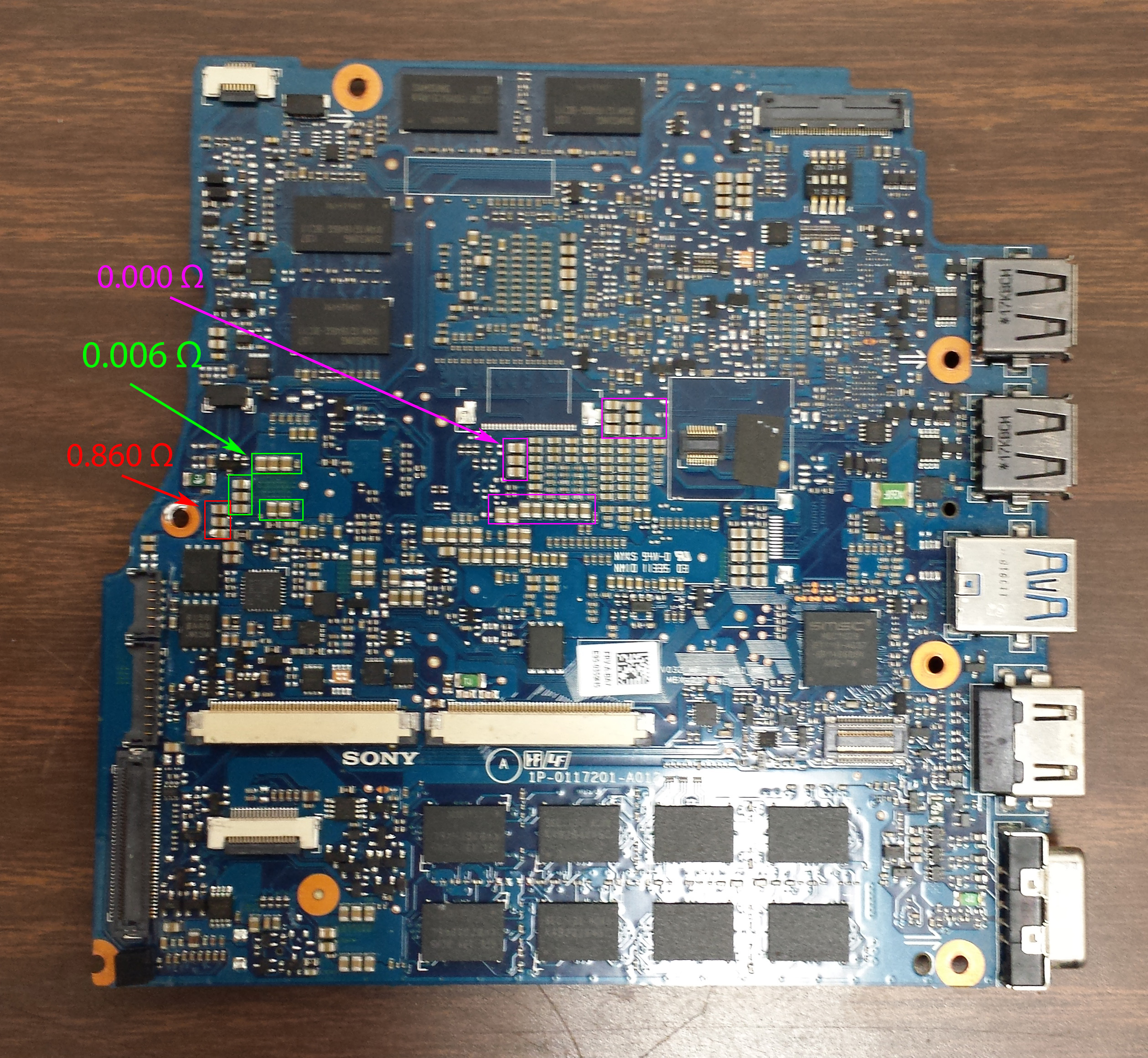

                            Thanks for all the people that has posted solutions and things to try. I have tried some of them and i have a different problem then most so i want to get your input
                            I have posted a picture
                            The Red Square (where everyone else is having issues) seems to be good with a 0.86 reading.
                            The Green Square i get a .006 reading and the purple square i get 0.001 0.000.
                            Now i tried what michaeleangelo posted with the power supply, one lead on ground and the other on the positive side of the cap in the green square. I set the power supply to 1.5 or so volts and about 2.0 - 2.2 A and the only thing that warmed up was the south-bridge (Not hot but warm)
                            Now, the south bridge is right on the other side of the purple set of boxes where i am getting 0.000.
                            Is this a bad south bridge??? any other suggestions on things to try??
