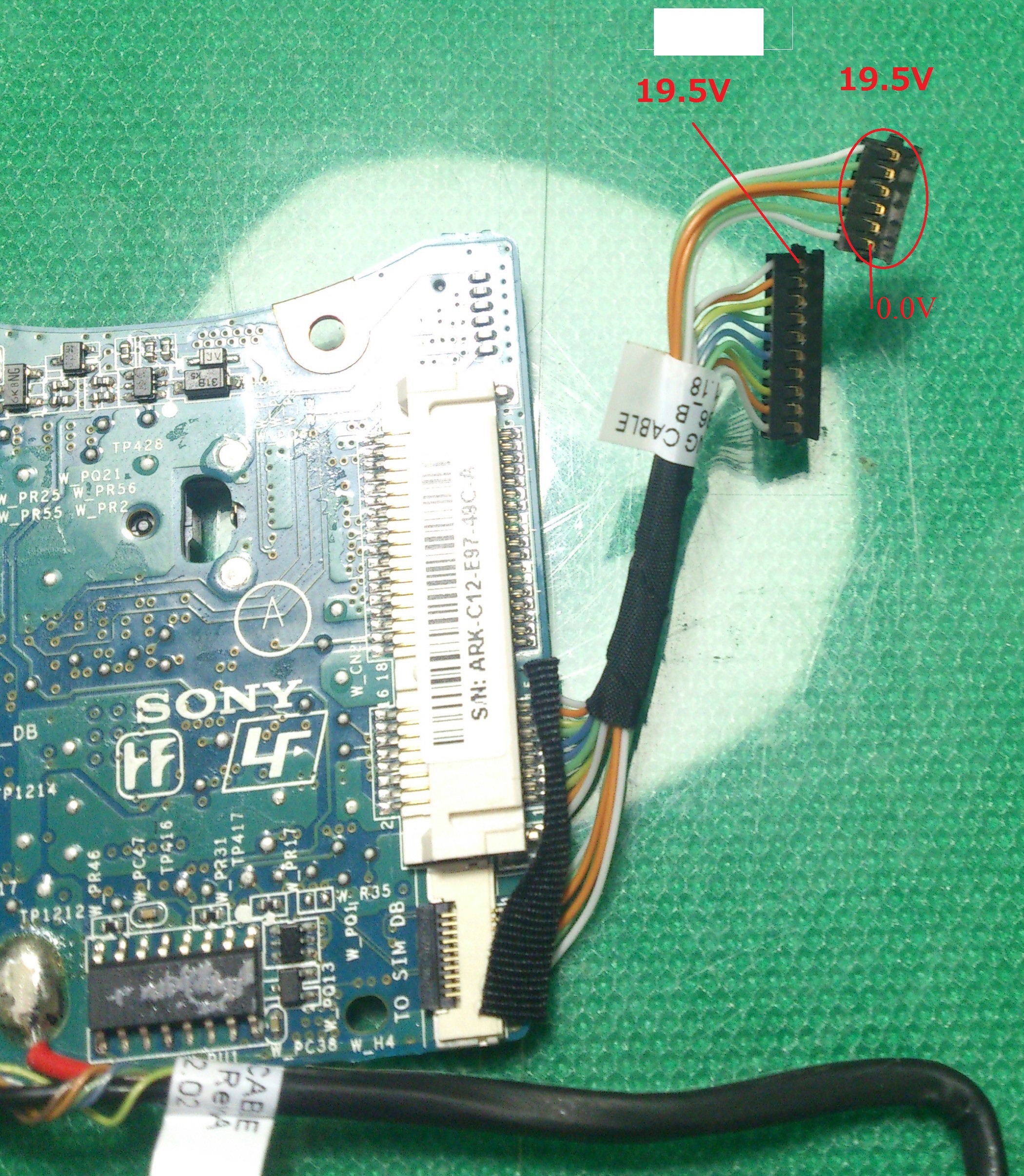

            I have some problem but i thing that my power board is fault because on this pin is 0.0V, and when connect it to MB all red pins 0.6V except that is 0.0V
            PS
            Sorry for my English );

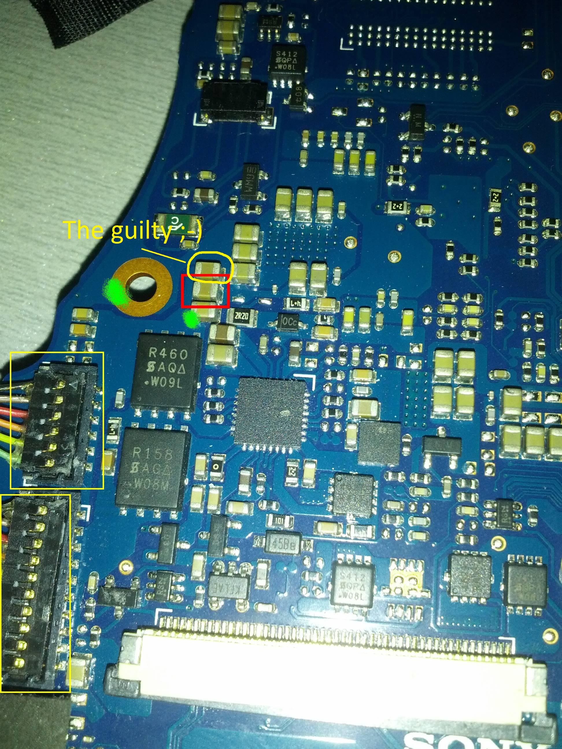

                                      Re: Sony Vaio VPC-SB26FG cannot power on
                                      Originally posted by michaeleangelo
                                      Hi guys!
                                      I have just registered to share a bit of my experience with this mobo.
                                      I had no power at all on this laptop (current draw was 0.01A when connecting the power adapter to the laptop). BTW, I am using a very convenient chinese cheap power meter to see what happens to the laptops when I connect them: http://www.ebay.com/itm/261219652805 .
                                      I had the black connectors (in yellow rectangles) on the mobo shorted with each other and to the ground. Therefore, the power daughter board MBX-458 did not provide 19V to the shorted circuit.
                                      Then I soldered regulated power supply terminals to the points shown GREEN. The voltage was set to 1.5V, the current to 3A. The capacitor in a RED rectangle became hot immediately. So, it was shorted to the ground. After I have removed it, all the shorts with black (6-pin and 10-pin) connectors went away. The cap was replaced by a compatible 10uF/25V ceramic cap, and laptop turned on, was assembled and passed to the customer.
                                      Of course, in your case this can be ANY other cap or semiconductor, but the main method is the same: apply safe voltage (lower than the intended voltage for the shorted circuit) to the shorted circuit and slowly raise the current while controlling the temperature of the board (with your hands or using any pyrometer).
                                      Good luck, colleagues, and successful repairs to you all! :-)
                                      Thanks so much <3
                                      In my case need replace fuse code "W_F1" (BQ24725_VCC_R_C) after replace ceramic cap. It protect BQ24725 when shorted ciruit.
