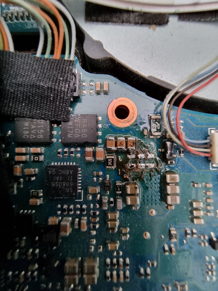

    hi, How measure in mosfet R460 and mosfet r158, in this picture, thanks!!

      would anybody know the values of the 3 capacitors in the red box please.
      Regards
      Adrian

          Re: Sony Vaio VPC-SB26FG cannot power on
          @ageman - are these caps missing or deemed to be defective ?
          Very likely they are bulk caps and from a distance look to be 0805 in size. Probably each are the same capacitance and being in parallel, they add together to filter that rail.
          What are the markings on the IC that is south in your picture ? That component is probably creating the power rail with these caps being downstream. You can probably review a reference schematic for this IC to understand which caps are present on this logic board.
          You can consider to remove one of the other caps that appear to be the same -> measure the capacitance and use the same for your cluster of caps. The voltage rating can be the highest you can find for the 0805 size but doubt that you are facing a voltage rail > 6 volts here. Post the SMD markings of the IC.
            Hi mon2
            The caps were removed as the last one I removed was shorted. I measured the other 2 but they were 20uF which looking at the schematic, could not find any that value.
            The IC is SN608098. See photo
            Regards
            Adrian
              Feel free to use 22 uf which is a very common part value for ceramic caps. We use them all the time in product builds.
