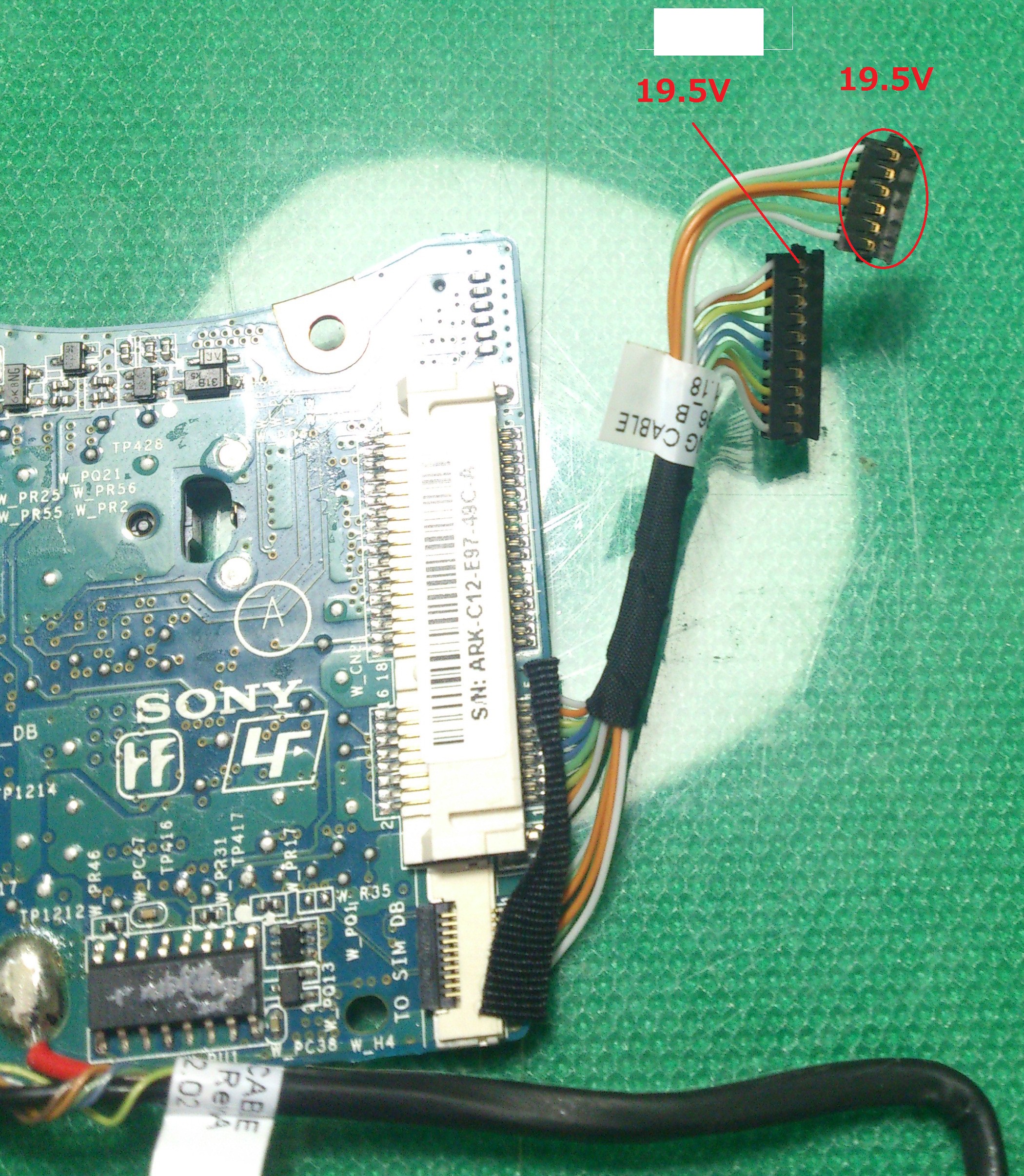

              • bappies7
                • Aug 2011
                • 41
                Re: Sony Vaio VPC-SB26FG cannot power on
                Originally posted by spidey
                i dont have it. Can you put a photo of the powerboard.?
                Here the photos of the power board..
                    which connector goes to power plug ? And which is for the power of MB ? It looks the charging circuit on this board. have you measured anything on the board ? black and red cables for example.
                    • sparker1
                      • Sep 2011
                      • 343
                      Is that a fuse on the LHS in the first picture near the big black thingy? Maybe check that first.

                        Hi there,
                        I would like to join the club of a non powering on Sony VAIO VPC-SB26FG user. Since Sony wants nearly $1300 for a new mainboard it is worth to check for possible issues. I have seen so many MBX-237 that were faulty and the only option to fix them was to replace them.
                        With all VPC-SB/SA units it is never the power board that is causing unit not to power on, its always the mainboard. The only time power board requires replacing is when the battery charge LED is flashing rapidly.
                                  It's always the mainboard in my case. I got a reply to the same thread on another forum board:
                                  problem connected to the connector on the module CN9
                                  measure voltage on pin 5 of PQ14
                                  voltage on PL16, PL17
                                  cathode voltage PD27
                                  voltage pin 19, 14, 32, 7 of PU121
                                  I checked my mainboard and pretty much all of them have shorted pins on the mainboards, where you connect power board with 3 connectors to the mainboard. Please check your mainboard and confirm that the cables (not the brown one flex cable) are shorted.
                                  Mike

                                      Thanks Mike I will check those! I have checked the cables that connect to the motherboard the smaller one cable with 6 pins all have 19.5V testing the power board by itself then the bigger connector with with 10 connectors only the first pin white cable has 19.5V the rest all show 0.0V I then connect the power board to the motherboard and now all show -0.0V even the small connector which previously showed 19.5V will report later any changes, any help will be much appreciated!
                                        I checked those pins in the photo before while connected to MB and they were all at 0 V but the connection to the battery had 3.3 V which tells me the power board seems fine but the MB is shorted somewhere.
