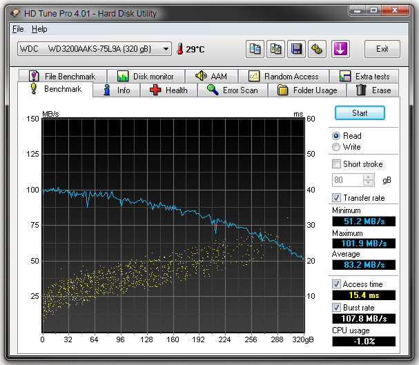

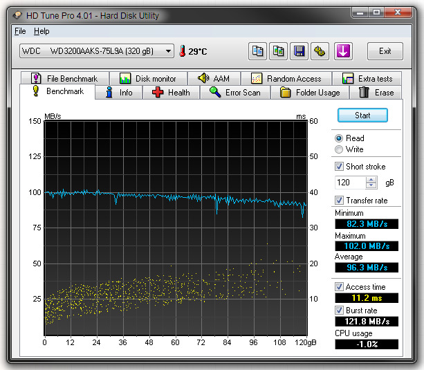

                              About the HDD partitioning.. get HDTune and check the performance of the drive (not necessarily in the laptop itself.. you can connect it to your main rig if it has SATA ports). The neat little function called "short stroke" lets you simulate a small partition.
                              i.e., if you have a 640GB HDD and you set short stroke to 120GB, it'll only benchmark the first 120GB of the drive (as if you benchmarked a 120GB partition). That way you can test out up to what size the HDD performs best, and then partition it to that size later in the laptop (system partition).
                              Example is in the attachments (full 320GB vs. same HDD shortstroked to 120GB)
                              edit: if you plan to use it for audio stuff, stick with the 3GB RAM you currently have and go for XP. Vista and 7 tend to have audio latency problems (dropouts, clicks and stuttering).

                                That's a cool tool, I'm using it now, thanks.
                                I'm shooting for the "short stroke" partition that will
                                give me the highest AVERAGE MB/s, right?
