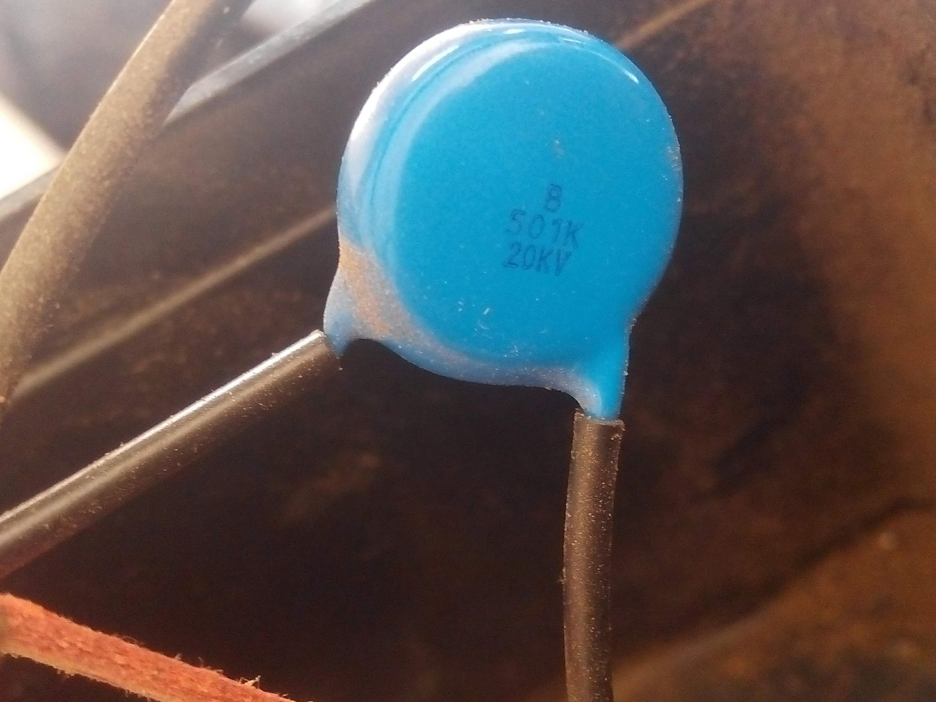

8) BLUE ceramic capacitor marked 501K 20KV (500pF) comes as 540pF out of circuit, not sure if this is too much or still regarded OK, this it the part i think:
http://www.hv-caps.com/High-Voltage-..._501K__55.html
A bit lost as to why the device is not working, i.e. voltage between Ground and Fence is ZERO
and no light turns on....
If the large board should only output 6VAC, which it does, then, something on the "coil" is bad, or that BLUE ceramic capacitor #8 above is bad, or maybe it's that C2 (not sure if testing same as any capacitor?) or that Metal Oxide Varistor (MOV, no clue how to test for that)..
