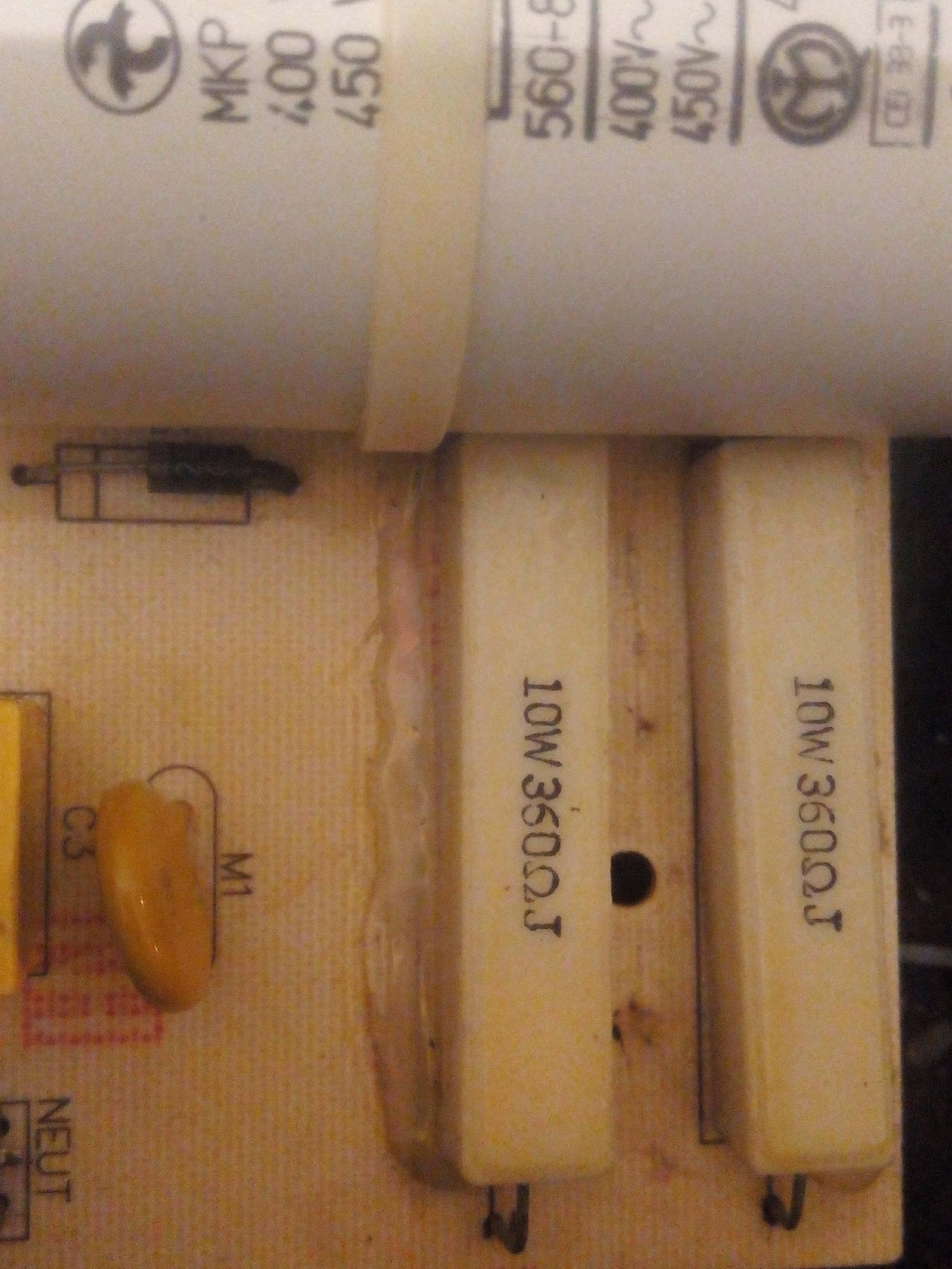

                          Here is a very fun update, making huge progress, thanks to all 'ya all
                          1) Replaced both D1 & D2 with HER-208, nothing blew up, and C1 charged like a turtle.. no change.
                          2) The measurements of 22->4 were given earlier, it is roughly 42-50VAC, in VDC it jumps around 35VDC.
                          3) 2->3 is 25 VAC
                          4) 32->33 is 10VAC
                          5) now the kicker i think... 22->27 comes at 110 VAC!!!
                          so, maybe that ceramic resistor is bad?? it says 10W @ 360 Ohm J.
                          Looking around all my old junk, nothing looks remotely like that.. need to figure how to connect some old CHAIR or something that has the same electrical properties, but not sure what can be substituted, so might need to order and wait...
                          Thanks everyone! looks like that is the issue of slow charging at least
                          Stormy.

                            Re: Repair Fence Energizer SS-1000E Fi-Shock
                            ok, just for the record, pulled the bad one, R2 (the one closer to center of board), measuring resistance out of circuit gets an *OL* on DMM.. so, that is the smoking gun - some short there! Will try to find a new one; that may take time Thanks, I'll keep posted of course. Here is a closeup photo of the two friends.
                            if you have any tips on what can change, like with capacitors i know i can usually go higher voltage as we did with the 100v@22uF, here I bet it can go higher Watts , but keep the 360Ohm and keep it ceramic so it can deal with the load i guess.
                            Stormy.
                            • R_J
                              • Jun 2012
                              • 9535
                              #54
                              I guess you missed post #21
                              Digikey carries the 360Ω 10 watt, I would just leave a bit of room (1/8 inch) between the board and the resistor for a bit better heat circulation

                                  #56
                                  Well, I guess measuring the voltage is easier than desoldering and measuring resistance anyway We found the bad resistor without a soldering iron!
                                  You can probably substitute something close by for a test but not knowing the characteristics of the coil I don't know. The duty cycle seems like the average power dissipation would not be high at all.
                                  But it failed! And resistors usually don't fail!
                                  Not sure if it's simply construction defect but odd that I doubt design problem... then again the resistors show no heat damage which usually cause their demise.
                                  As a test you probably can go up to 470Ω but safest to keep wattage. Higher wattage resistors unfortunately significantly goes up in costs so likely you don't want to go past 10W.
                                  BTW - what parts *do* you have that you could use?
                                  If you have like two 180Ω 5W you could hook them up in series and you're done, or perhaps two 680Ω 5W resistors and hook in parallel and be fairly close.

                                      #58
                                      Sometimes the wire inside the resistor just breaks due to heat stress, If you look at the other side it may show some cracks in the cement, but not always. Seen these go open alot many years ago in tube tv's

                                        #59
                                        Right, R_J, no visible sign of heat/burn/wear..definitely a short in wire though.. I'm eager to fully dissect it once a replacement arrives.. it seems to be some sort of "cement" poured (from bottom) into a ceramic cast, so it's hollow and inside is poured.. anyways... maybe there's a forum for how-to-fix-cement-resistors.net
                                        looking around on all power supply boards, i don't have this kind of stuff, only 0.5 through 2W resistors..
                                        I'll try to get either of these two, although they say 'wirewound' by photo they look similar, any thoughts?
                                        Xicon, 280-CR10-360-RC
                                        Yageo, SQP10AJB-360R
                                        will take some time, but I'll definitely report back.. so hang on for a happy ending hopefully, or more discoveries

                                          #60
                                          Not a "short" in wire, the resistance wire goes "open" and YEs those resistors are wirewound type.
                                          Digikey usually has cheap shipping and for $5.00 you can get 10. I can get next day shipping to Canada ($8.00 cdn) so it should be even faster for you
