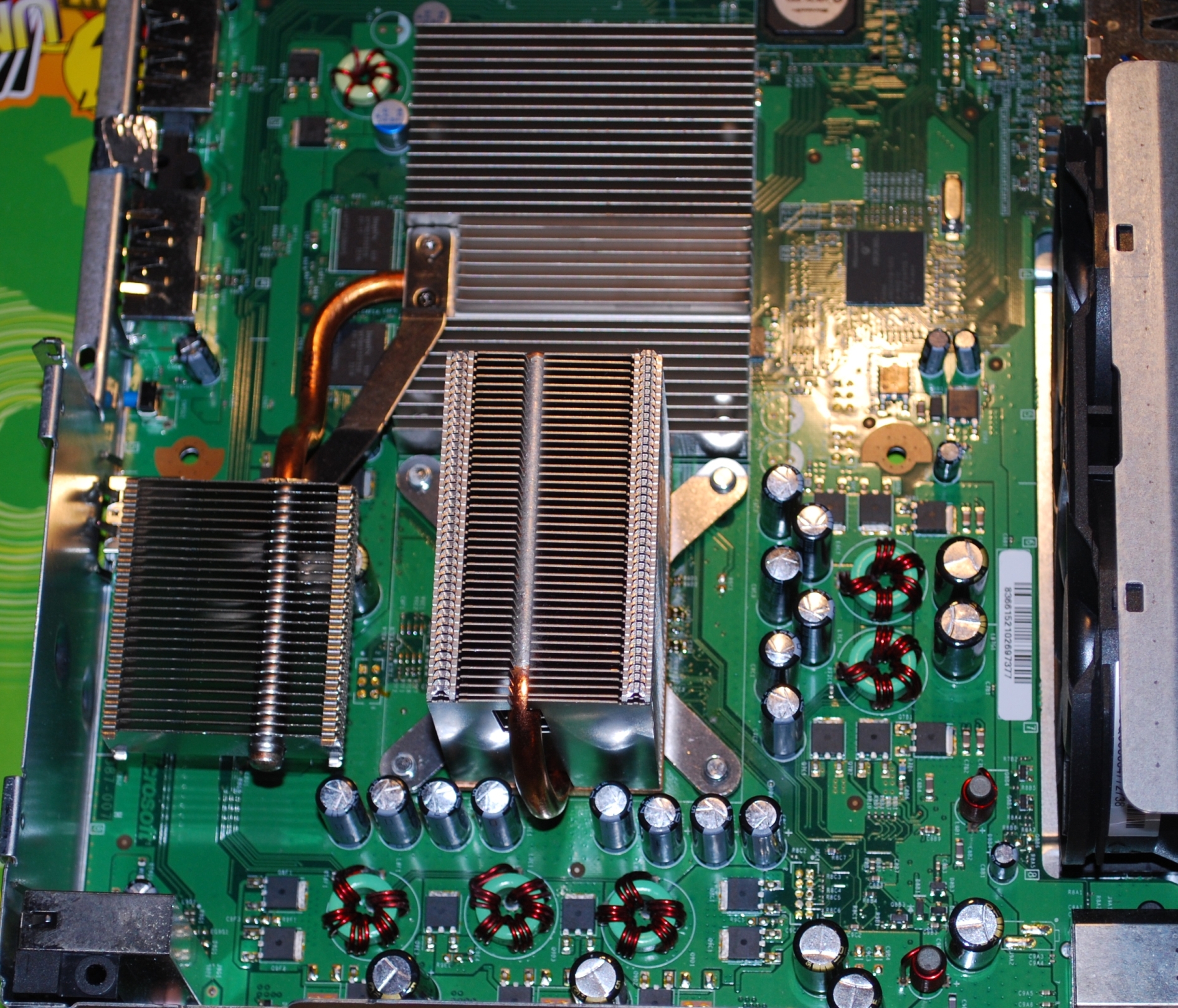

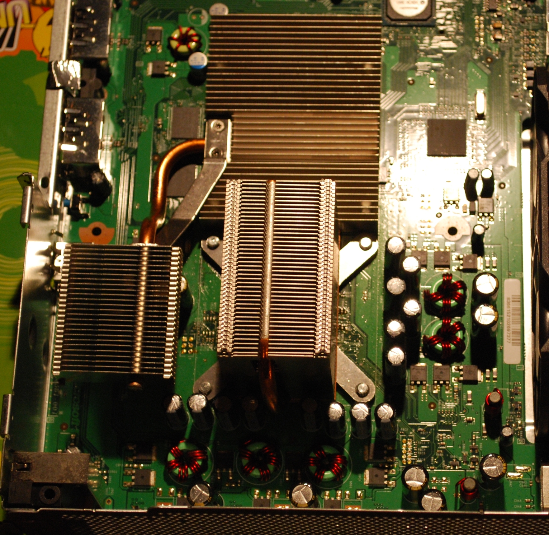

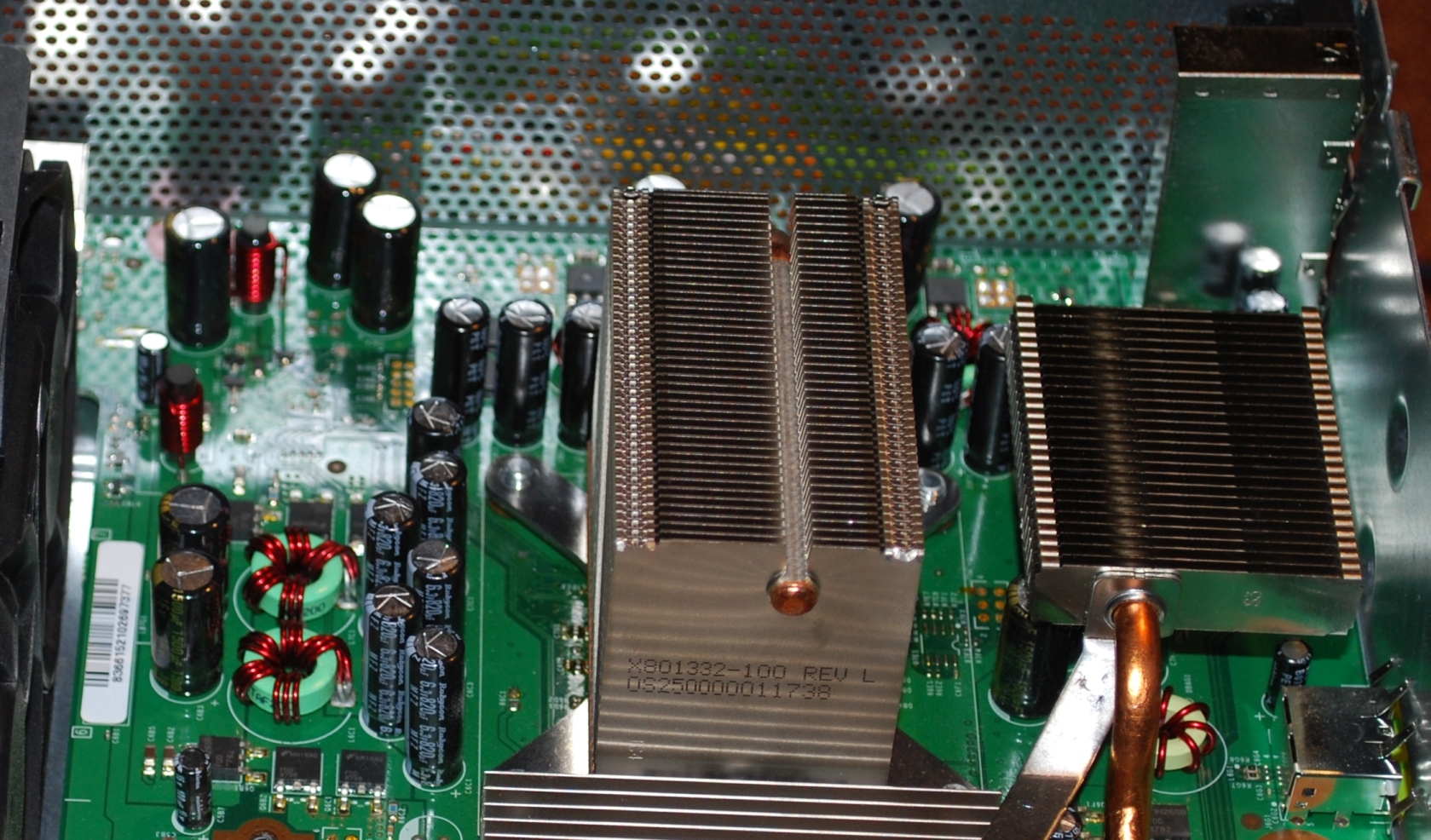

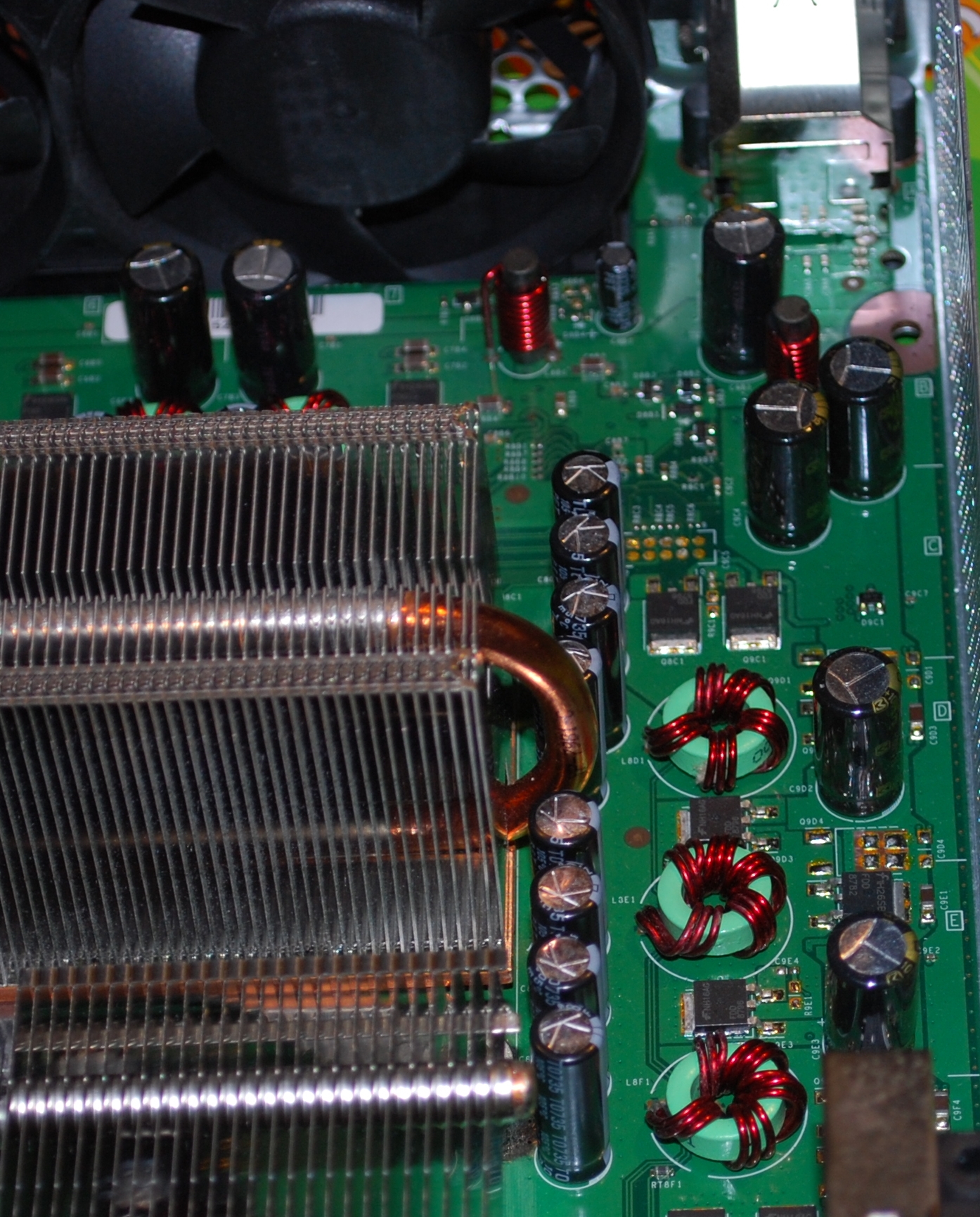

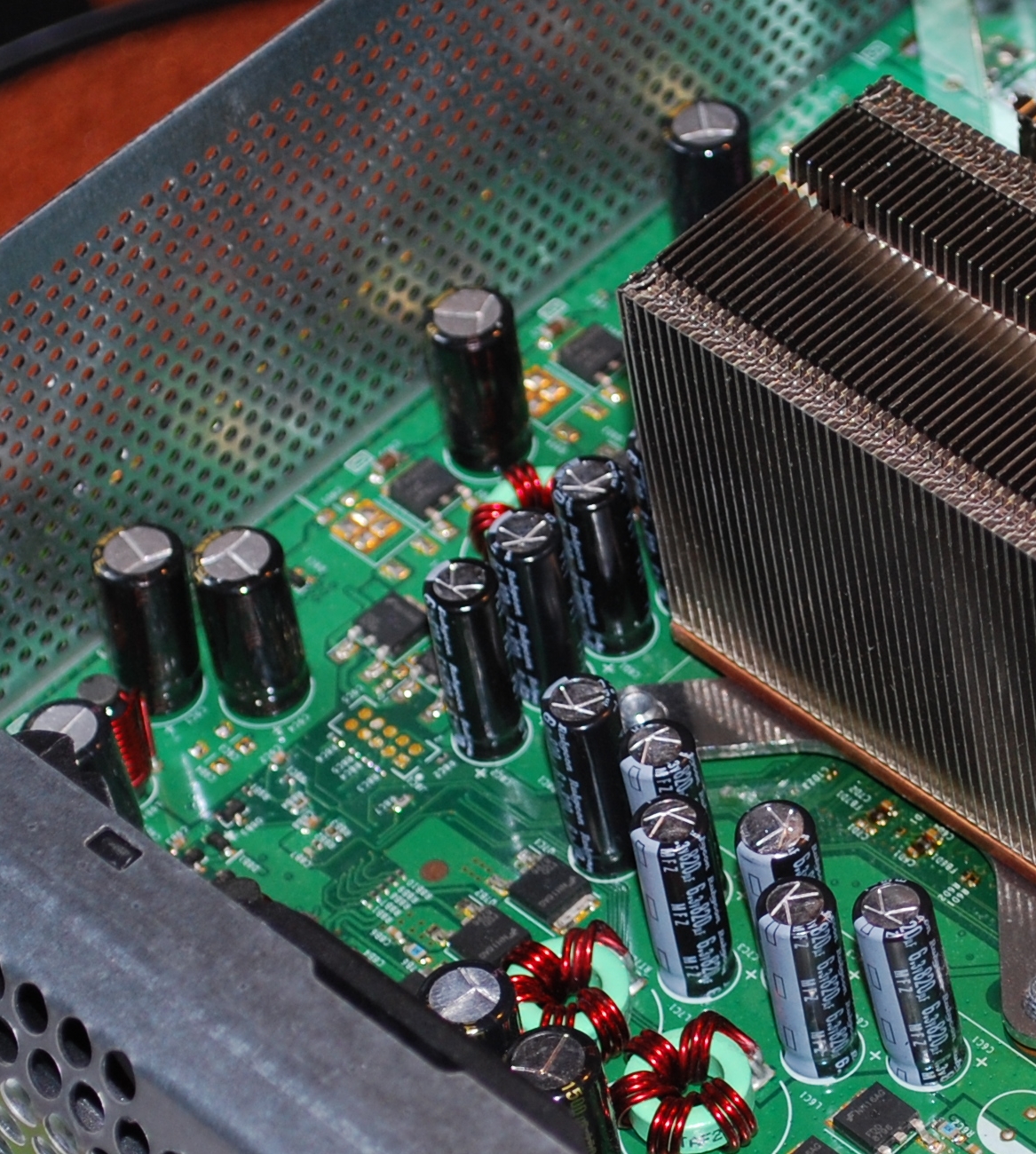

                  Pictures of the inside of my XBox 360 Arcade (HDMI)
                  http://img22.*************/img22/5944/xbox36005.jpg
                  http://img710.*************/img710/1035/xbox36004.jpg
                  http://img33.*************/img33/3185/xbox36003.jpg
                  http://img710.*************/img710/7986/xbox36002.jpg
                  http://img132.*************/img132/8949/xbox36001.jpg
                  If any of them have popped, I can't tell definitively.
                  The staggered row of six has the two "strongest" culprits. The tops felt like they have popped a little.
                  I'm planning to get the ESR-Micro capacitor meter. I'm just not sure whether to buy 3.1 or 4.0

                    • c_hegge
                      • Sep 2009
                      • 5219
                      Re: Identifying badcaps in a Xbox360
                      In the two last pics, all of the rubycon caps look like they are bulging. I would recommend poly-modding that unles you want the replacments to fail also.
