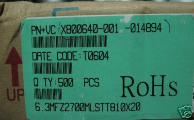

                                  #36
                                  Re: Identifying badcaps in a Xbox360
                                  good luck finding the rubycon caps.
                                  something extreme like MZZ arent they?
                                      Cheers,
                                      @stj
                                      It is a mix of Rubycon and nichicon capacitors. The Rubycons have MFZ on them. The nichicon doesnt list additional info except H0732
                                      @Per Hansson
                                      I plan to buy Rubycon MCZ 6.3v 820uF to replace the Rubycon MFZ 6.3v 820uF AND the Nichicon 6.3v 820uF capacitors.
                                      They are roughly the same dimensions to the current ones although the current caps are taller (both Rubycon and Nichicon caps are roughly 22mm tall and 7mm in diameter).
                                      I also plan to order the Rubycon MCZ 16v 1500uF to replace the current 16v 1500uF capacitor.
                                      The current one does not have a brand on it, the other details it says on it is 105 deg C FL and it has a logo of an M with a circle around it.
                                      The dimensions are again quite similar.
                                      Again I appreciate all the comments and info from you guys.
                                      Regards
                                        07 = year 2007
                                        32 = week 32
                                        My guess is they are HN or HZ series.
                                        Should be written on them somewhere. - If not they may be counterfeits.
                                        MCZ should be fine.
                                        The "M" = Matsushita = Panasonic
                                        The FL is the series.
                                        MCZ is fine for those too.
                                        I think MFZ are just a RoHs compliant replacement for MBZ and/or MCZ.
